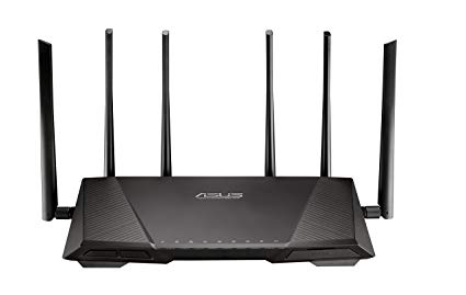

I'm using an ASUS RT-AC3200. Gigabit Ethernet and dual-band wireless (2.4/5).
