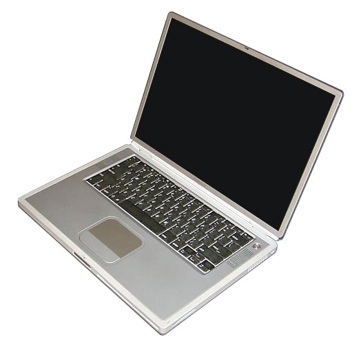

It depends on if it is an Aluminum or Titanium G4. A search at EveryMac.com will give yo the option of a teardown to show you how to replace the HD.
TEG

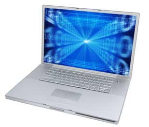

Titanium is the one with black keys, aluminum has silver keys.
