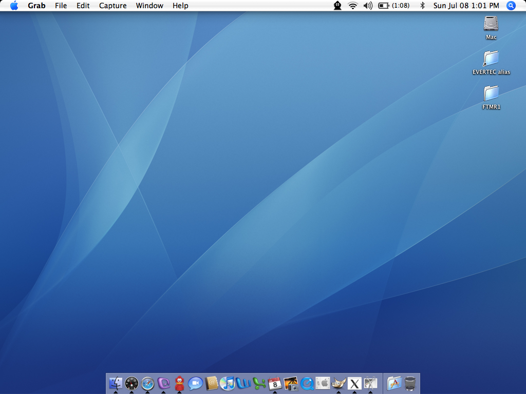

Ok...so my PowerBook G4 is having issues...it will not boot sometimes...gets all the way to the bluescreen right before ask to enter password...and it freezes...or sometimes it'll flash and turn black...the keyboard still works as i can push teh caps lock key and the back light is still on...
i've attached a screenshot of my desktop when i actually can log in which takes between 2 ~ 6 reboots...as you can see, there are pixelated vertical lines...not sure what is going on...
so, do you guys thinks its the graphics card, the motherboard, or maybe a clean instal of OS X...or something else?
let me know...thanx

It could be a number of things. Boot to the install disk that came with the computer. If the problem is gone, then it is most likely a software issue and an archive and install should fix it.
If the problem still happens when booting to the install disk, you can try resetting the PMU, PRAM and NVRAM. Run disk utility on your drive (booted to the OS Install disk), repair permissions....

I'd suspect something more physical here - looking at the image, it's got errors all over the blue-channel, but nothing in red or green - in fact most of the errors seem to be a single bit. If the memory were bad, this would be a slightly strange pattern to see, and I'd also expect worse symptoms, like bad crashes and more visible mistakes.*
I'm more inclined to think this is a loose/dry/cracked connection on the video output. Might be easily fixable, might e pretty fatal - by all means try software diagnostics though, you never know.

Yes, this problem is almost certainly restricted to the graphics system, and not your normal memory (though it wouldn't hurt to double check that your memory is seated properly - I think it it wasn't your machine wouldn't really boot at all...)
I took a further look at the image you posted. It's definitely only a single "bit" of error creeping in, and it's not on every pixel - in fact it's a fairly nice dither pattern of error over the screen. That kind of problem is fairly typical of bad memory, so scrub what I suggested about it being a loose connection.
Fixing it would be nasty though - laptops don't really have graphics cards as such, the components will be mounted straight on the motherboard. Generally speaking you'd have to swap the whole lot out. I assume that's what an Apple place would do, assuming spares are available.
Otheriwse you'd want someone who knows what they're doing to take the machine apart and look for anything obvious - could be a bad solder joint to a single memory chip (might explain the pattern of errors), which would be fixable. If there's nothing "easy" like that, you're probably out of luck. Replacing the chips themselves is possible but not for the faint-hearted. A hairline crack on the board is probably fatal.

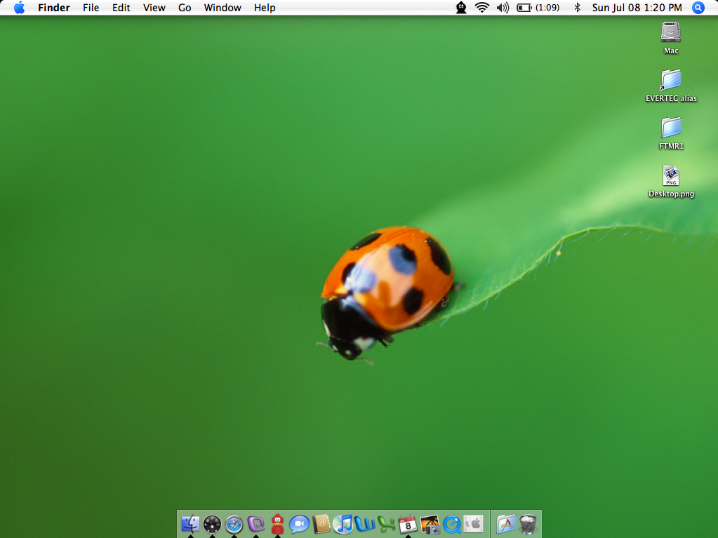

Fixed
Just an update in case this happens to someone else.

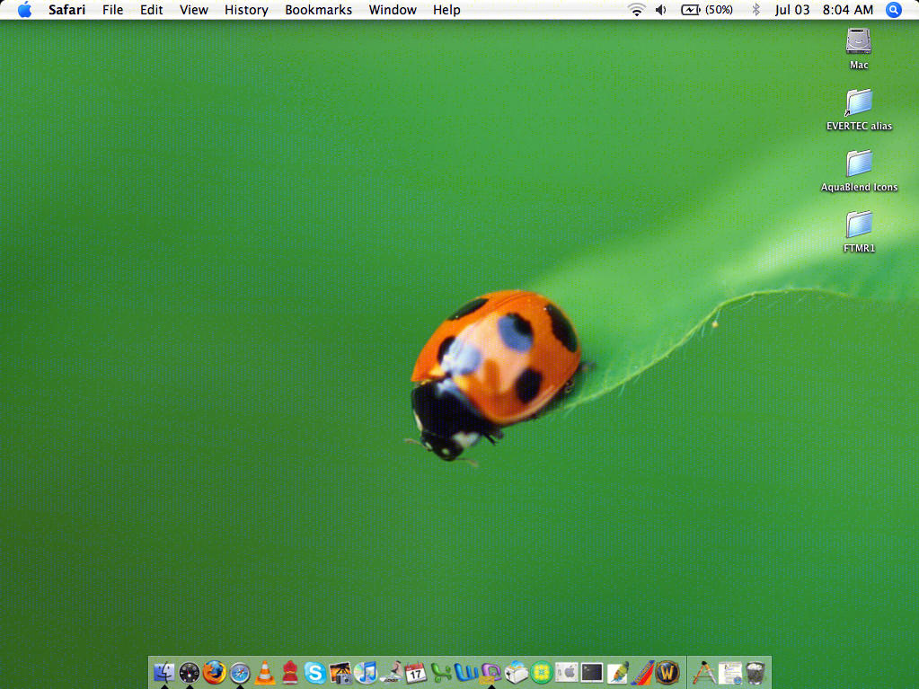

I reinstalled OS X. I had tons of problems...the graphics through the whole install spazzed out...but eventually after numerous restarts i finished the install...My computer rebooted and poof...computer fixed...problem solved. As you can see from my new desktop screenshot. Definitely a bizarre thing, but whatever!
this is better screenshot...same background as before

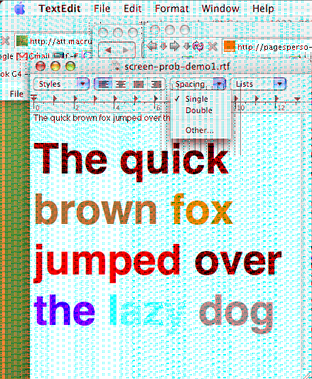

Hi folks. I came across this old thread looking for a solution to a problem I have at the moment with my G4 PB 1.25GHz. I am getting some funky graphics errors. The colours of certain pixels seem to be getting mixed up in a fairly regular pattern.
If I apply pressure to the casing in certain places I can sometimes get it to work correctly again, leading me to suppose that there's a loose connection somewhere. I have also concluded that the problem can't be in the screen and must be within the graphics system for the following reasons: if I zoom using cmd-alt-f8, the glitch zooms with it (with similar static glitches superposed); If I take screenshots using the Grab utility, the problem doesn't appear in the output, however if I plug in an external monitor or connect to my computer remotely using VNC, the problem is there (the attached screen shot was taken using VNC (chicken of the...) from a remote machine); vector graphics in my sheet music editing program display some very strange anomalies as if the vector data were corrupted before being rendered.
Apart from these visual problems the computer works perfectly normally, despite having slightly bent corners thanks to some basic flight training! In this respect, my problem differs a little from that of the original poster. The problems began one day after carrying the computer in a bag and it may have received shocks or stress on the casing.
I'm new here obviously so sorry if I haven't followed forum protocol in any way. I'd be very grateful for any thoughts or advice that any one may have. It's been a very long time since I reinstalled so that would obviously be worth a shot.

Hi there, me again. I ran the apple hardware test CD that came with my Powerbook. It's the same one as yours by the looks of things. I got an error code for my graphics card and I don't have it to hand I'm afraid. I searched for the error code and found a number of threads that say that the graphics card is basically malfunctioning and only a motherboard replacement will cure it. This is about the most expensive component of the Mac so it's not good news. You should probably prepare yourself psychologically.
Try and find the Apple hardware test CD (and software restore or something like that) that came with your PB and see if you can find that error code on google (I think I remember it having 103, xxx and ati in it).
