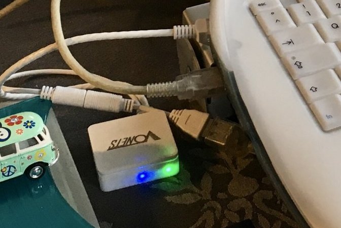

A simple 15 bucks Vonets WLAN-To-Ethernet-bridge dongle could do fine too.
And it's quite versatile.
(I'm grateful to this clever hint, that I've go in the PPC-subforum, while looking for a wireless-solution for an os9 device)
PS: you can't have enough of them ... e.g. when kids have guests at home it's feels more comfortable to deploy Vonets, than to share WLAN-credentials.
