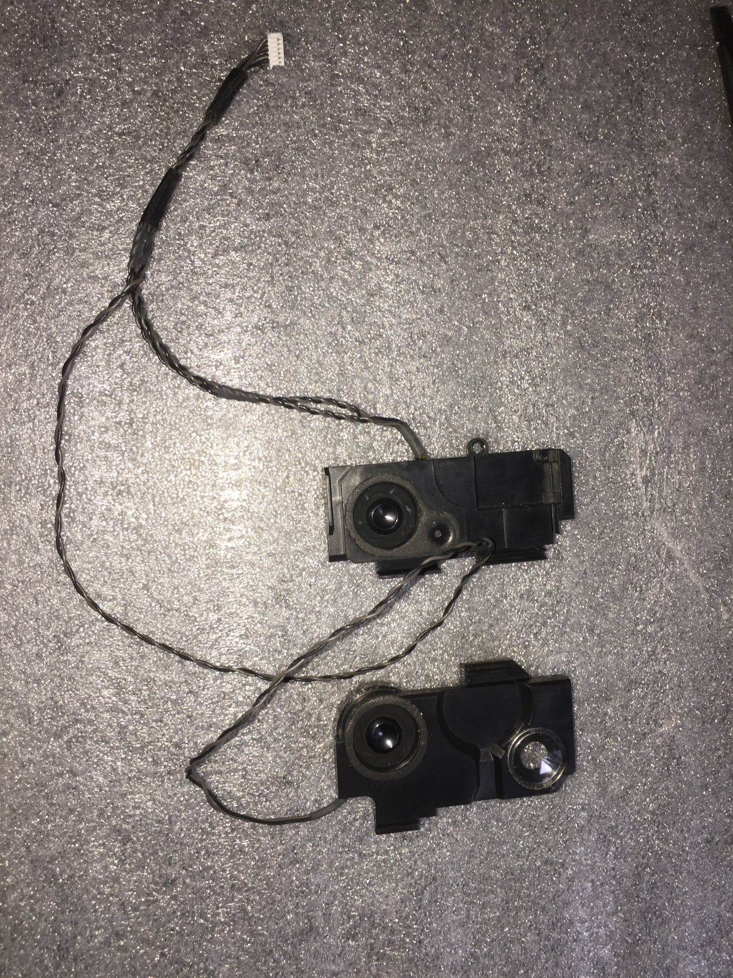

Got a powerbook g4 17" 1.5ghz with no sound. Ive tried all that pram vram stuff, reinstalled os, checked all internal flex cables/ lines, its says internal speaker in settings. Headphones work with no issues. Everything seems to be right but it just doesn't work.
Any help appreciated (yes it has been a year since I last posted about this and I haven't figured it out)
Edit: Ive also tried pushing on solder points while playing audio and that didn't do anything.

I have two 1.67GHz PowerBook G4 17-inch (SLSD). One with no sound from either speaker and the other with left channel sound only. Just like yours the audio is fine with headphones and is reported OK in System Profiler.
I dismantled both units and swapped speaker kits between them to determine if it was the speakers or logic board at fault and the behavior carried across with the specific speakers.
It looks like the speakers have failed in some manner. They look fine with no physical wear, but just don’t produce any sound. Maybe there is a tiny fuse or resistor inside the individual speaker housings which has failed.
I didn’t venture any further and concluded that I would need to replace the speaker kits.

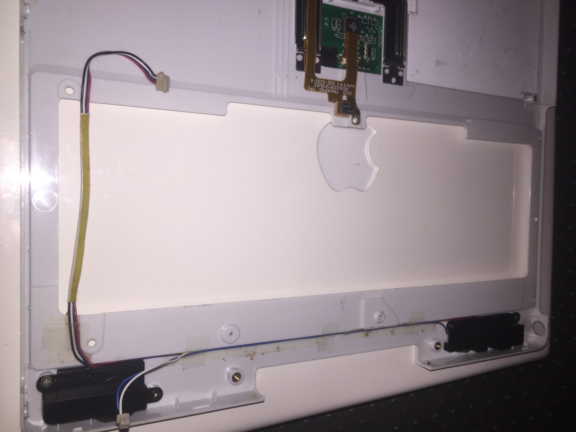

Thanks for the response, I have an ibook g4 1.33ghz that I don't mind taking parts out of. Does anyone know if they have the same speaker assembly?
It’s a good thought, but they are very different.

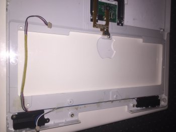

The iBook G4 speakers shown here installed in the white top case use a four pin connector, whereas the speaker kit from the PB 17” uses a six pin connector. Your best bet would be to get the part from powerbookmedic.com, thebookyard.com, eBay or some other 2nd hand parts dealer.

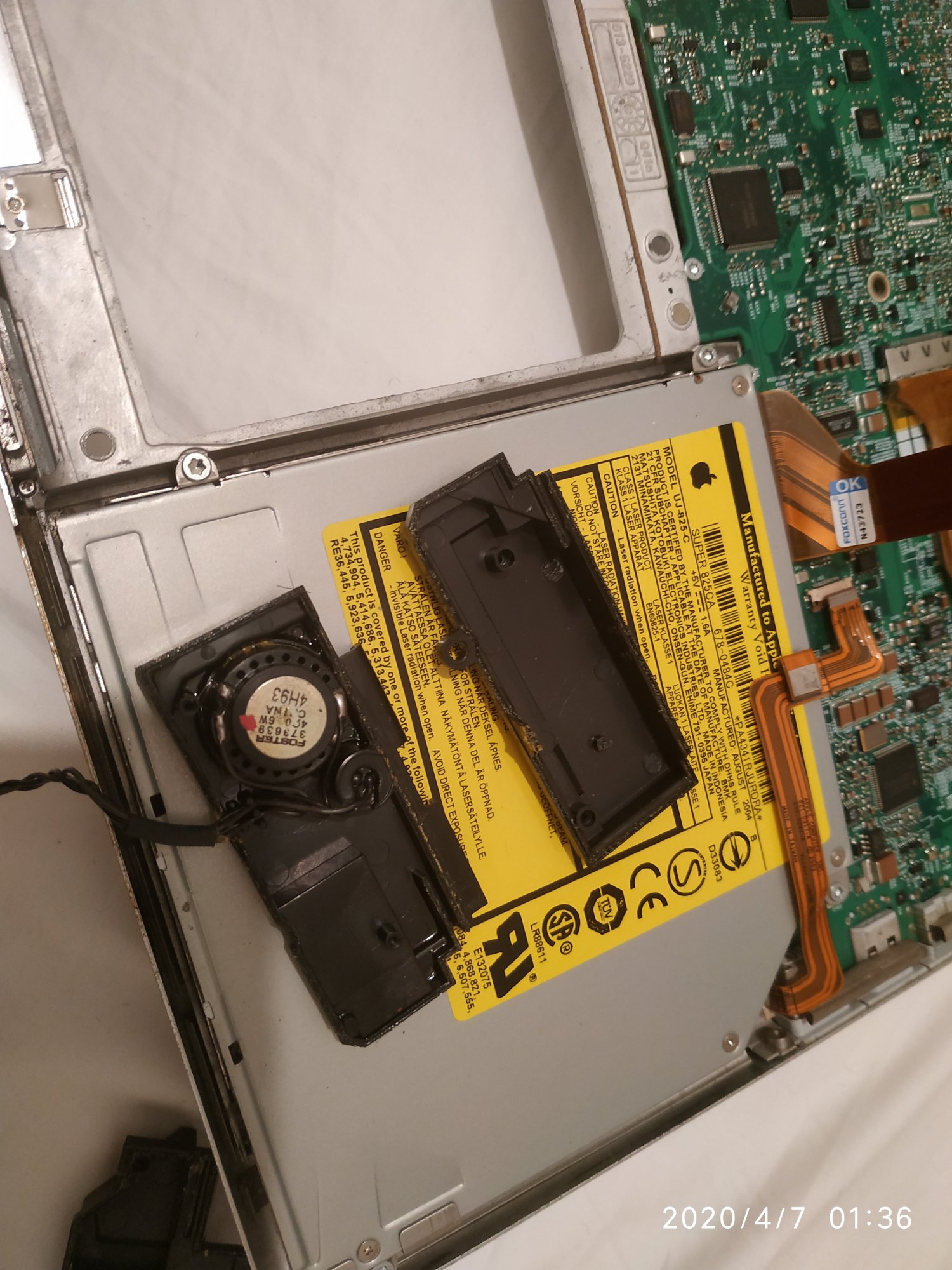

Yes but then I had a different thought, the powerbook g4 speakers unscrew to this:
Maybe the inside of the ibook speakers are the same and I can simply solder them in?
Edit: Also I don't really want to spend money on this thing
I've disassembled two Power Mac G4 speakers, and they all use the same basic assembly. Those speakers are glued, not soldered - no soldering is ever necessary. You will need to carefully get them out of the PowerBook's enclosure without tearing the cone, then transplant them into the iBooks assembly in a similar way; if that's what you plan to do.

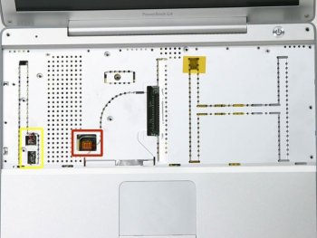

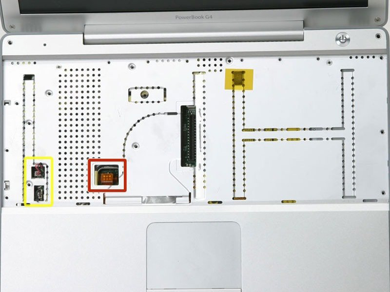

The one part of working in the 12" that always induces panic for me is getting that connector off the logic board through that tiny rectangle in the top case. The first time I did it was nerve-racking because that connector was tight.
Bottom left is what I mean.

Nonetheless, I suppose the iBook just struck me as the more difficult laptop when I had it beside the PowerBook. The latter's top cover's thin aluminum frame would often inconveniently bend in or out, yes, but I would usually just push it back. As for the little logic board connector, you just have to use the end of a pair of needlenose pliers to pull the very top piece straight out.

Alright so it turns out it was the speaker itself (surprisingly) I am now in the process of swapping the ibook speakers over to the powerbook casing
