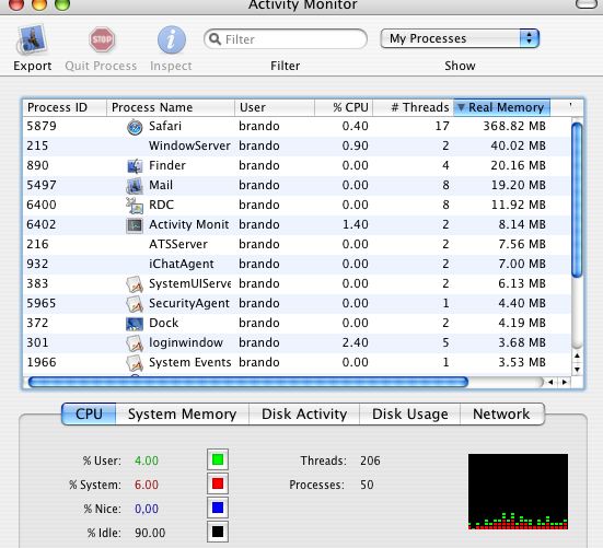

Sounds like it. Mirror agent has the most threads at 48, but I don't even have that Kernel thing. You have a run away program.
EDIT: There it is under all processes, yep, got about the same as you.

Cypher3 said:
Kernel_Task uses the most, using 63 mb of ram and has 40 threads. Is that normal?
That sounds normal to me. I Have it use a bit more than that and I don't experience the problems you have stated. 🙂
Oh ok. Thanks. Just one more thing, I have 3.10 Gb of Virtual Memory and that kernal_task is using 900+ MB of Virtual Memory, not to mention all of my other programs are using a lot as well. Is that normal? If not how can I lower it? That could have something to do with low battery life as well right?
