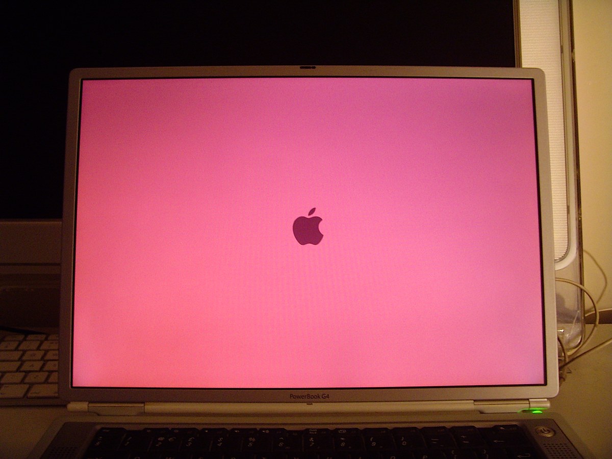

Sigh...my much anticipated 1Ghz Titanium arrived with a headache...when it boots the screen is a blushing pink.
Within a minute it fades back to the normal healthy colour - I haven't tried starting with an external monitor yet but is this normally a LCD or GPU issue?
LCD. I've had a Pismo and a Clamshell that did the same. Replacing the screens fixed both.
Thanks. Does it get progressively worse do you know? Is it thermal related - when I turned it on after delivery the screen was blood red but now at room temp only pink?
Not sure. I never let it go long enough to see if it did get worse. I would assume, based on usage, that it will probably get worse.
It appears the green gun in the screen is going out 😀

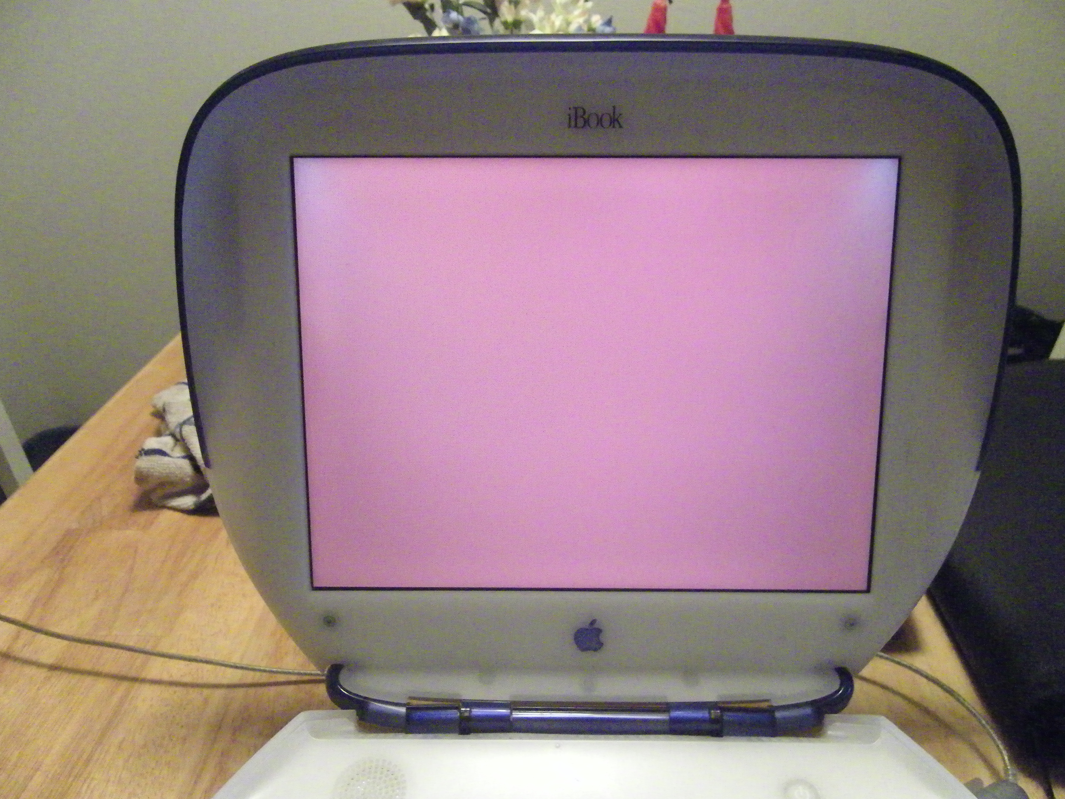

I purchased a G3 Pismo a short while back as a spares unit; seemed a good deal as it was in it's original box with all documentation. It was being sold 'as is', and on arrival I found the screen similar to the one you describe - perhaps a liitle less pink, but a certain colourful panther - dum-dum-da-dum - would certainly have got lost in the background 😉. The blushing pink diminishes in density after 3-4 min, and screen becomes fairly useable.

It's the back-light slow death. But it can be really slow, and still be useable for long. Have a Pismo like that since years, the time for the screen to get normal takes just the time for boot to finish.
Never noticed changes, but i suppose some day the back-light will completely fail.
I have such a beast as well. Starts off with a pink cast but after a few minutes the discolouring goes. I just regard it as part of the boot sequence.

My 667 Ti is pink when it wakes up the screen too. Old bulbs with lots of hours on them, but it hasn't gotten any worse in the 8 or so years I've had the machine.

As said above, the backlight is dying. They tend to go pink or orange when they've got lots of hours on them. New screen time.

Time to dish out some Light bulb knowledge 🙂
the pink colour is caused because the CCFL tubes in the LCD screen are whats called mercury starved, basically the very small amount of mercury contained in them has been absorbed into the components of the lamp (components like the phosphor and or electrodes) starving the main discharge of mercury and causing only the Argon/krypton/neon buffer gas to be ionised and when combined with the phosphor you get the pink hue you see
its quite common to see it on fluorescent tubes too especially modern ones which have not as much mercury as older ones, (in the US, Philips Alto Tubes are especially known for going mercury starved)
one of the things we lighting collectors do to "fix" tubes that have gone mercury starved like this is to bake/heat the tube, usually in an oven to drive the mercury back out from the components of the tube. but in the case of a LCD it would require a complete teardown of the LCD to get to the CCFL tubes and some times the fix is only temporary...
its also worth just letting the screen run at full brightness for a while
tubes which have not been used in many years can go mercury starved temporally that will clear up once ran for a while
