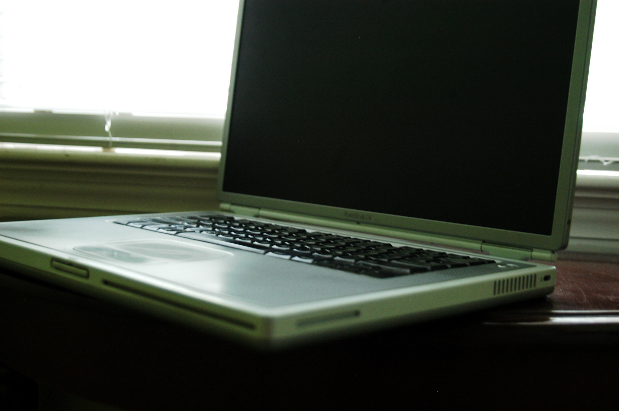

Since I am having multiple issues with my Titanium (none that are inhibiting proper usage thank goodness), I decided to make a single thread instead of multiple other ones.
1. AirPort won't connect to my network even when the network is set to WPA (TKIP) with B/G/N networking.
2. Right Speaker won't work.
3. The screen latch doesn't 'catch'
4. The battery either doesn't come out without considerable force or it falls out easily.
5.The Option key broke off (Ordered a new one from PowerBookMedic).
6. It doesn't have a proper name, I need suggestions.
Other people can hop in with their problems and see if we can resolve them together!
Is the right speaker hardware or software? Have you tried going into System Prefs -> Sound -> Output and changing the balance to the middle?
Sometimes older Airport B devices won't connect to a network if it is in B/G/N mode. Try changing it to only be B/G mode.
I only have the option for g/n on my router. Gonna hook up an extra one for my bedroom lol. Arg.
yes, I have.
Have you tried setting it to full volume and in System Preferences all the way to the right? If it is completely silent then you may have a problem in the speaker wire. If it is extremely low then the speaker is probably blown.
Ok, good idea.
The battery latch is a part of the inner framework. Does the lid catch come out when it is closed?
So it doesn't appear to get caught by the palmrest then?
No, it doesn't appear to. Another note on the speaker, I don't have the guts to continue to disassemble my powerbook since I partially broke the CPU fan clip, I was able to get it back in and glue it together, so the speaker will still be broken.
Also, he has a name! Alfred the Jukebox. He sits atop my nightstand playing Spotify. Also, can anyone else control Spotify with AppleScript?
