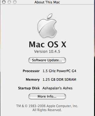

Well, the memory arrived 20 minutes ago (10 am) which really speaks a lot for Offtek memory, cheapest price and got it too me the next day.
The procedure went well, I got a bit nervous around the '30 degree' angle bit but did my best and now...
Im still nervous its going to blow up in some kind of way, but my fingers are crossed.
I am curious about the stickers on the ram chips, are they okay to be left on? I know that area can get a little hot?
All in all things seem (so far) to have gone well, so thanks for the tips and i'll be off now to enjoy the new breathing room.
