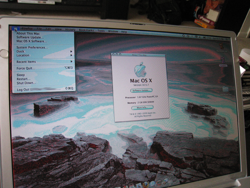

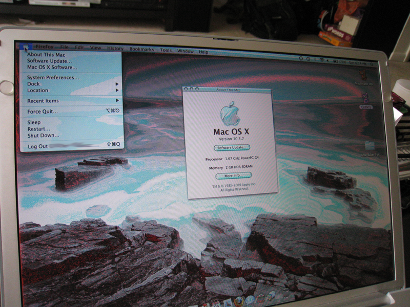

Wondering if replacing LVDS cable could save us here... Any experts chime in?

Thanks, but nope. This is hardware. Definitely not software. It happens from the moment you boot the computer, the gray screen at the beginning is cyan.
That does look like a color setting. I thought at first it might be the red having gone out on either the graphic chip or the panel, but there's definitely some orange and red in the dock, and pink in the wallpaper.
I was gonna post that your screen was screwed up at the top left, then I realised you blurred out your name 😛.
as I said, when the computer initially boots, the screen with the apple that is usually gray is cyan. This would rule out any color setting issue as color settings take place within the OS and not at POST.
Hmm... I admit, that issue doesn't look particularly like a bad cable to me. At least, none of the cable-related problems I've personally seen.
Seems more likely it's either the chip itself or the panel itself that's acting up, since that could produce a less drastic color tweak like you're seeing there.
Question: Did you try running the Hardware Test disc to see if maybe it sees something? If it's the graphics chip/VRAM I'd expect that to find the problem. If it doesn't then it's more likely to be either the cable or the panel.
Short of cracking it open and fiddling with the cable physically, I can't think of any good way to confirm whether it's the cable or something else, though.
