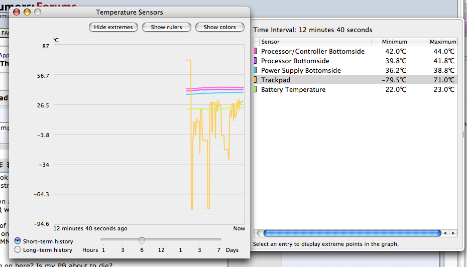

My powerbook (1.5GHz, OSX 10.4.8) has just unexpectedly gone to sleep twice (once straight after waking) while browsing the internet using Safari.
I shut it down and rebooted it, and upon startup, I noticed the temperature for my trackpad was doing very strange things - see attachment.
At the time of the sleepings, I was using my Bluetooth Mighty Mouse. It seemed the only way I could stop it from sleeping as soon as waking was to turn off the MM.
The trackpad does not feel hot or anything to the touch and all other temp sensors are normal
What's going on here? Is my PB about to die?

Very likely sensors on the topcase are going nuts, I've seen it a fair number of times on powerbooks reporting sleep issues. As it is not likely your powerbook is dying, I would bring it in to the GeniusBar, or call AppleCare. Topcase replacement will solve your issues.

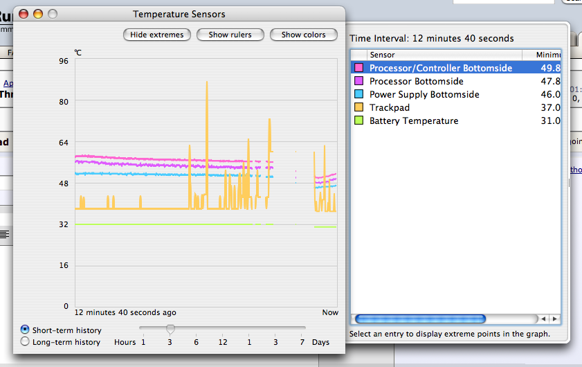

Happened again just now. Had been using the comptuer for about 2 hours, with my BT Mighty Mouse plugged in. After the fans having been on for about 15mins (ran a bit hot while using safari - perfectly normal for what I was doing though), the laptop suddenly went to sleep and wouldn't wake up and stay awake until i'd "fanned" the case to cool it down.
My guess is that the trackpad temperature sensor is on the blink. See the temperature monitor window attached. It was claiming about 60C just before sleeping (the first big gap), but the trackpad felt no hotter than it usually does. Incidentally, according to Temp Monitor, the specified upper limit for the trackpad is 48C
Is there anything I can do to stop this happening? I can't take my computer in to repair until the easter holidays, which are over a month away.
Additional note: The Mighty Mouse probably isn't causing it - it slept while typing this post, registering a spike of +90C and then -125C for the trackpad, without BT or the Mighty Mouse on
