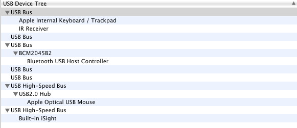

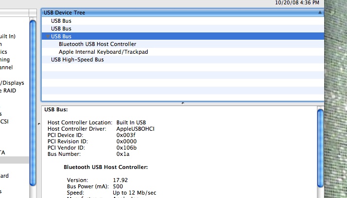

Thank you for the reply toolbox! This is what I have on the System Profiler
I'm not really sure if it is showing 😕
What should I do? Should I just completely erase and restore the OS? Or are there any more methods to fix this?
Well it appears it's finding the USB controllers.
