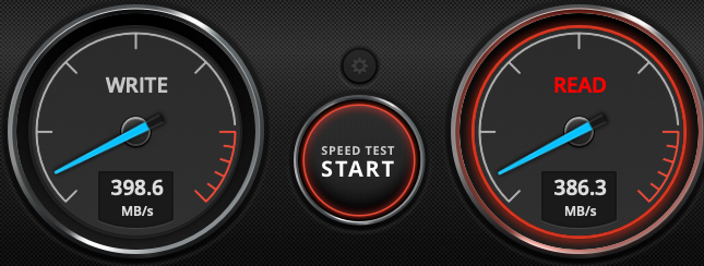

Suggestion: run the Black Magic Speed Test and tell us what read/write speeds you get for your external drives. This may give you some idea how your current performance compares to what your external drives are capable of.

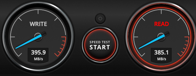

Note: there's a fast way to see if a faster connection can do you much good. Your M2 Mac Mini has Thunderbolt 4 ports. I think those should handle much faster data throughput than your external SSD drives are capable of. Hook your SSD drives directly the the Mini's Thunderbolt 4 ports and run the Black Magic Speed Test, and compare to the Read/Write scores you got hooking to your monitor.
I doubt that HUB you're looking at is going to provide faster speeds than your Mini's internal Thunderbolt 4 ports, or that the external SSD drives you're using now can saturate either.
Great idea about using the Black Magic Speed Test drrich2
This is from the Dell Monitor
This is from the Mac Mini M2
Was not expecting this...
Sparky
Then it's a question of where's the bottle neck in performance. If your M2 Mac Mini's Thunderbolt 4 connection didn't give an increase in speed, then the receiving end isn't the bottleneck, and I don't think the hub is going to help you with your current setup, or that your Dell monitor's hub functionality is limiting you.
