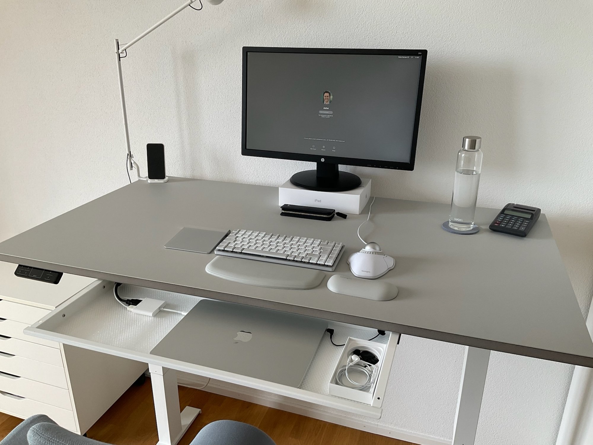

My current M2 Air setup looks similar to the photo I shot a few months ago. The Air connects to monitor + several peripherals with one cable. Gives you best of both world. No duplication of updates and settings but all combined in one powerful setup.
If you feel at some point that you are running out of processing power, RAM, or SSD, there is always only one machine to upgrade/ replace.

Since you decided to go with the laptop-as-replacement-desktop option, here's a couple of suggestions:
1) You could buy a vertical docking station and use it in clamshell mode. Clamshell is not my preferred option, but some like it--and I have to say that @rocketbuc 's motorized standing desk clamshell setup looks pretty slick.
