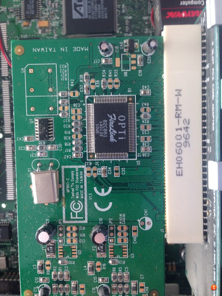

Not entirely sure, I have it loaded in the powermac already. If it helps I got it out of a desktop powermac g3
Can't be 100% sure, I got it from a mac that was pretty junked out but the card looked like it was in good condition
Take the card out and look at the biggest chip on it. That should tell you what chipset it is by looking at the manufacturer of it.

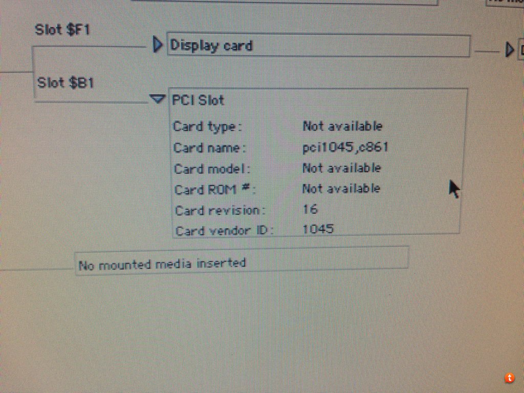

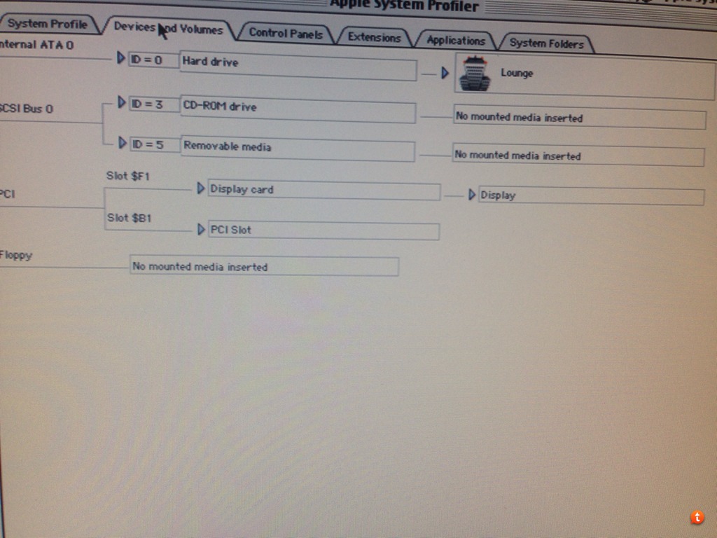

Rechecked the system profiler here is what it finds

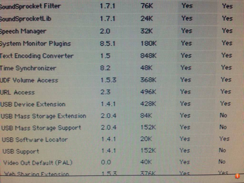

Looked deeper and it says the extensions are disabled, any idea how to enable them?
Duh! Extensions manager! Mouse just turned on and everything seems to work, thanks!
