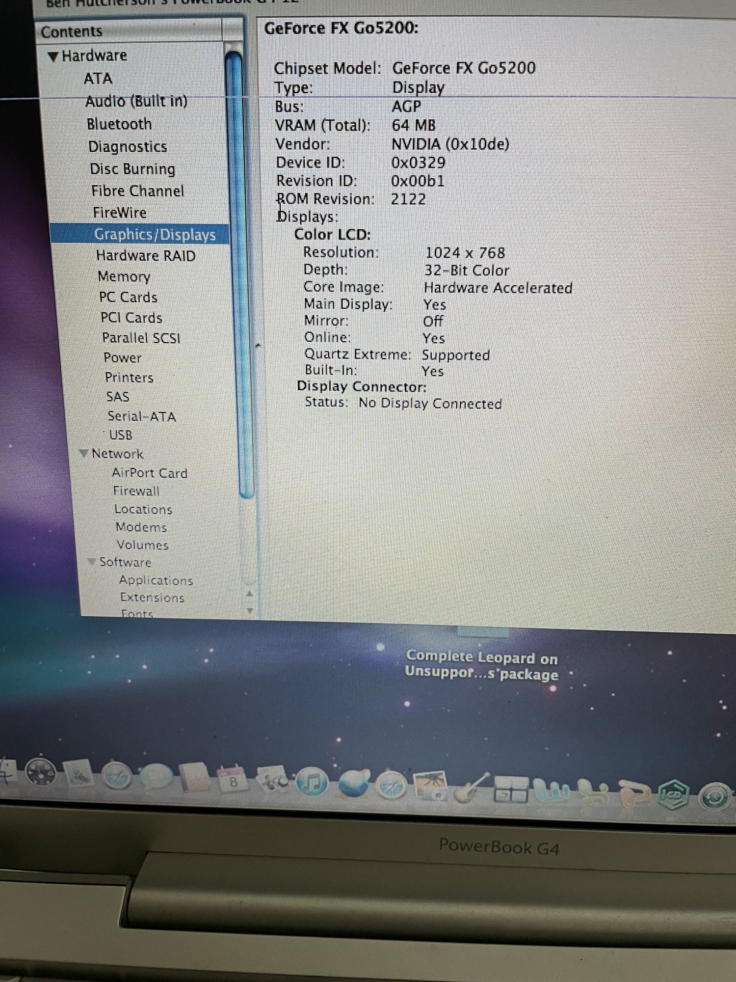

The FX5200 very much supports CI. It's not a particularly good CI card(enough that, IIRC, Leopard disables some of the animations by default with it), but it does support it.
I remember not having to manually enable it on PCI NWR Macs-it just worked when I stuck a flashed 5200 in a Yikes!

The 5200 IS a weak enough CI card that transparency and some other stuff gets turned off.
None the less, CI is an instruction set and the 5200 supports that instruction set. There are better GPUs than the 5200 that do not support CI.
Fundamentally, it's no different from Leopard not running on a G3 or Sierra not running on CPUs without SSE 4.1. I have G3s that are "faster" CPUs than what's in a Sawtooth(which can run Leopard as long as you bypass the installer) including the ones Apple put in the late iBook G3s and the 1ghz G3 I have in one of my B&Ws. They run non-Altivec tasks faster than a Sawtooth ever will, but do not run retail release builds of Leopard.

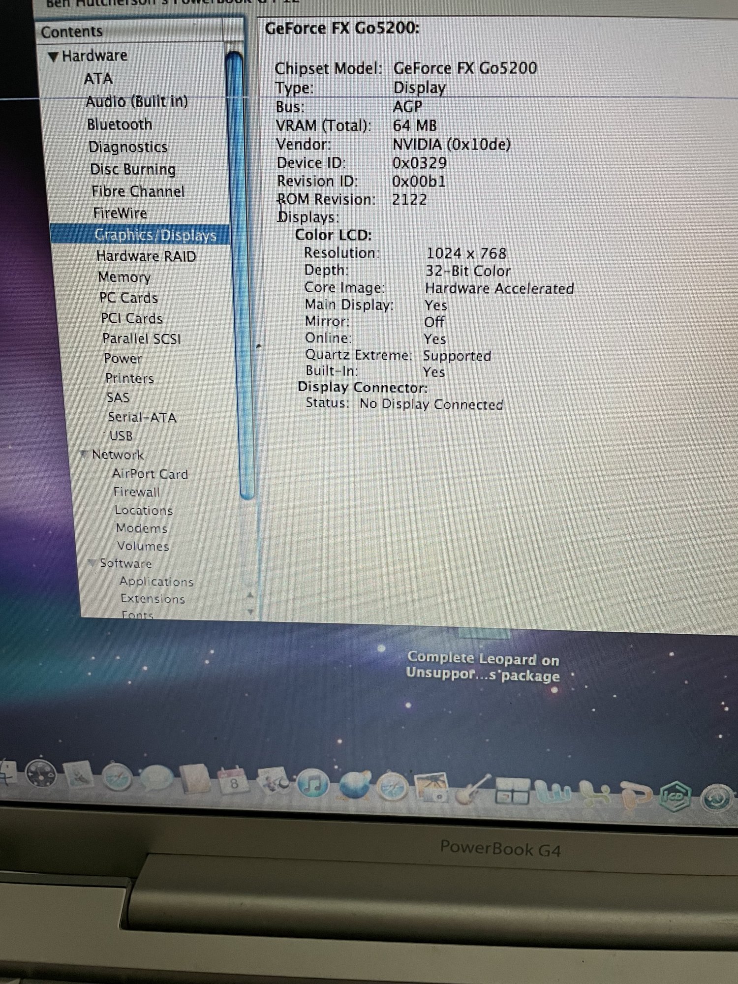

Here's my 12" PowerBook, which I had handy. Notice under CI it says "Hardware Accelerated", which means "Supported". A non-CI GPU will say "Software" in System Profiler.
Thank you for providing this breakdown of explanation. I didn’t know this before and this is quite helpful, especially as it relates to the Clouded Leopard project.
EDIT:

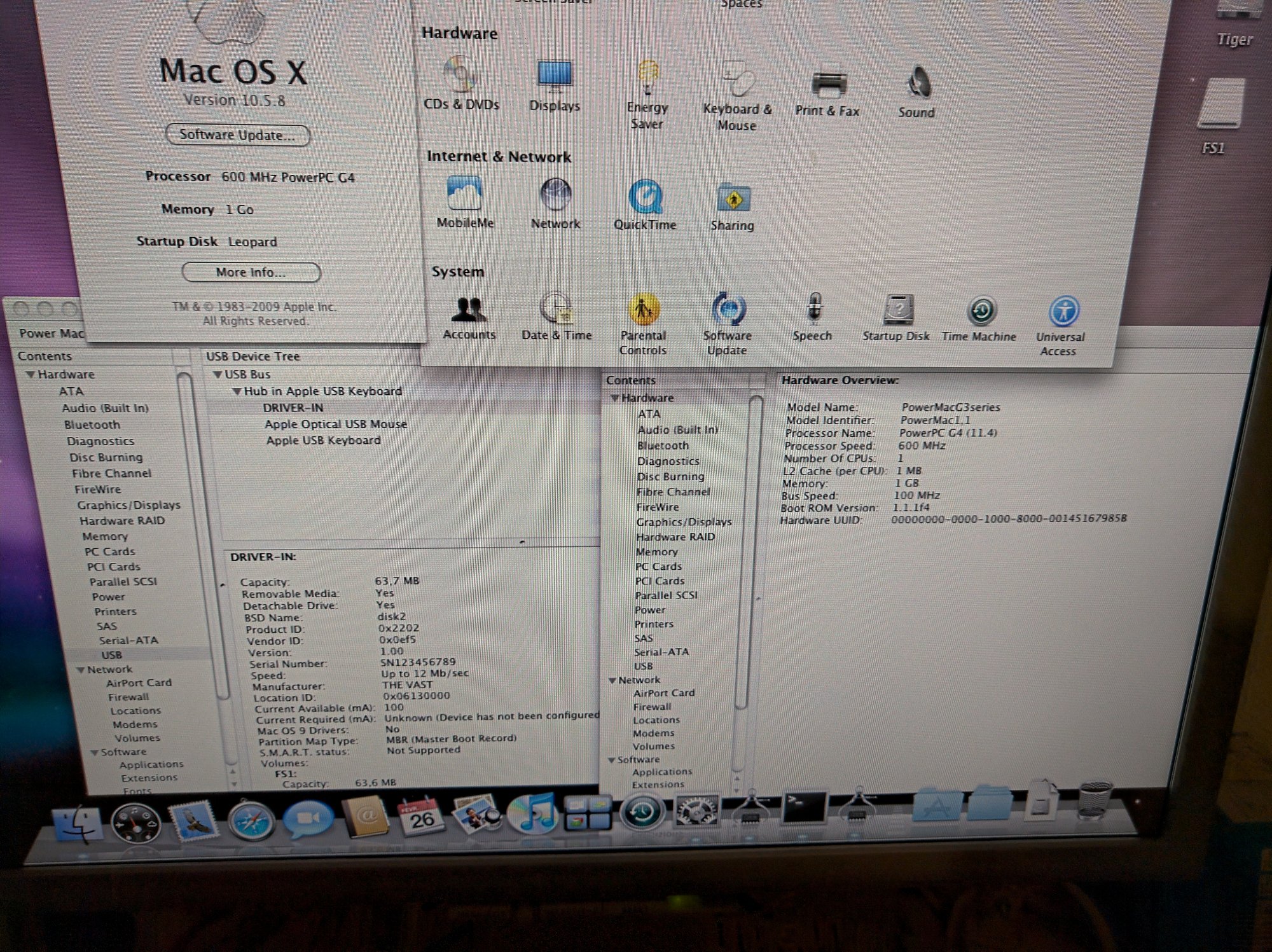

I have an OWC G4 ZIF rated at 550 MHz (xpc7410rx550pe) that I had been using in a Beige G3 at 533 MHz on the 66 Mhz bus (8x multiplier). It ran flawlessly (except perhaps that I couldn't update to 10.4.11 due to CPUDirector not being supported).
However, when migrating it to the B&W (firmware G4-unlocked), I first started at 550 MHz on the 100 MHz bus and although the system boots up, there are several graphical artefacts (missing text, corrupted images) both on Tiger and OS9, and the system invariably hangs within minutes after reaching the desktop. I first thought of the cache speed which I reduced from 1:2 to 1:3 but to no avail. I now run it at 500 MHz on the B&W with 100 MHz bus speed (5x) with the cache at 1:2 speed and it runs flawlessly.
I am cooling it with a socket 7 heatsink and fan and it does not seem to get hot.
My question is: I have previously read somewhere - but cannot find it again for the life of me - that original G4 chips (7400s and 7410s) are prone to glitches at high speed at low temperature on these machines and that this bug is known and documented and even has a name - the errata bug.
Does this ring any bells? I also recently elsewhere read that this is due to a glitch with the XPC107 controller and one of the reasons why Apple subsequently went for 744X/745X. Is this glitch frequency or multiplier-based?
Do you think that there is any possibility to run this chip at its intended speed (550 MHz)? I could also try changing the FSB to 120 MHz x4.5 to run it at 540 MHz or 133 MHz x4 to 533 MHz (the latter by clipping R811 off of the backside of the mobo), however I have read that the latter is quite unstable (https://www.applefritter.com/node/4289), even though it should be possible on the 7410 side as it supports 133 MHz FSB

So it turns out it simply was a matter of cache speed. For some reason the cache ratio keeps at 1:2.5 regardless of CPU speed on the B&W but not on the beige where defaulted to 200MHz cache speed even at 533MHz, however at 550 and 600MHz on the B&W this went up to 220MHz and up, I set it back to 200MHz (default cache speed at 500MHz) and voila, I have a stable B&W G4 happily running at 600MHz :) But shouldnt' this part be able to do 250MHz Cache speed? It clearly defaults to 200 MHz on both OS9 and OSX though, it's an OWC Mercury G4 ZIF 550MHz.
For some reason I do have to set it manually with L2CacheConfig once OSX is loaded (either Leopard or Tiger), even though L2CacheConfig is in StartupItems, I might just put it as a cron job when OSX loads if I can't get it to load automatically on startup. If I don't set it manually I get random errors or crashes, which disappear as soon as the cache is set to 200MHz

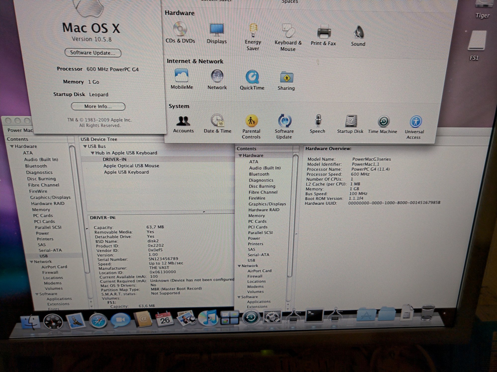

So for those of you who want USB AND USB mass storage working on the B&W with 10.5.8, you need to copy IOUSBFamily.kext AND IOUSBMassStorageClass.kext from WWDC2006 to /S/L/E and do the usual kext cache cleaning
WWDC2006 USB Kexts are attached
