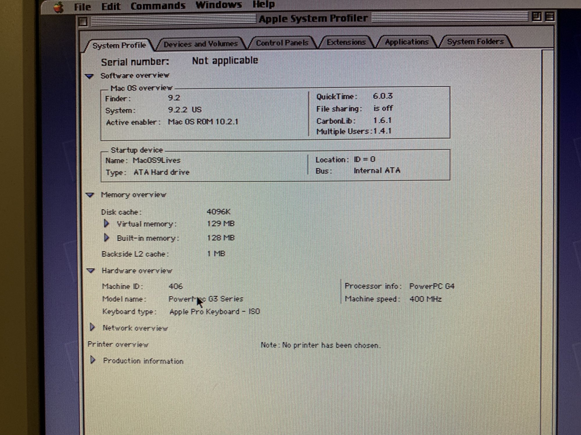

I flashed this PowerMac G3 B&W and it's rock solid with OS X 10.4 but I cannot get to boot off Mac OS Classics versions. I tried from 8.6 to 9.2.2 and it stalls with a grey screen. I removed all drives and PCI cards, put back the G3 processor but it can only boot from OS X, so its not a matter of IDE/master/slave thing. I tried also to boot of an HD where I had installed an universal version of 9.2.2 and it stalls at the grey screeen.

Removed everything, CD, ZIP, replaced CD drive, removed all Ram sticks except one, moved the video card to the farthest slot, installed a new HD: bingo!
Don’t ask me what was the cause! I went the straight way:
