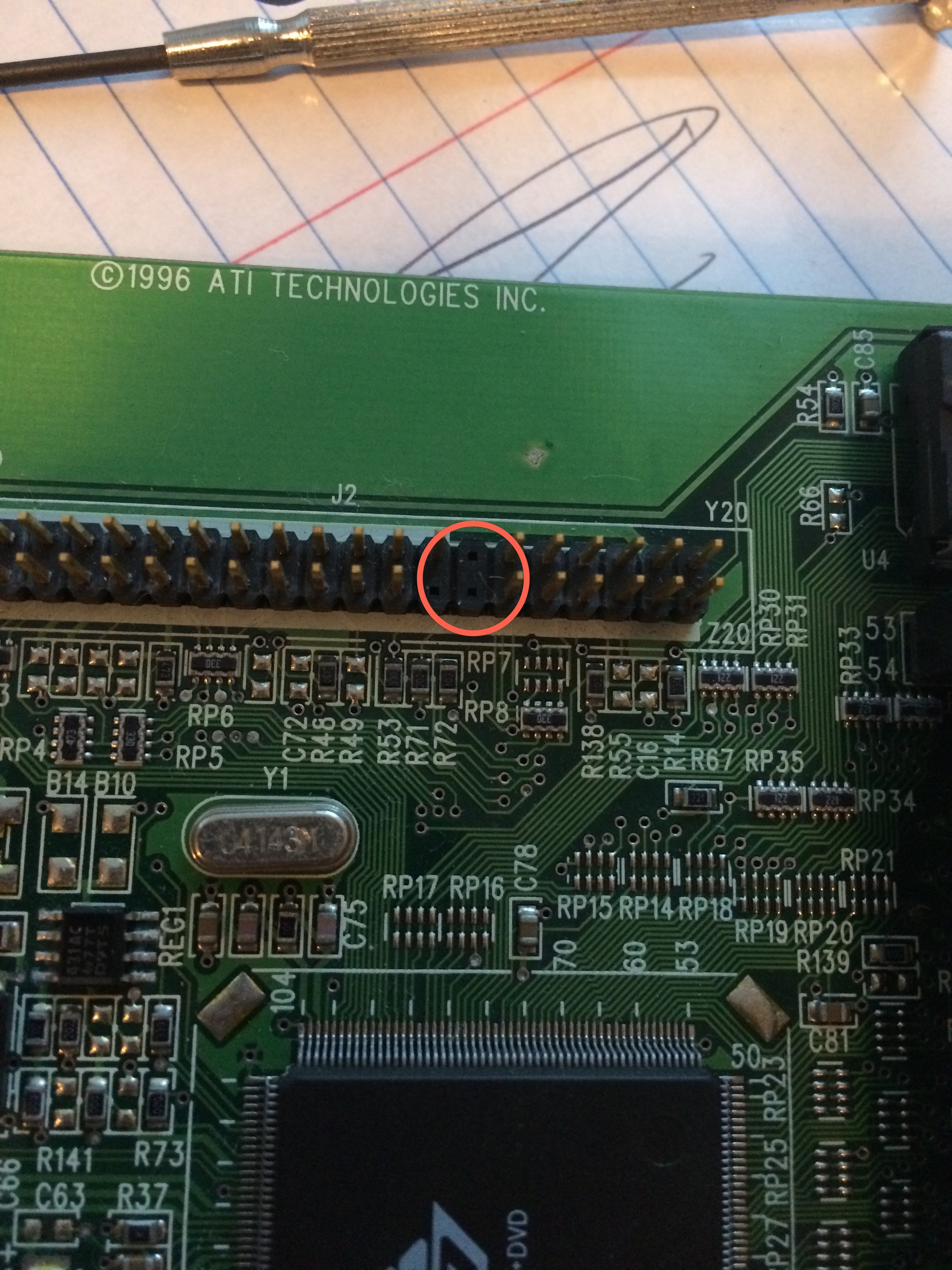

I just got a B&W PowerMac G3 and when I booted it up it chimed but did not show any video. I think it's because of my graphics card. Some of the pins were bent. I need to buy a new one. Anyone have any suggestions for a graphics card I can put in there. I will be running Tiger and I don't want the card to be too expensive.

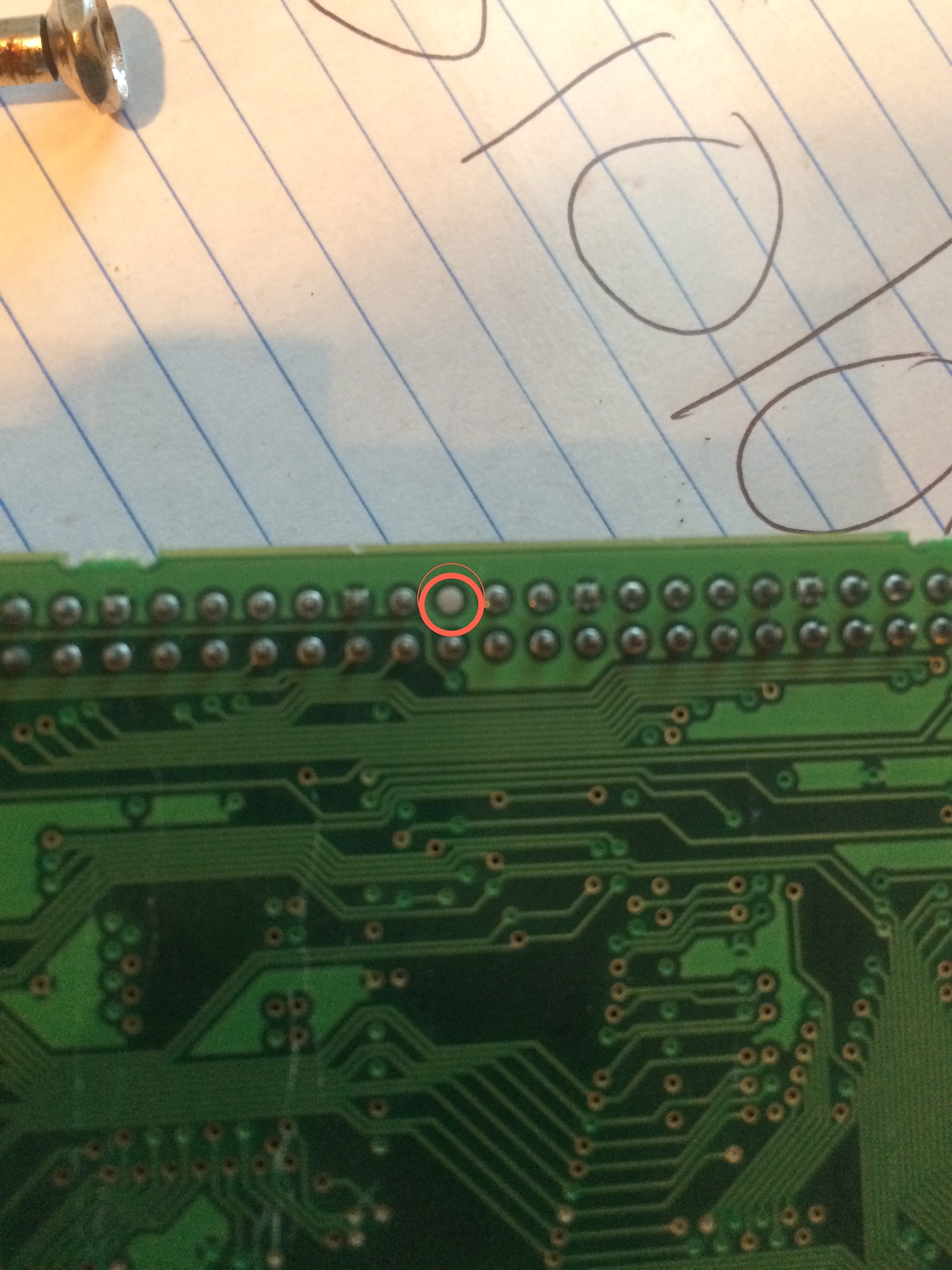

all in all if you want a nice OOB experience with the most OS support I would highly recommend a Radeon 9200 Mac edition (also have you checked the RAM on the BW G3? I found mine being a Rev A machine is VERY touchy when it comes to wanting to POST properly and usually ill just have to move the ram sticks around and then ill get a picture, also as long as none of the pins on the Rage 128 are touching each other then it should be fine, those pins on the card it self are for an optional DVD decoder card)

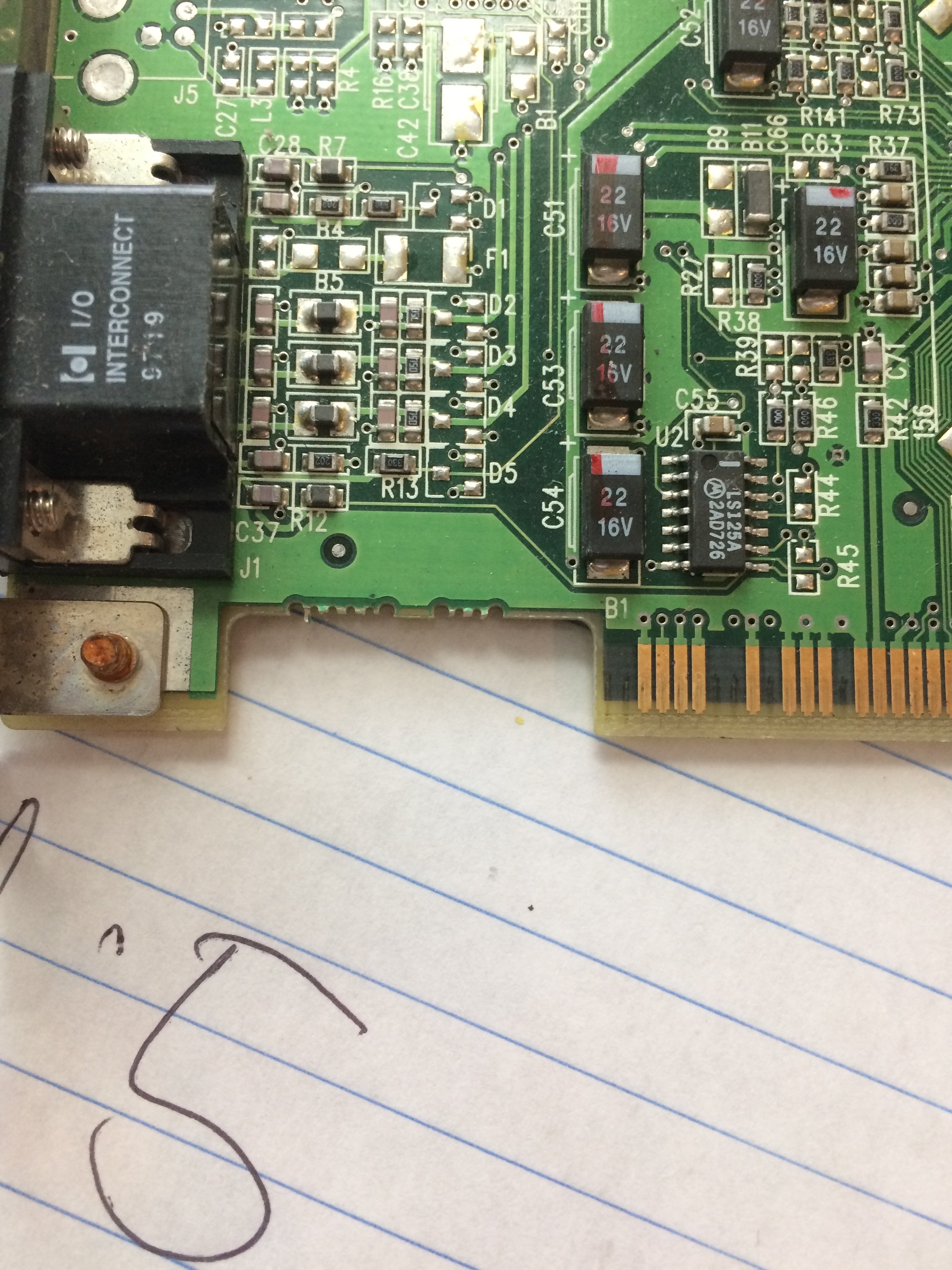

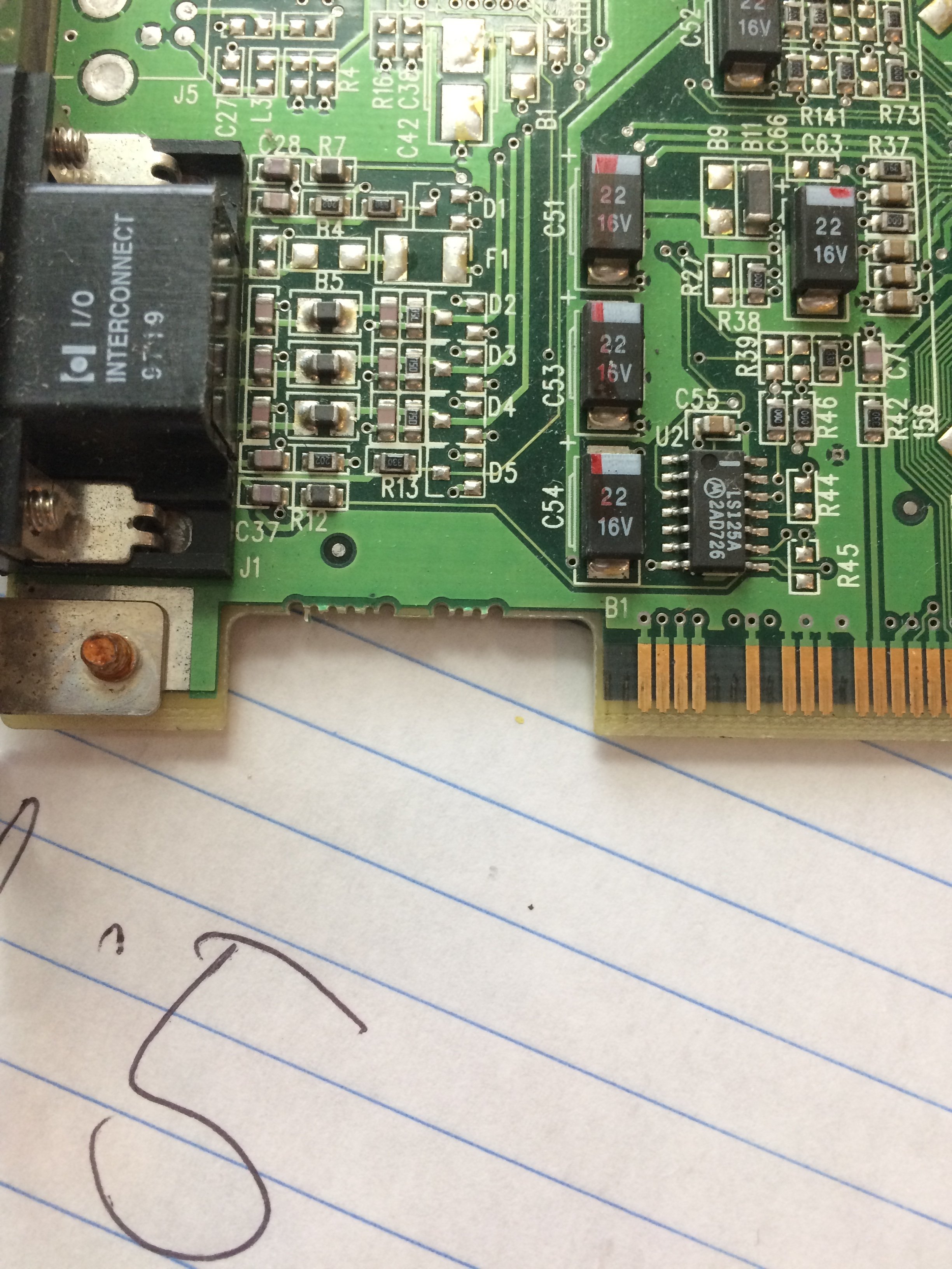

[doublepost=1504053574][/doublepost]Well I found out why my graphics card wont work... The previous owner snapped part of it off
bend the pins so they are not touching each other and try and see if it will work then.
no one snapped anything off your graphics card 🙂 thats just a left over mark from manufacturing

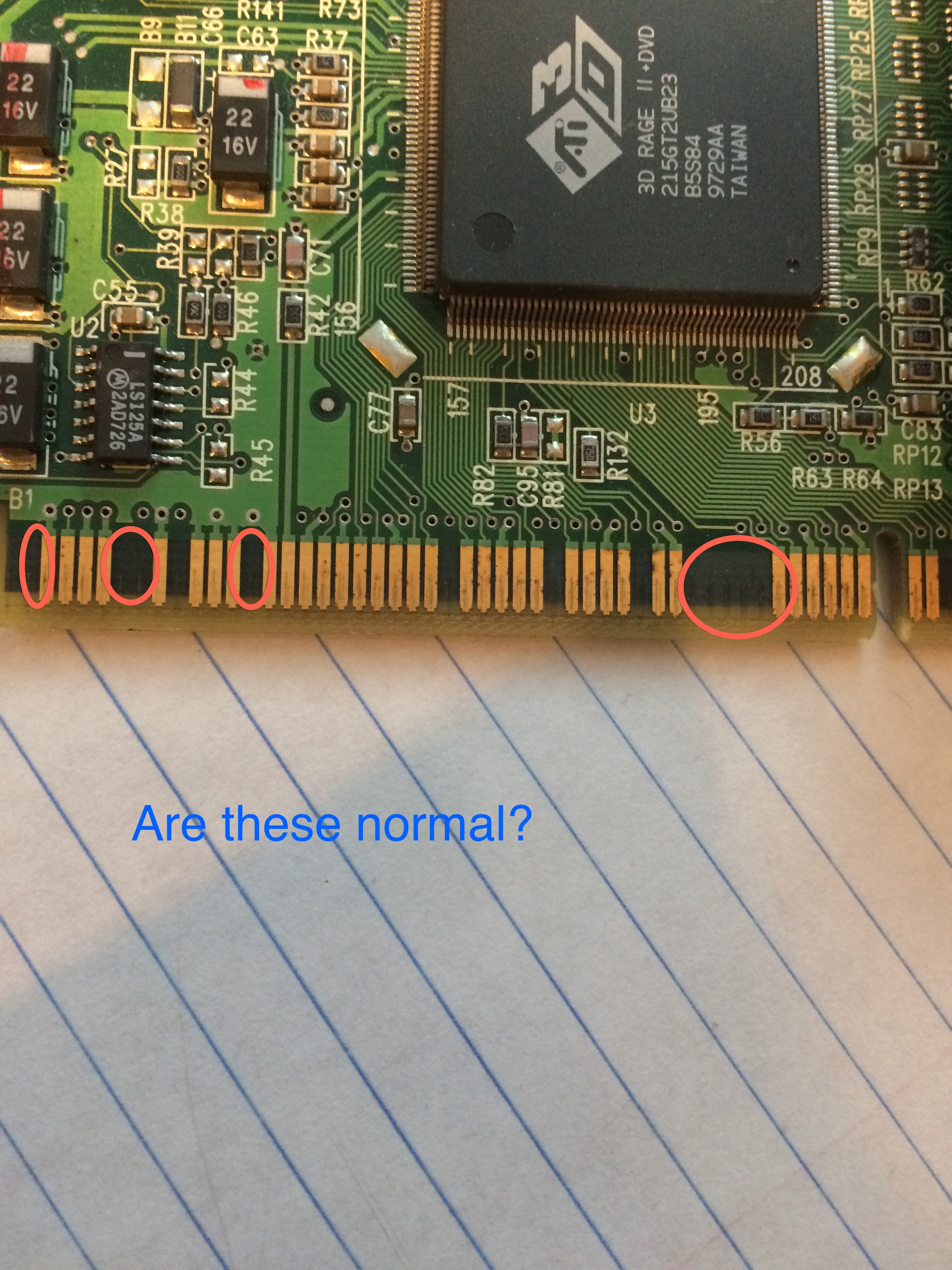

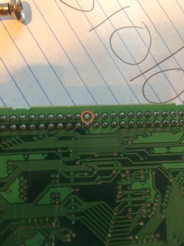

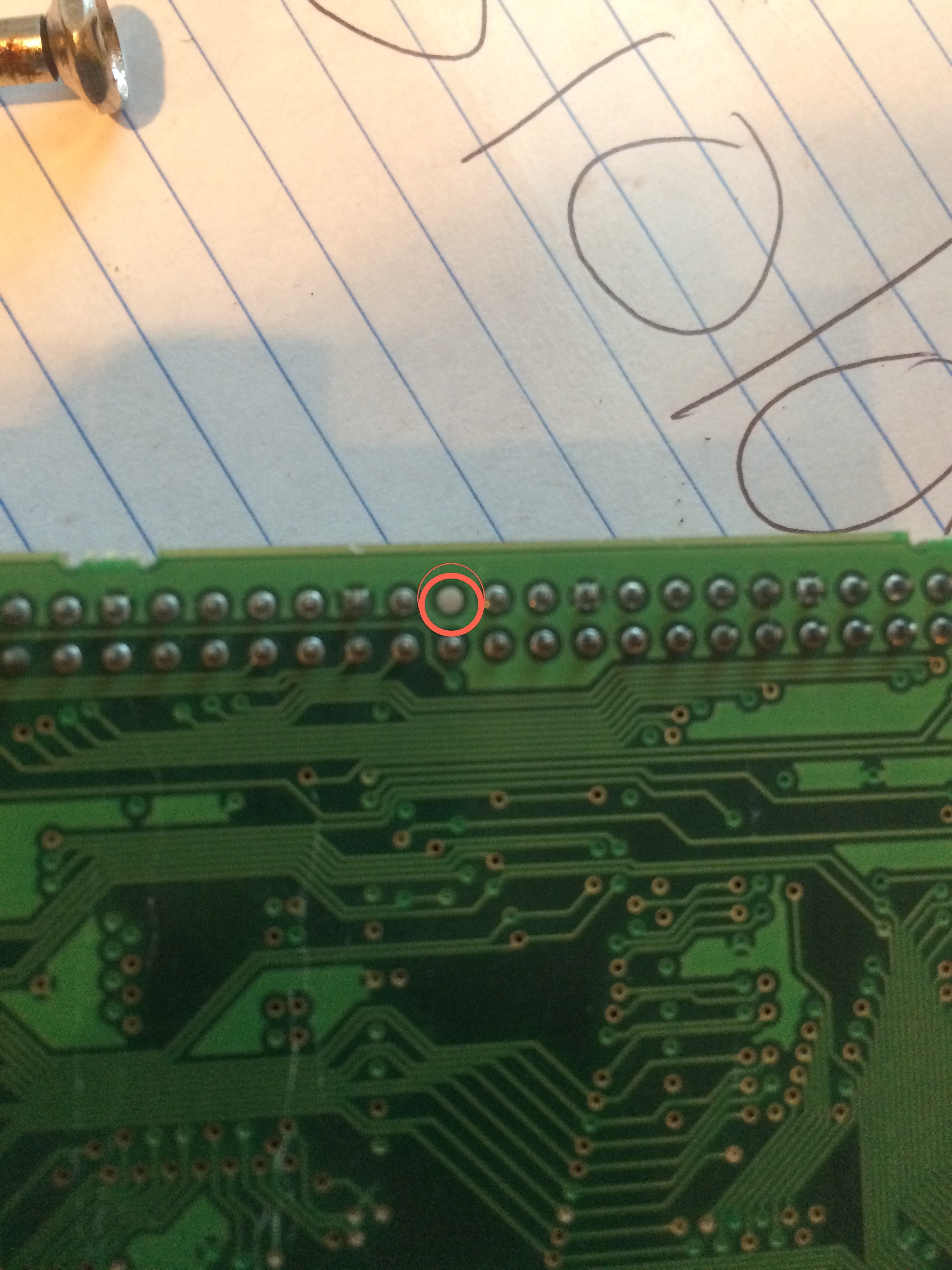

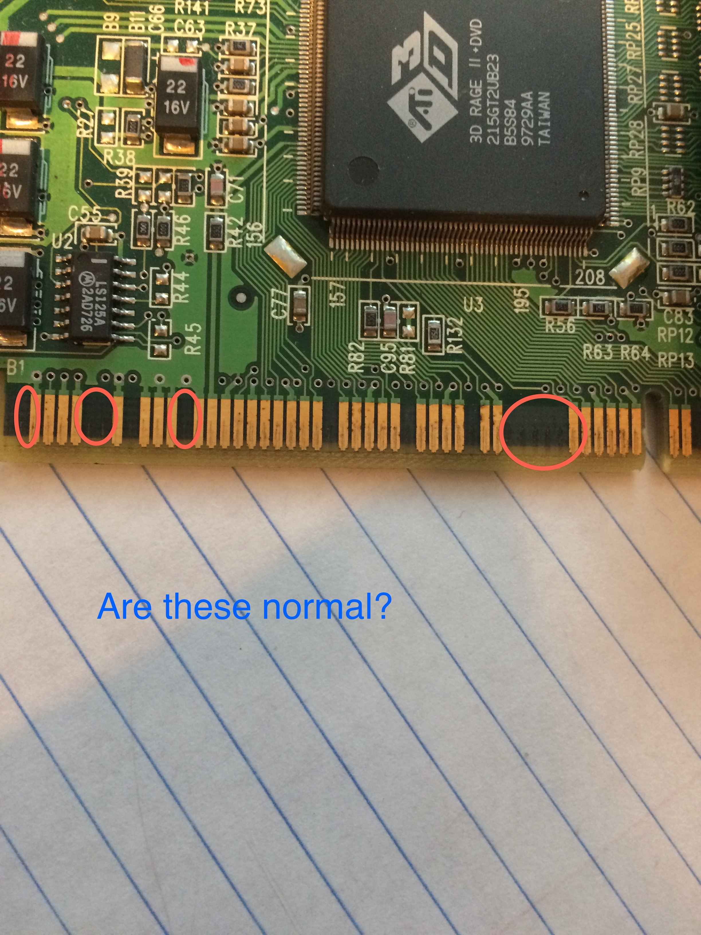

Ok, will do. I just want to make sure however that these are normal. Are they?

everything looks fine to me 🙂
BTW i noticed your sig shows 1GB of RAM what happened to the other 2 sticks? (512MB sticks in a BW G3 if they work, will only show up as 256MB each)
Bent back everything and still nothing shows up on the monitor...
