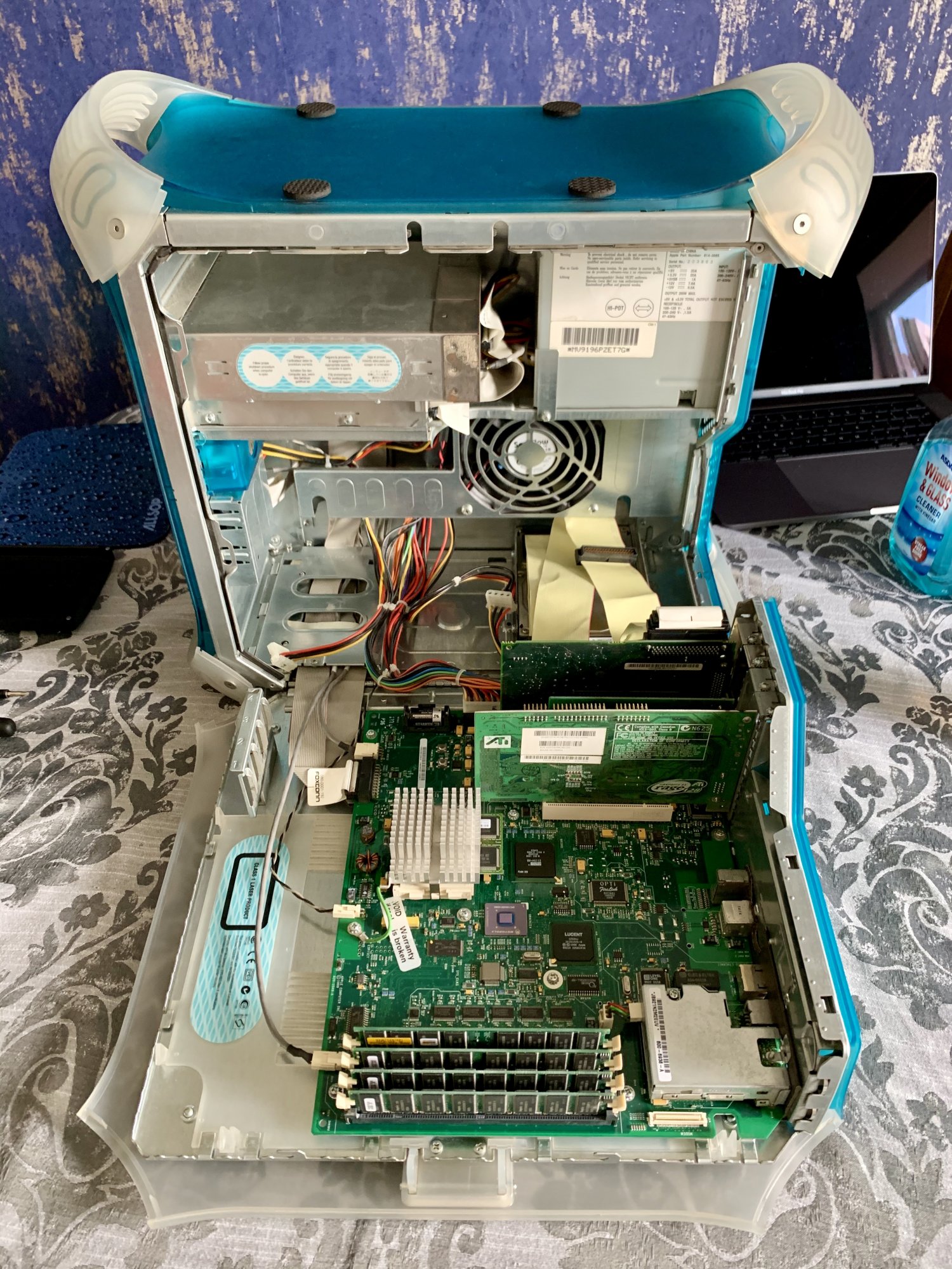

So I got to work this morning to clean out what seemed like 20 years worth of grime and dust from the machine.

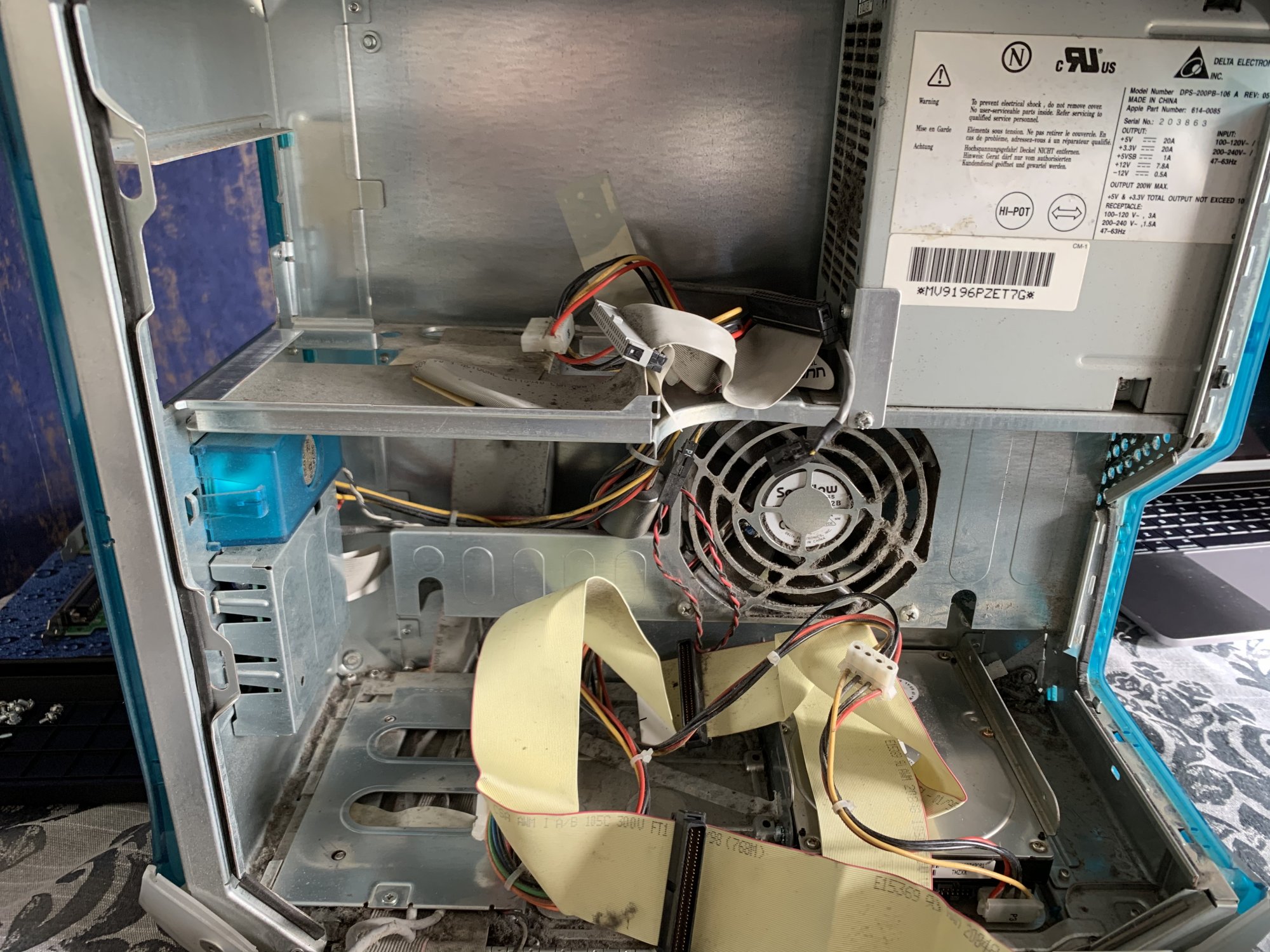

Was very happy with how well this turned out - however upon completing the re-assembley I run into a problem: The machine would not display any picture on the monitor. 🙁
After some trial and error I worked out that I could get a picture - but only if I disconnect the IDE bus for the CD-ROM and Zip drive. Individually disconnecting any of the device made no difference - only with the IDE ribbon cable disconnected - would the machine boot into MacOS. Unfortunately I still have the problem that MacOS crashes every time I boot from the (SCSI) hard drive.
Any advise how to get the CD ROM / IDE bus working again?
Many thanks.
Pull the SCSI card and SCSI drive and try using an IDE drive to install OS9 to?
I have tried disconnecting the SCSI drive and that makes no difference. The limiting factor seems to be the IDE cable being connected or not. One possible explanation might be that I damaged the housing of the IDE cable during cleaning and it's causing a short circuit. Unfortunately I don't have another IDE cable at hand to test - need to order one first.
OK - last night I did disconnect the SCSI drive and connected an IDE drive I had in storage. Because the drive had been taking from an iMac G4 - it still had an install of Tiger on it and the G3 booted without issue into Tiger. So it was the old IDE cable causing the issue.
