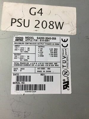

Welcome to the human race. I made the mistake of not running a power conditioner in front of my mac many moons ago (was living downtown in an old, jenky but cool AF brick building with ancient electrical lines) and blew up the psu as well. Luckily the damage was contained to only the power supply so I was able to replace it and all was well again. Anyhow, Im unsure of your particular model but I did find this replacement "G4" PSU across the pond - UK seller for what seems to be an ok price.
