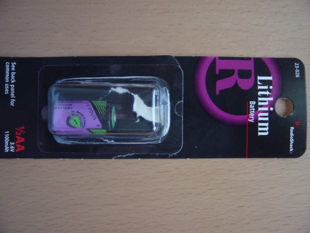

pic.php
Would that be ok to go inside it ?
My batt is exacly the same size as that ect and that is a 3v the same.
Battery Expert..
pic.php
Hi,
I am almost sure THIS one is the wrong battery. You need one with 3,6 Volt, not 3 !! You should be able to get one at Radio Shack, they are even marked sometimes "For Mac computers"
The technical correct size name is: "1/2 AA" The original Apple Brand name was TADIRAN / TL-2150
Since there are different brands out there, try to get one with a high mAH.
A 1100mAh would be great, however you can also use a 850 mAh if Radio Shack carries just this one.

thats the one i have at the moment in my mac.What are the chances though that a new battery would sort this ?
