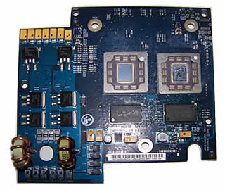

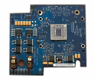

You should be able to swap a single cpu daughter card for a dual cpu daughter card. just make sure the CPU has a 167mhz bus, ie 1.0Ghz 1.25Ghz 1.42Ghz. all those should have a singe and dual cpu.
There is one connector for one G4 daughtercard. To upgrade to a dual G4, you must remove the single G4. Remember, the G4 you use to upgrade it with must be another MDD G4 or a MDD G4 compatible one.

133 MHz bus CPU daughtercards: 867 DP, 1.0 SP
167 MHz bus CPU daughtercards: 1.0 DP, 1.25 SP, 1.25 DP, 1.42 DP
SP and DP ones are interchangeable (without a hassle), only bus speed must match. Otherwise it will need be adjusted using soldering iron 😉 If you're swapping SP with DP, get proper heatsink for DP.

The CPU is soldered onto the daughtercard and cannot be removed from it. To upgrade a G4 CPU, you remove the daughtercard from the socket that has the old CPU soldered on it. Then you put another daughtercard into the socket with the new CPU soldered on it. Reapply thermal paste and start the machine.

The dual MDD have a larger copper heat sink. The alumimum you have may not be enough and could lead to overheating. You can put PC2700 184 pin non-ECC low density ram in it. It may not run at 167Mhz, but it will work.

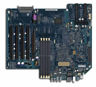

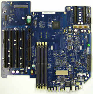

Note: A MDD single to dual conversion may not work. The single G4 has a fbus speed of 133Mhz just like the stock PC2100 ram. Putting in a dual G4, which only come in a 167Mhz with the exception of the 867 MHz dual, will require you to upgrade all of the ram to PC2700 to match the faster fbus speed. You'll also have to hope that the logicboard will speed up as well. It may automatically, it may require a resistor to be moved via soldering, it may just simply refuse to boot at all. Also remember only G4 CPUs from or designed for MDD G4's will work in your machine. I suggest you do some more research into MDD single to dual conversions.

The problem would be the fbus speed. To change this, you'll have to move a few resistors on the daughtercard or the logicboard so that they run at the same fbus speed. To, move them you'll have to solder them.
