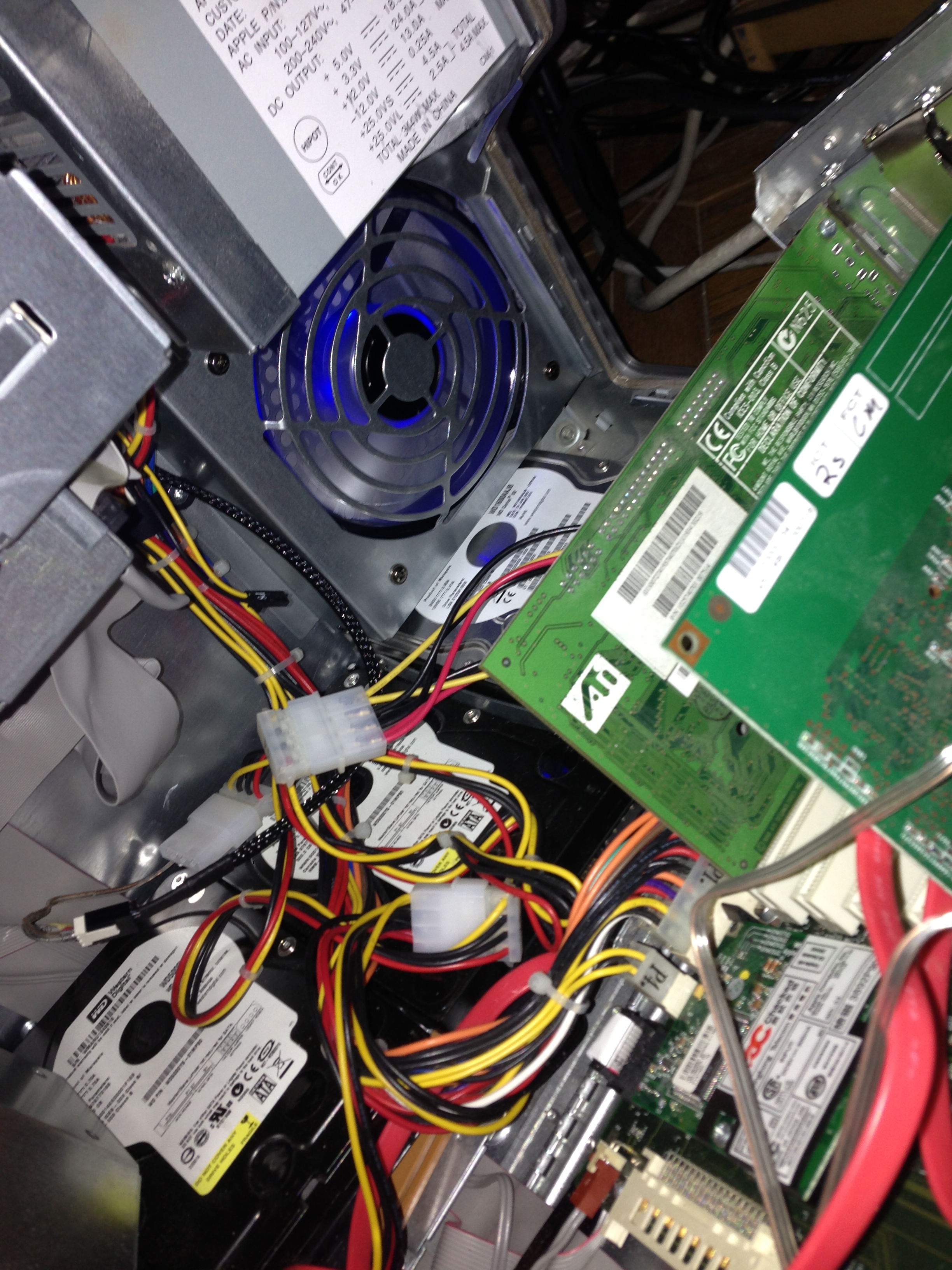

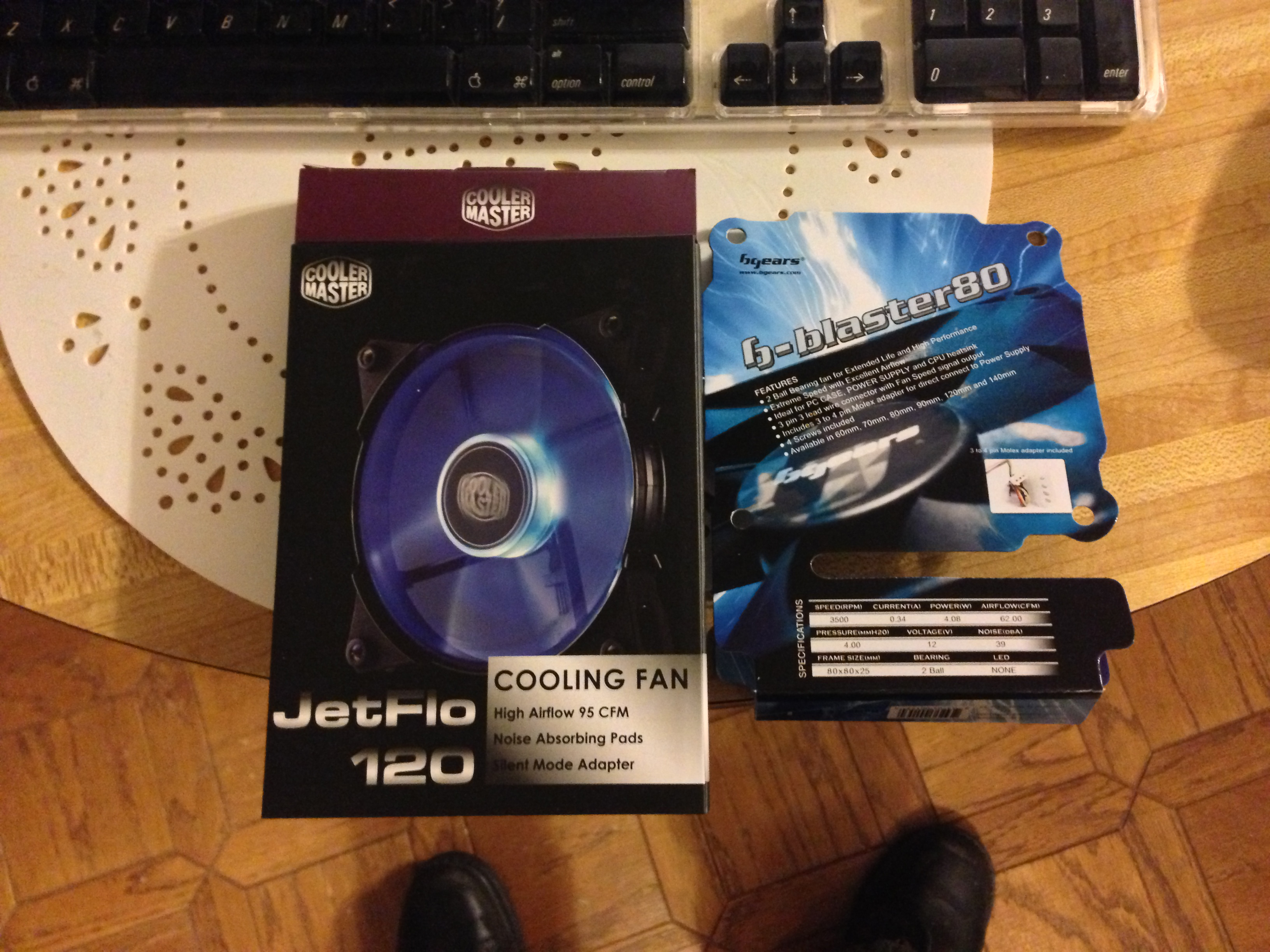

You could always replace the fan itself. My Quicksilver is different than your MDD, but the inside fans are standard 120mm fans that you can buy just about anywhere.
I replaced mine with a 95cfm CoolerMaster that does about 2000rpm or so. It's got two separate cables that can reduce the fan speed if I were to plug them in. But even at 2000rpm that fan is considerably quieter than the stock fan I took out (and much more efficient).
The MDDs are notorious for being noisy. Replacing the fan though is an inexpensive way to reduce noise. The CoolerMaster I bought was around $20. But any generic type fan can be picked up for $3 or or so. Just depends how much money you want to throw at it.

Fan replacement
Interesting. I think I've read something about this in the past, and had a vague memory of this involving either high cost or a difficult operation. I have, at one point, gotten the PSU out and looked at the fans, which required bending the case a little. Is replacement as simple as splicing standard fans in to the stock ones' wires?
Yes. Red to red, black to black. Some fans come with a third wire for speed adjustment based on thermal temps (as supplied by the logic on a PC motherboard), but that wire can be safely ignored.
However, some of these fans come with adapters that allow you to hook them up to Molex connectors. Or you can find adapters. That saves having to splice things.
The PSU is a little different in that you have to get it out, discharge the electricity from it, open it and swap out the fan. I've done that with my QS with some trepidation, but the replacement fan is of higher CFM and does the job very well.
You can be creative too if you like. The CoolerMaster I bought has blue LEDs in the fan hub. Makes for a nice effect. 😀
