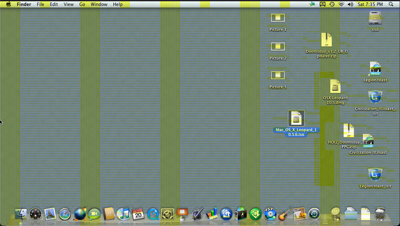

Sorry for the late update. Some good news and some bad news. I successfully flashed the 9800 pro. At first the computer would not boot. I desoldered the two resistors and it booted right up. Flashed with graphicaccelerator and it seems to work fine except for yellow lines. Not your typical artifacts. Its strange, as it even shows up on screensharing. I tried another rom and same issue. Any advice? I hope the card isn't the issue.
Thank you in advance.
Yes, I set the the core and clock to 9800 no pro frequencies to no success. I tried both the sprinter and gotoh roms.

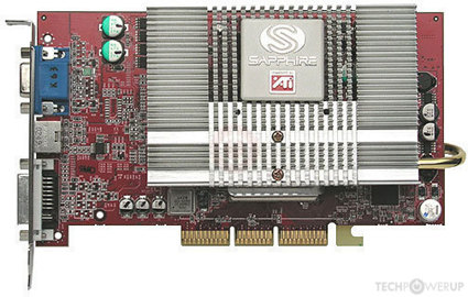

Here is the actual gpu,
"No success" as in the yellow bars are still there, or it doesn't work at all? My guess is the card is bad. If you put the peecee ROM back in there and try it under dos and see the same thing then that would confirm it.
G
Good idea, I'll do that this weekend. No success as in same issue.
