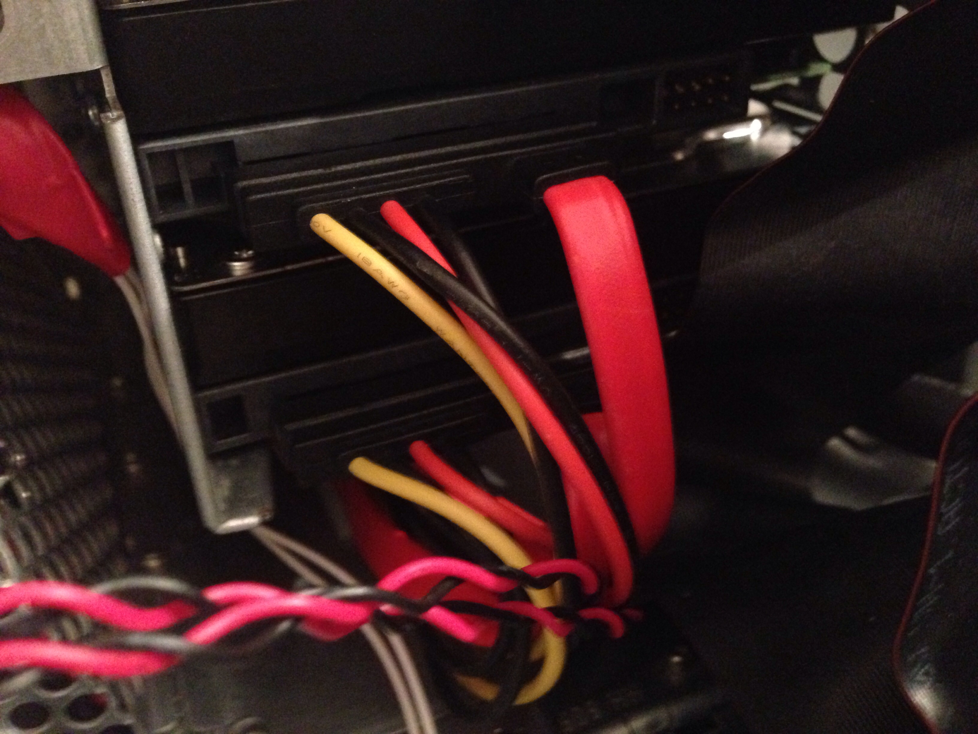

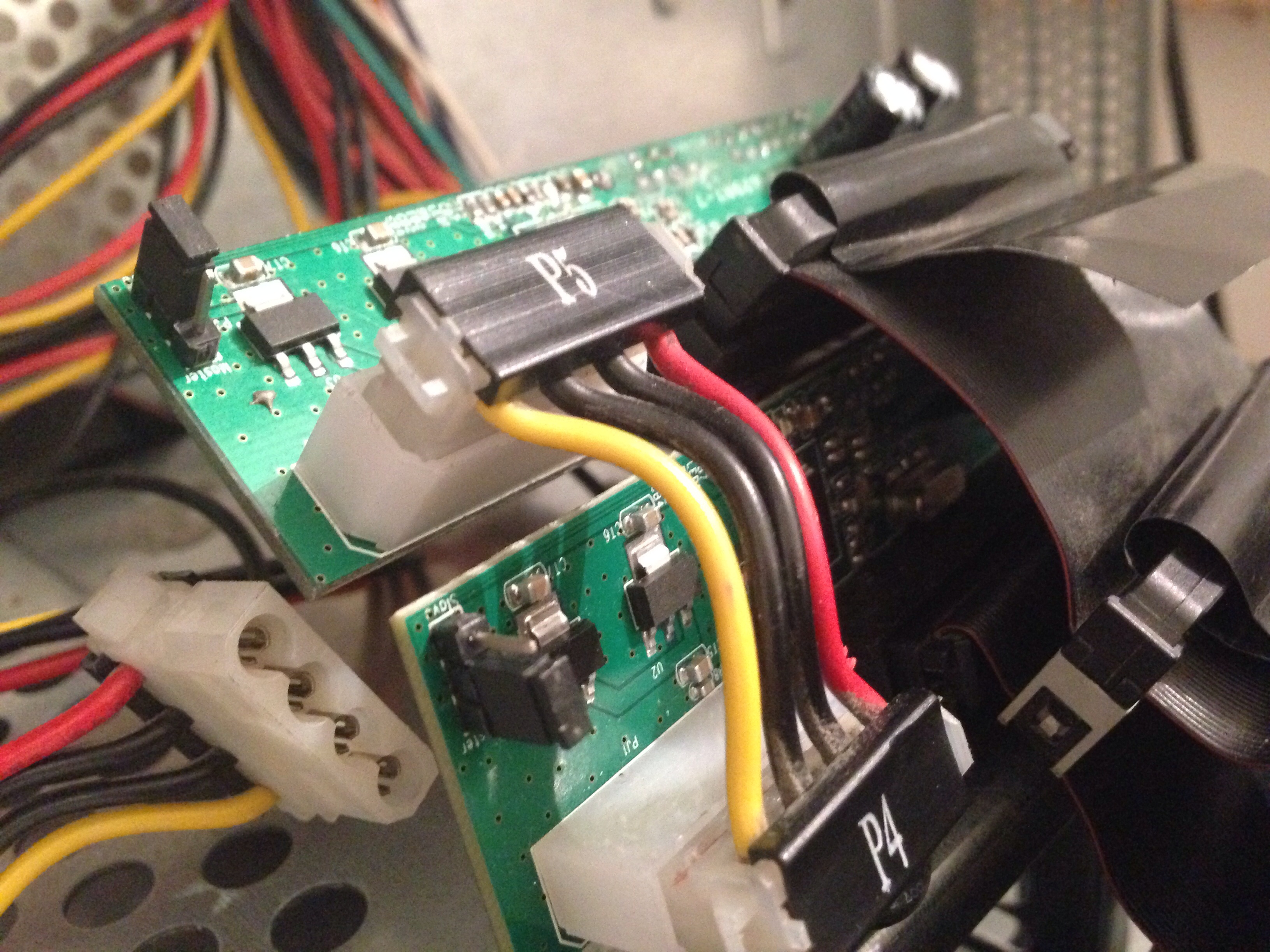

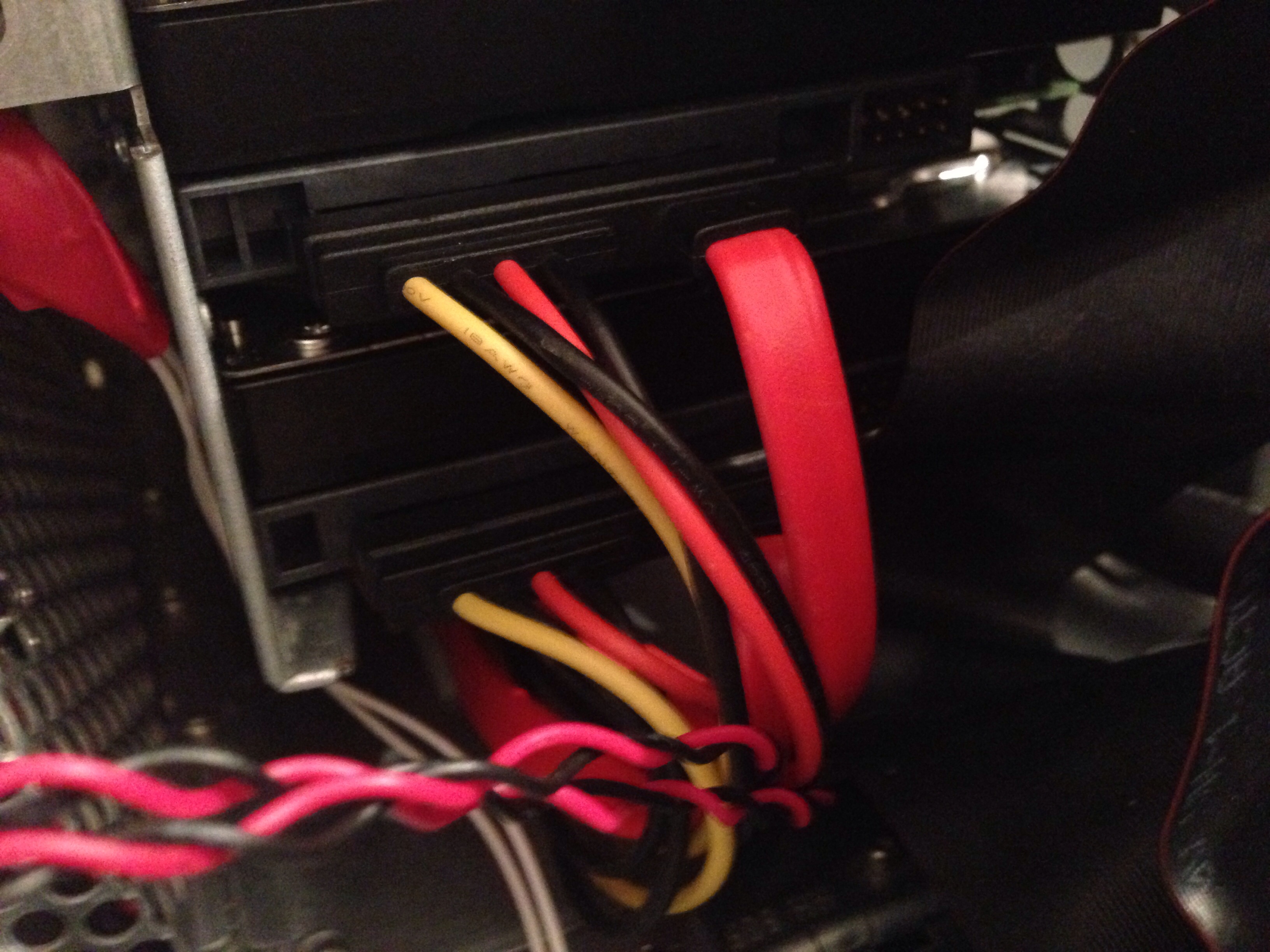

Here are some photos (sorry about the messy wiring!)
That adapter doesn't appear to have a master/slave jumper or switch on it. Have you looked into use a PCI SATA card instead?
