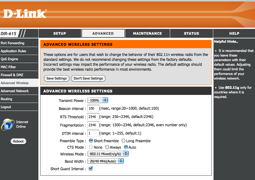

Hey,
I have 3 other macs connected to the N router. On the powermac it doesnt even see any routers (it used to pick up my old g router) even when i press rescan it doesnt find any networks.
here is a screenshot of my settings:
Did you try plugging the network card into the new router with a cable? Did you check System Preferences in OS X and make sure that your network settings weren't broken when you changed equipment?
I think it has to do with the wireless encryption you are using. I can't remember of the top of my head but I think the newer protections won't work with the older OS. What OS version do you have installed on the G4, Tiger or Leopard? Make sure they are updated fully. 10.4.11 for Tiger and 10.5.8 or Leopard.
Can't remember what versions were compatible with what OS versions. Maybe someone who knows more about wireless networking would know more?
Maybe you can try to remove the network password or at least set it to WEP 64bit to see if your G4 will recognize it then? Those are easy to crack so don't use that as a permanent setting.
