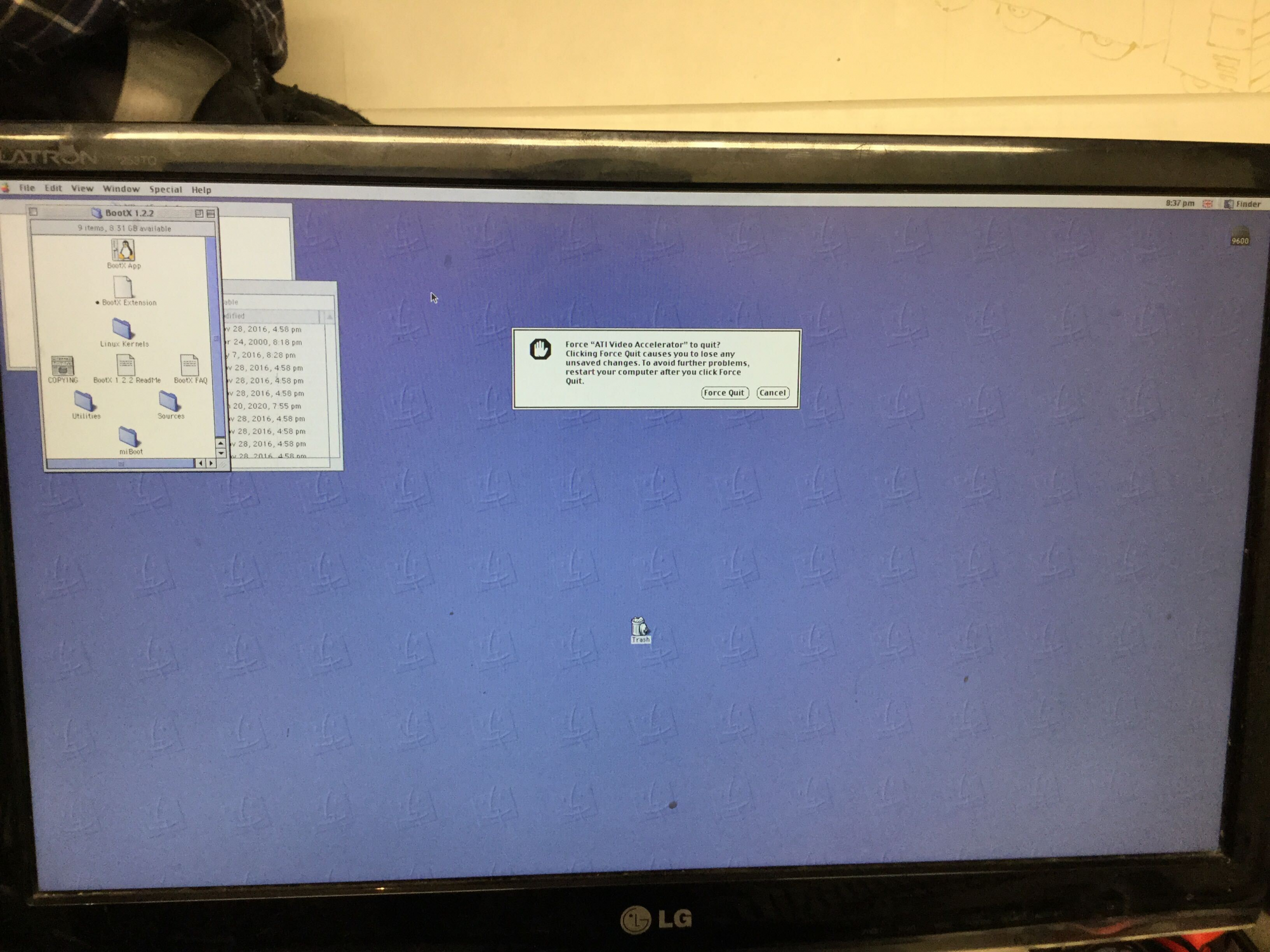

if this is indeed whats happening then you can also do the force quit key sequence and force quit the extension thats holding things up and continue to the desktop 🙂
not sure where exactly to post this but since the machine im using in the picture is the 9600 figured id throw it here
but those who have a Radeon 9200 Mac edition know the pain of, installing it and forgetting to install the drivers which will cause the machine will lock up just before the desktop loads
and while you can boot without extensions enable and the system boots up all the way, the driver installer needs extensions enabled! so its a little bit of a catch 22 situation
well if you boot up normally and then do a force quit when it locks up it will actually let you kill the offending extension and let the system finish loading 🙂
I found this out on my own a good while ago out of desperation 🙂 but I realised when playing with my 9600 just now that I dont think I ever posted about it!
so yeah figured id post about it as its a handy way to get out of an otherwise annoying catch 22ish situation 🙂
