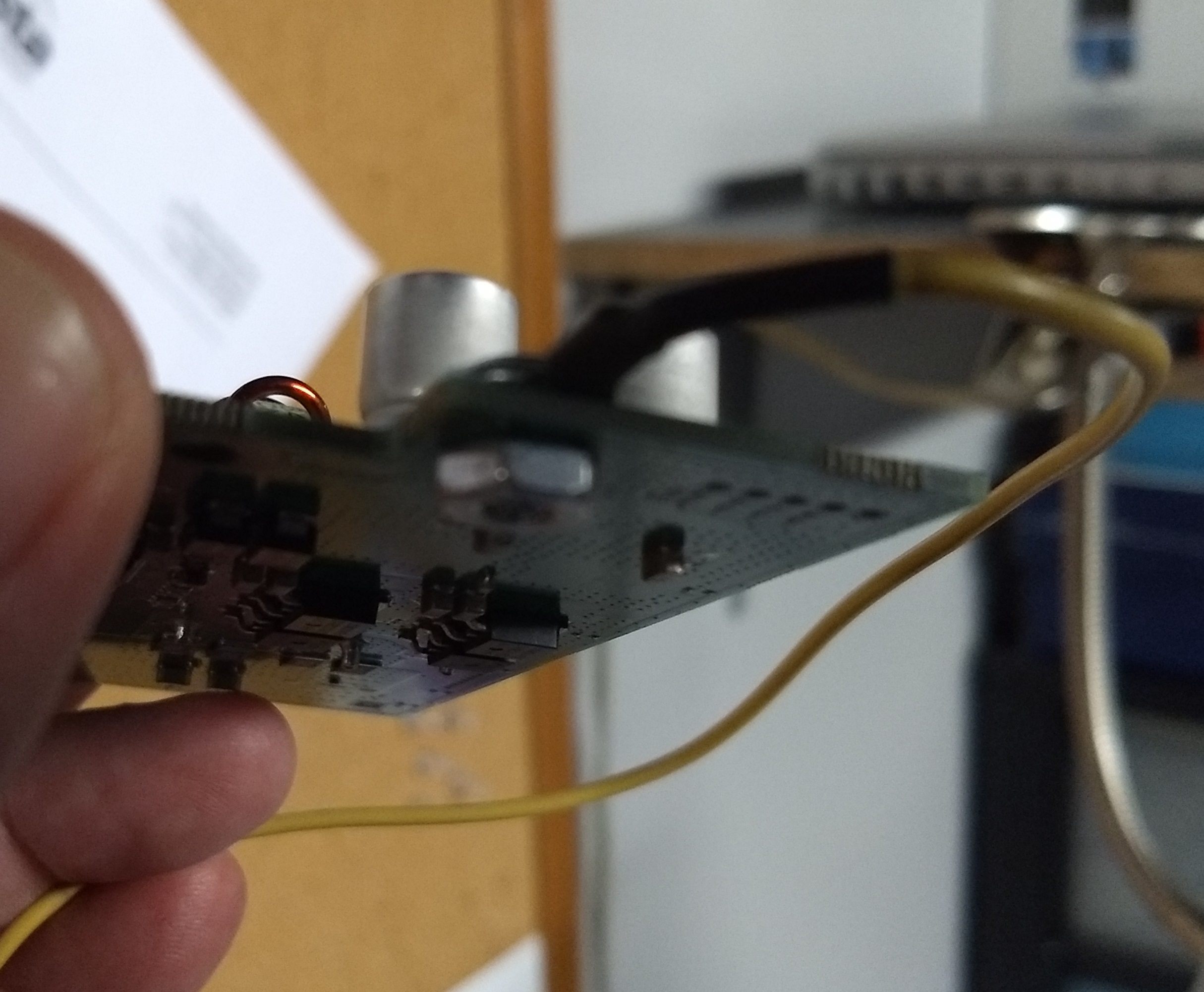

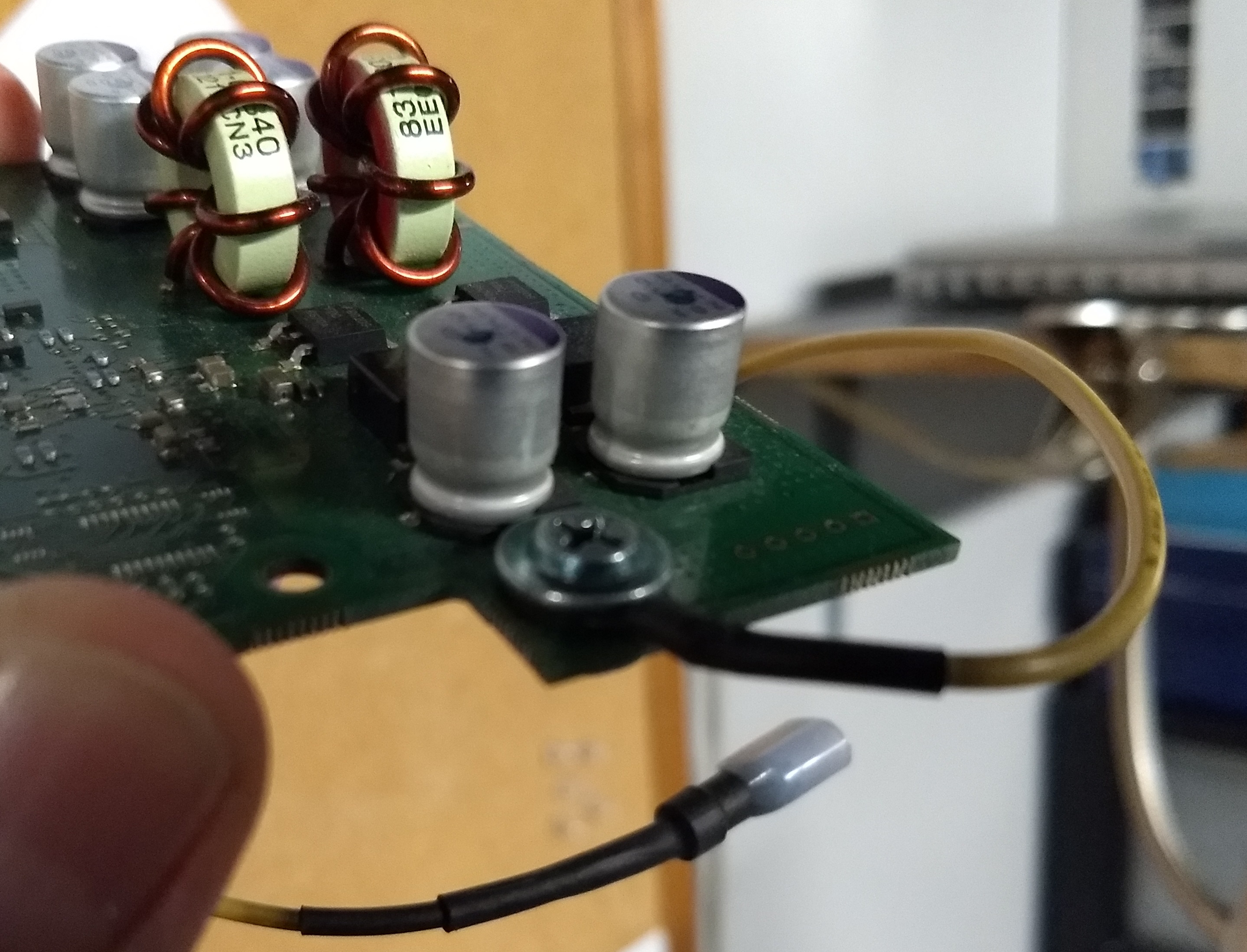

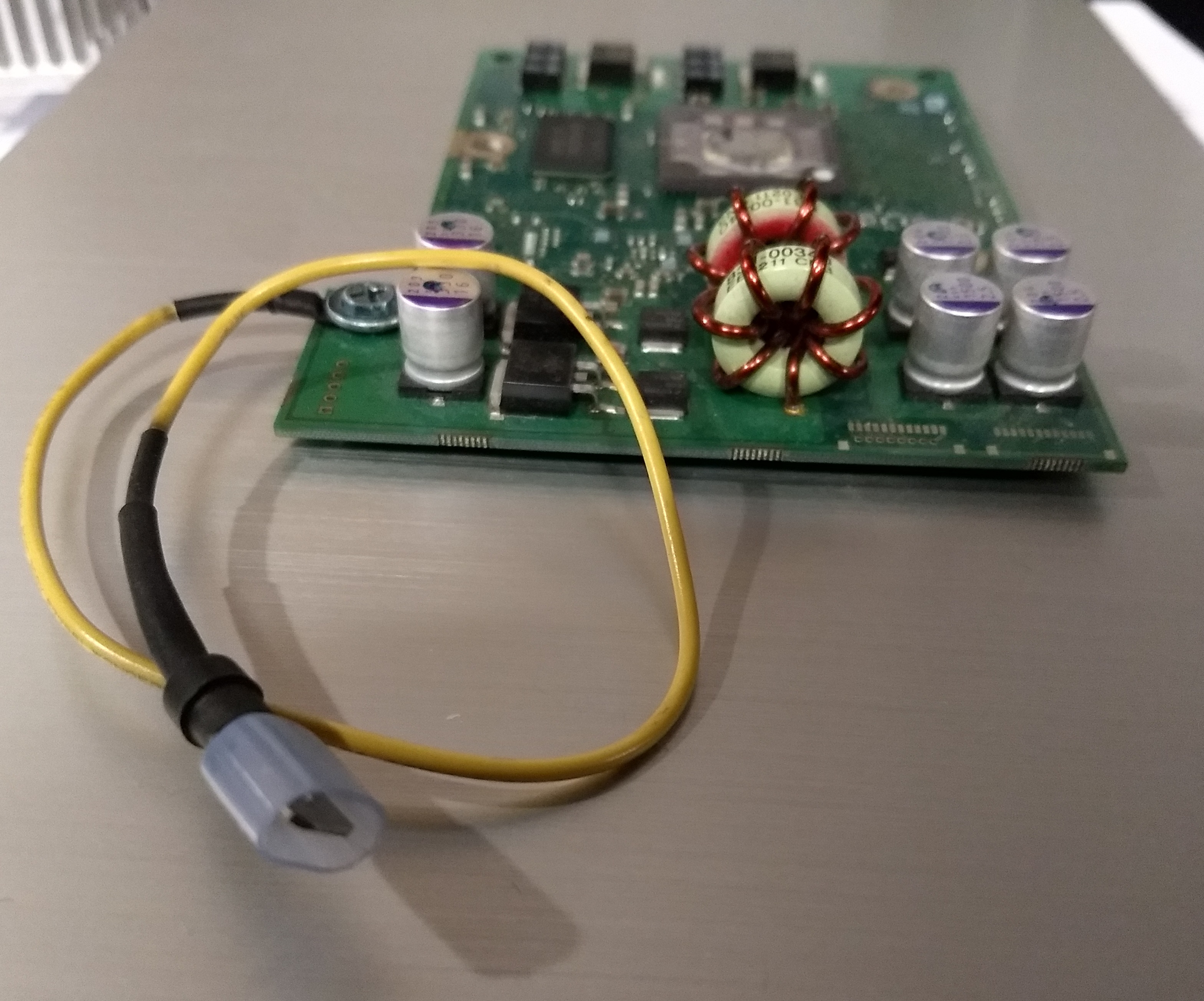

The QS CPU will work in the DA, with a small electrical mod. You'll need to bring 12V power to the 4th mounting hole on the QS CPU's daughter card. You'll find a discussion of this issue here and here (the second link is thru the Wayback Machine, and discusses using a QS CPU in a Gigabit model, but the principles are the same).
Also, see below for pics of my own mod to make a 933 MHz QS CPU work in a Sawtooth (again, same principles).
The yellow wire in the above pics is standard 12V wire cut from an old PSU. I soldered a ring connector on one end and attached that to the 4th mounting hole in the CPU card with a short bolt & nut. Then I soldered a sleeved male connector to the other end, which plugs into a sleeved female connector spliced into a standard Molex plug's 12V wire.
You don't have to do something so permanent as what I've done, I only went to the trouble so it would be easier to install/uninstall the CPU: just plug/unplug the connector. Whatever method you choose, just be sure that your power connection isn't touching anything else above or below the CPU card. See the next couple of pics, I used a very short bolt and nut:
