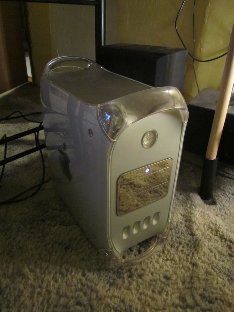

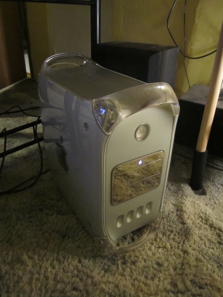

I just picked a 866 MHz (Dual?) g4 with 1.5gb of ram off of craigslist for 20$

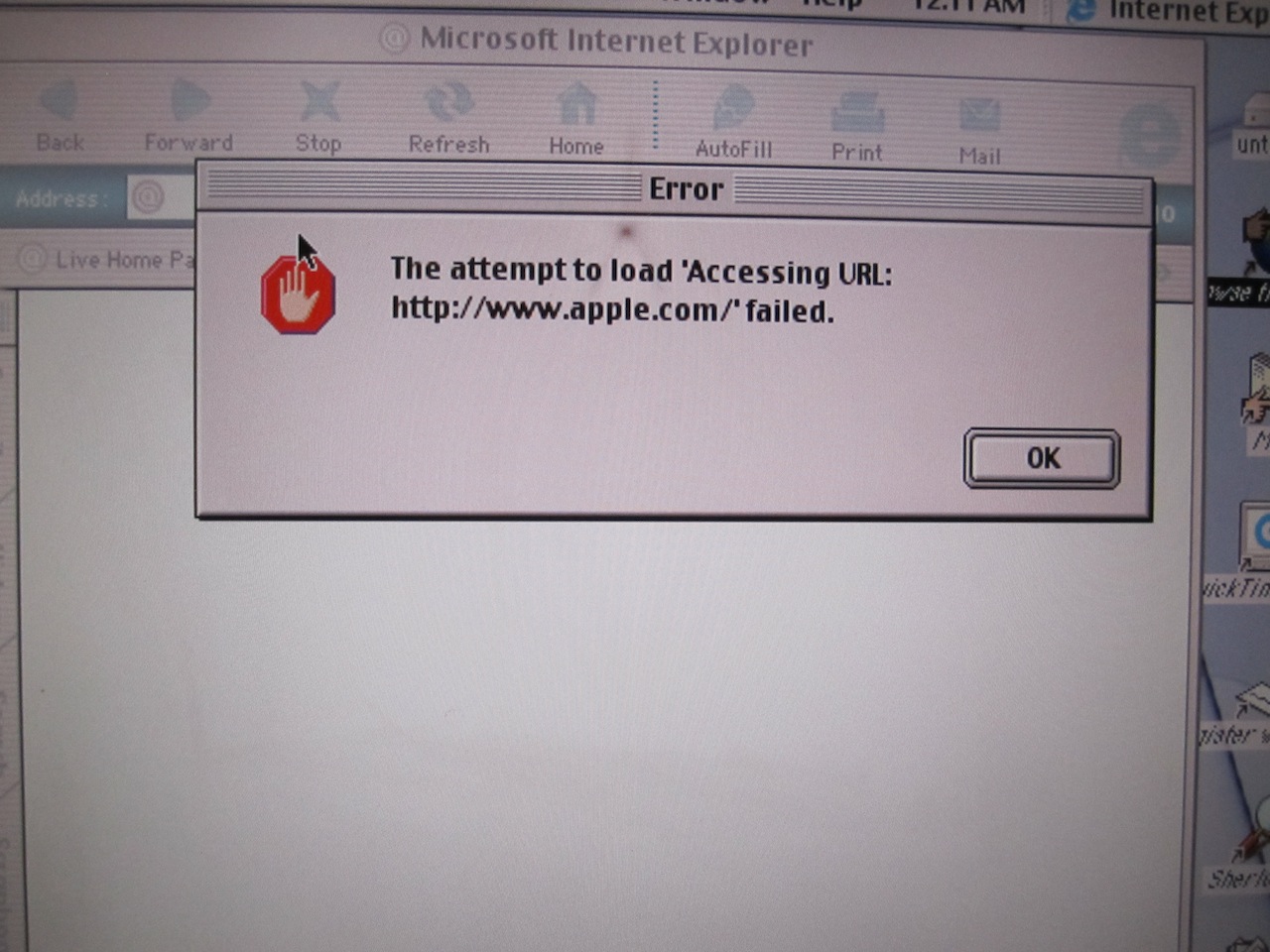

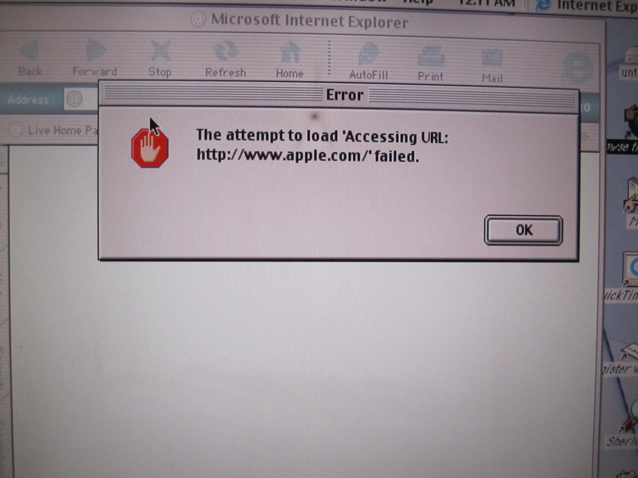

I runs awesome, but I connected ethernet to it and I get this error when trying to access the internet. anyone know what I need to do to get it connected to he net?
sorry for the stupid thread, but I have never used OS 9 and am lost lol....
Thanks!

You don't need LA at all as your Mac meets the requirements of Leopard. You have an MDD not a Quicksilver. Starfighter doesn't seem to understand what Mac you have even though you show a pic.
