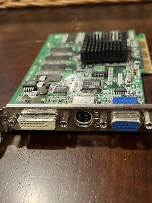

Some more digging has brought me to this one, how do we feel about it?

That depends on whether you intend on running Leopard or not, as it requires some driver hacks to be able to work on Leopard. Even then, the experience will not be great.
The R128 Pro is a lot slower than the stock GPU that came with the 933MHz Quicksilver, the GeForce 4MX. I know you said that performance isn't too much of a concern, however the R128 Pro is 7x-8x slower (not 7-8%, but 700-800%) than the 4MX.
Leopard (and by a smaller extension OS X as a whole) is much more graphically demanding than Mac OS 9 was. You probably will feel the difference between them, even without doing anything graphically demanding.

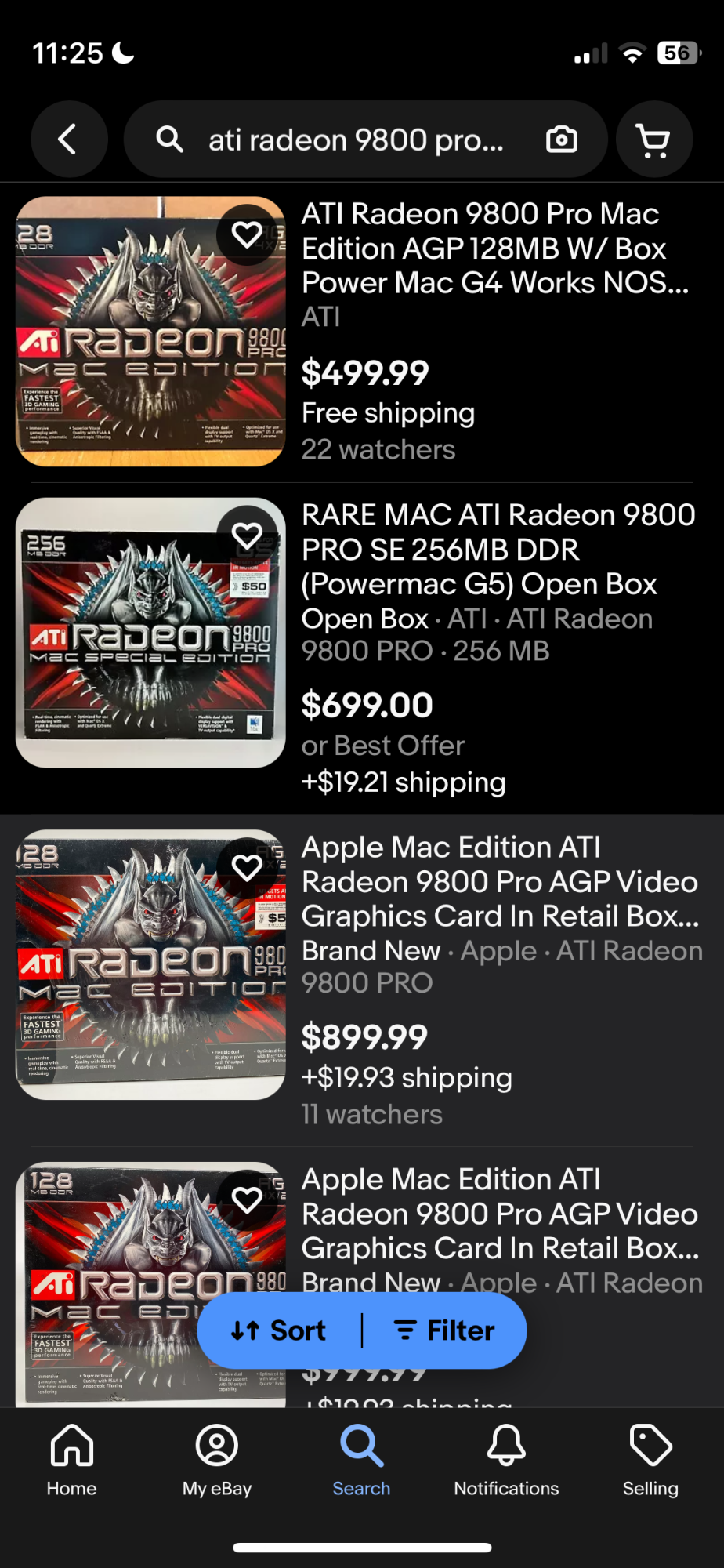

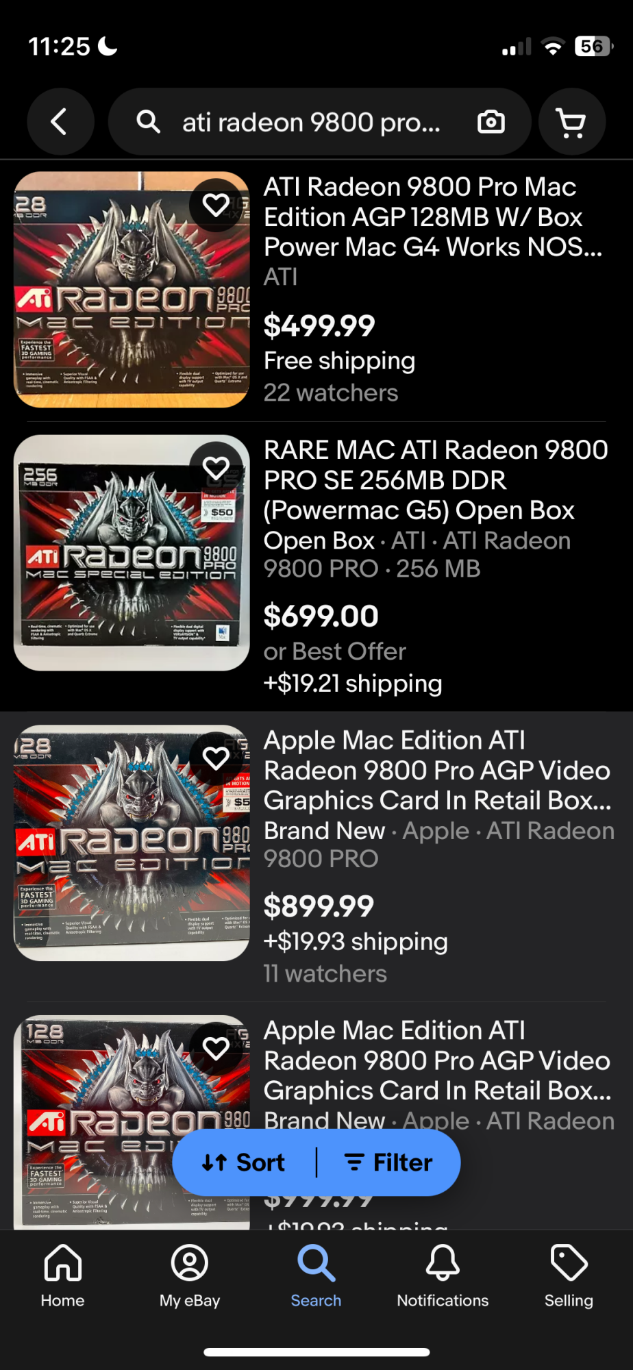

I’ll set up a saved search for a Mac 9200, no eBay results for a Mac specific one… meanwhile it seems that the 9800s can be found readily, if you’ve got enough pocket change saved up🤣
There are more reasonably priced used ones for $100-$200 of course. But that’s still way out of my price range.

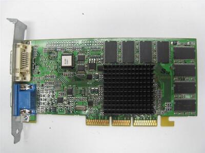

My original searches on eBay had brought me to purchasing this
Which I believe is a flashed agp card? Not entirely sure. But after install there was an incredible amount of artifacting and it even caused the Mac to crash at one point. I removed it and can only hope it didn’t cause any damage to the rest of computer. Which thankfully it doesn’t seem like it did.
