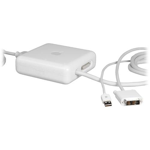

Any card you get that has a DVI connection will require some kind of adapter to work with the ADC cable of the Cinema Display. And one of those Apple ADC<>DVI adapters that were commonplace with the aluminum Cinema Displays won't work.
No, these adapters need to provide power to the display. Apple made an adapter for it. It's referenced as the A1006.
Up until about a year ago it was hard to find them on eBay for less than $100, but in the last year the prices have come down into the $40-50 range.
This is what they look like:

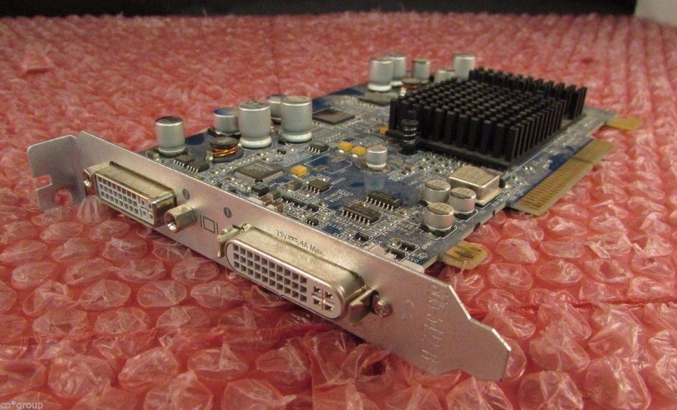

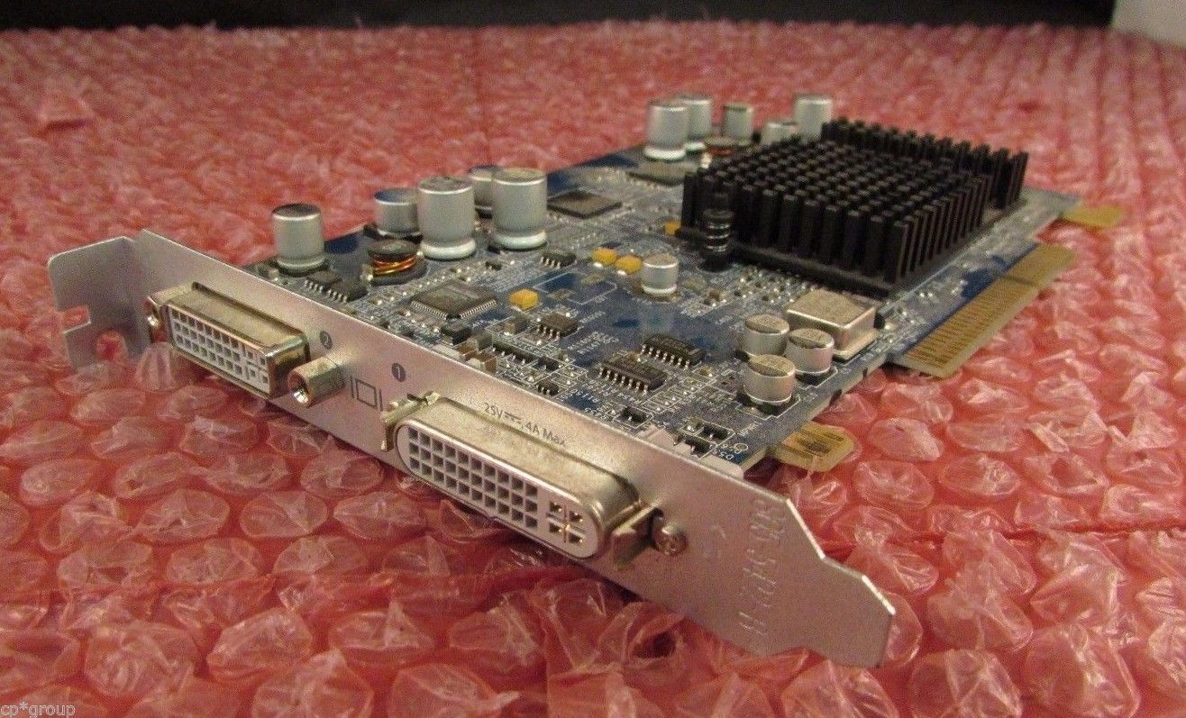

Thanks for the reply. The card I bought has an ADC connection. Here's the info I have from the seller (for what it's worth): "Apple ATI Radeon 9600 Pro 64MB DDR SDRAM ADC/DVI AGPx8 Heatsink Video Card" and here's a photo of the card itself. I hope this clarifies.
Thanks for the reply. The card I bought has an ADC connection. Here's the info I have from the seller (for what it's worth): "Apple ATI Radeon 9600 Pro 64MB DDR SDRAM ADC/DVI AGPx8 Heatsink Video Card" and here's a photo of the card itself. I hope this clarifies.View attachment 616010
The G5 version of the card won't natively work in a G4. However, it is possible with the help of this guide, although getting ADC working is a little difficult because of the different location of the power pins.
I've been running a 9600XT as per that guide in my Quicksilver for nearly a year(in fact I've even replaced the computer in that time!). I run a 23" HD Cinema acrylic off mine, and in all honesty the mod isn't difficult if you're comfortable with soldering.

It would be very difficult to get an ADC display to work on a 9600 without soldering.
The only card that supports Core Image, ADC, and doesn't need soldering to work in a G4 is the 9700. These are rare, and from what I understand can be "touchy" in QSs. If you use one of the adapters Erik mentioned above, you can use a Radeon 9600 Pro PC&Mac(no taping required) with your ADC display. You can also use the 9600XT by only taping and using the adapter.
If you forego core image support, your best option is a GEForce 4Ti. These are also not that common, but are more common than the 9700. This card is plug and play in all AGP G4 Macs. It has one ADC and one DVI port.
