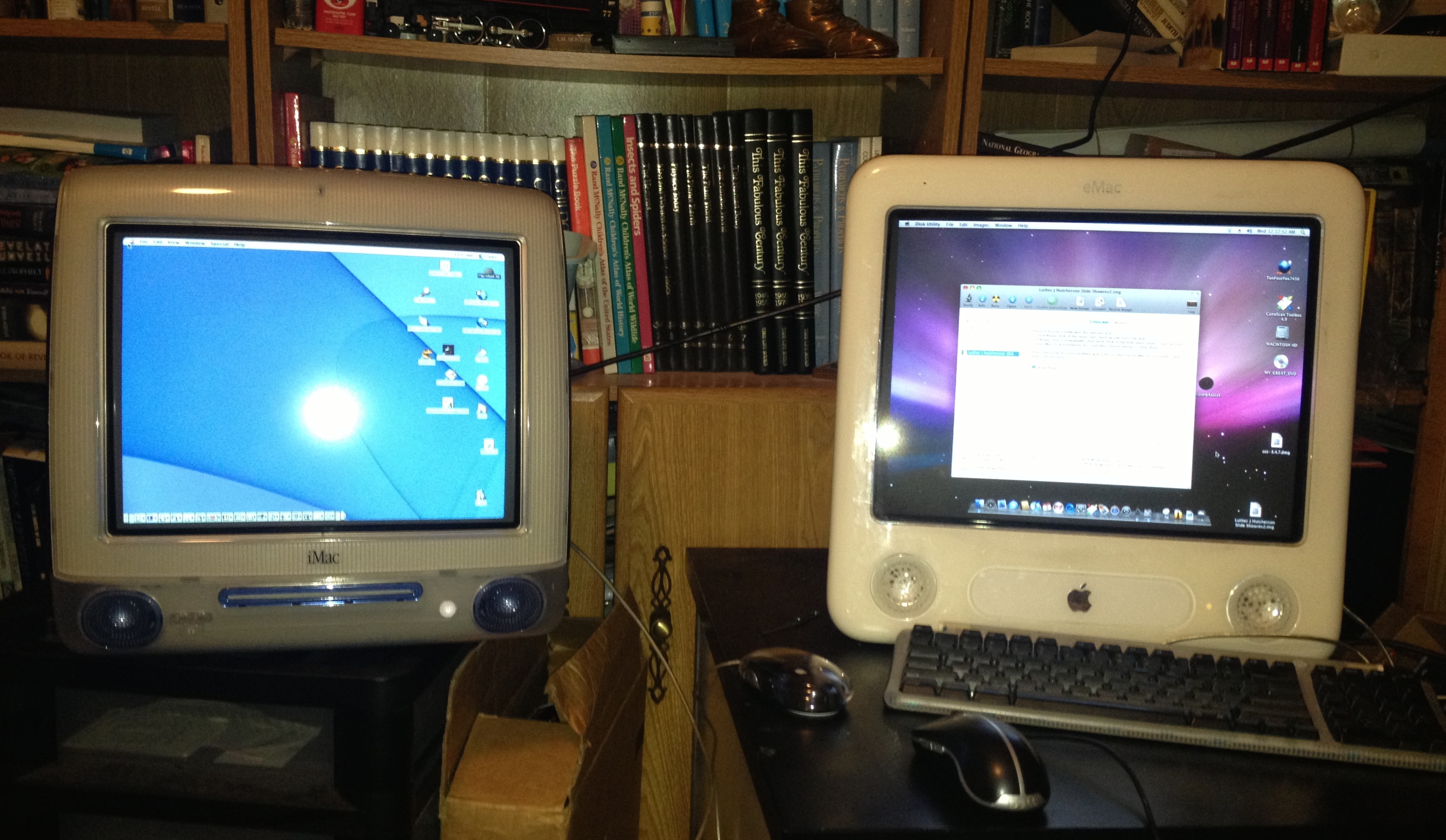

Here's the "quiet and loud" pair mentioned above. One of these days, I'm going to change out the drive in the G3 for something newer that will hopefully be not only quieter, but also larger and faster. Most of the newer 7200rpm drives I've used(even IDE) are a lot quieter than their older counterpart.

Like I said earlier, my 20" Late 2006 iMac is pretty quite at idle, however it still has the original 500GB hard drive in it. It is a Hitachi drive and is quite noisy, especially when the machine is waking up from sleep. Also, it takes at least 12 seconds or more to fully spin up from sleep. I would definitely change it out for something newer, however I really don't have the time to take my iMac apart and put it back together. Since the drive still works, I have no problem with it, and it is pretty cool that every part inside the computer is original!
I put a 40GB WD HD, each in two of my G3s. It's not even that new, now a 7 or-so year-old HD, but it makes such a difference in noise and adds a speed boost. However, the semi-older ones, while they don't have whines, still have loud thumping that echoes throughout the bulbous casing. So it's good to get as new of an IDE drive as possible. Know that 128GB is the apparent maximum.
