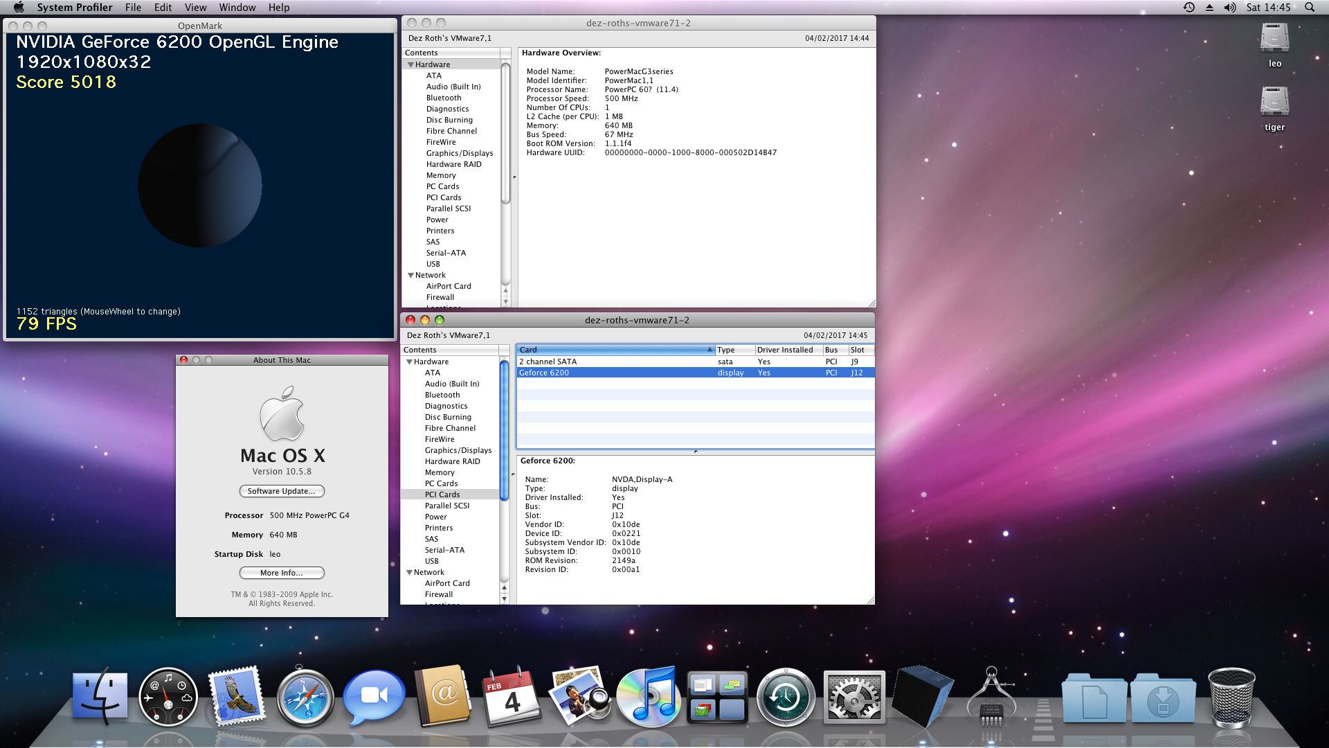

the GeForce 6200 fully supports core image including the translucent menu bar, infact its the only card to give you full Core image support a G3 BW 😀

you must of been using a GeForce FX 5200 🙂
picture-1-png.686974
No, it was a 6200 that I flashed, but I *did* initially flash a 5200 and used that first. I got my issues mixed up, as I had to remove a kext to stop the 6200 from delaying the bootup time in Leopard. The 5200 was the card that didn’t have full Core Image support. Getting old and forgetful...
