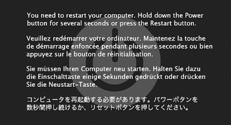

Hi guys! My PowerMac G4 is having a weird problem, but I am pretty sure you'll help me identifying this problem and fixing it.
Specs are: PowerMac G4 MDD 1.25 GHz single core (PowerMac 3,6), 1 MB cache L3, 4 sticks of 256MB of RAM to get 1 GB (but sometimes showing 768 MB in "about this Mac", after a reboot again 1 GB), video board is the stock Ati Radeon 9000pro and it has two HDDs. One is for OS X Leopard and the other one is for Debian (so I also have Yaboot installed as bootscreen).
The problem is: sometimes, when I have it turned on for at least a few hours and have a screensaver running in the background, or/and with music playing using Vox (but I think it'd be the same with any other player), or it is turned on for a few time but I am watching some video on Youtube on webkit, suddenly a weird noise like a BZZZZTTSS, BZZZZ (like radio interferences) comes from the speaker, the Mac stucks, the spinning beachball appears and/or the message saying I have to reboot (the one in the attached pic) appears.
I must tell you that I have never done any manteinance task (such as clean the inside, replace the thermal paste, replace parts etc...). Is it related to manteinance, RAM, or what???
The Mac works normally and well for the most times I use it, in fact I am typing this post on it.
Thanks everyone in advance 🙂

If it sometimes shows 768MB when there is actually 1GB I can pretty guarantee it's a bad memory stick. Kernel panics are very common for this.
Here's what you need to do... take out one of the 4x 256MB sticks and run the system normally. Do this with each stick until the issue stops. When it stops then whatever stick is not installed was the culprit, and should be recycled.
As for the audible buzzing. it sounds like it's a grounding issue. Not as in power grounding but as in audio grounding. There are specific little wires that you can buy which attach to a metal part of the case to alleviate this. I'm not sure what they're called though.

The problem is: sometimes, when I have it turned on for at least a few hours and have a screensaver running in the background, or/and with music playing ... or it is turned on for a few time but I am watching some video ... suddenly a weird noise like a BZZZZTTSS, BZZZZ (like radio interferences) comes from the speaker, the Mac stucks, the spinning beachball appears and/or the message saying I have to reboot...
When I try putting it in sleep mode, it gets into sleep mode and then instantly turns itself on again.
These are all potentially power-related issues (the last one, almost certainly). Does your MDD still have the original power supply unit?
Years ago I too experienced something similar with my MDD, a few weeks before the PSU failed outright. If yours is doing the same thing, you can expect that one day it will simply "die", and that will be the end of it (the PSU, not the MDD). All MDD's were shipped with failure-prone PSU's; frankly, if yours is still original it's remarkable that it's worked this long.
There are alternatives. I replaced my MDD's original PSU with an ATX unit; many others have also had success going that route. If you want to read more about that, check out this thread.
But before you do that, it's definitely worthwhile (and a good bit cheaper in time and effort) to try out @timidpimpin's and @Dronecatcher's suggestions. Keep in mind, though, that often a failing PSU causes the failure of other components before it goes. If your symptoms persist, or return, then it's probably time to give the PSU a look.
