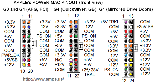

Interesting, sounds as if the PSU or the power button isn't working.
I think if you jump the PWROK pin to COM it will turn on, this will test the PSU, it should spin fans, drives, etc.
EDIT: or (if applicable) PSU_ON to COM.

Back to the pinout jumper suggestion 128k posted.... Are you saying that I should run some jumper between the PWROK pin and any COM pin, then close it up and turn it on? Or is this a test that needs to be run while it is live? Like as soon as I jump the pin, it will start (if that component is still good). Just want to be sure about technique. (Of course, it may make more sense if the machine was in front of me....I should have brought it home....)

Just unplug the connector from the board and place a paper clip on the pins (one in PWROK the other end into COM). That should be how you do it. If it doesn't spin first, then wait for someone else to correct me because I could be wrong.
Since yours is a DA, this diagram may help:
Hmmm. I'm not getting an image for the diagram you posted. Can you try again?
Thanks!
I just see a blue rectangle.
@128keaton Whenever you post an image from a site, you should first upload it to an image host site (like as an attachment or on Postimage) rather than linking directly to it, because the image may change. Looks like that's what happened here.
