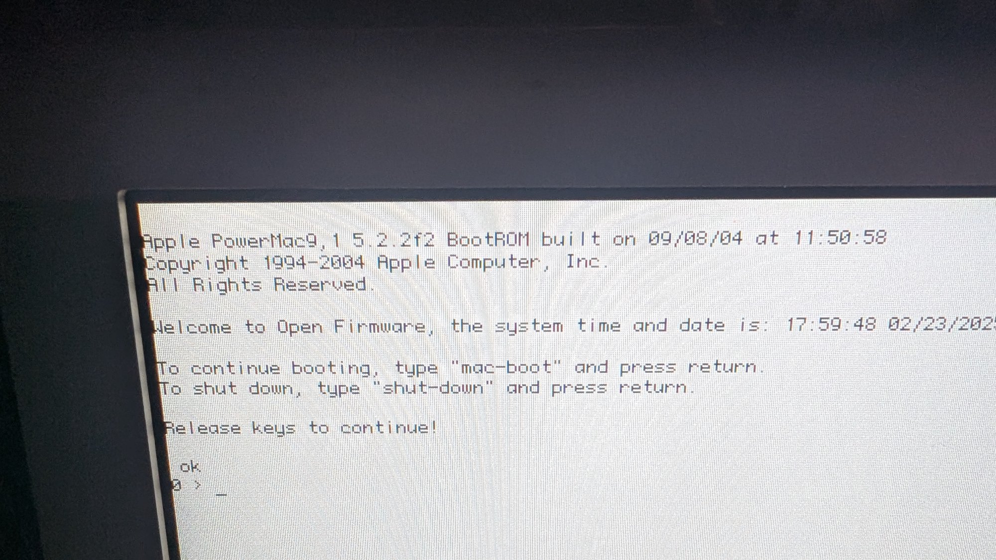

Hi @joevt
Thanks for the response, I have posted the version below I think for OFW.
Would I need a single layer DVD or dual layer for the osx install DVD?

Ah, your post showing the Open Firmware screen tells us exactly which Mac you have, a PowerMac9,1, which is a PowerMac G5 (Late 2004). You won't get 10.2.7 installed on that one. Oldest would be 10.3.5, or some version of 10.4. Your best choice would be Leopard, IMHO. which latest full installer version for that would be Mac OS X 10.5.6, with a simple update to 10.5.8. The disk image for 10.5.6 is more than 7.5GB, so will need a dual-layer DVD to burn to disk.
As joevt said, USB boot and install is, eh, challenging. Booting to Firewire is much more reliable (assuming you have a firewire drive that you can use--very handy on pre-intel Macs...

I don't have that version of Open Firmware. Maybe you can post a copy for examination.
