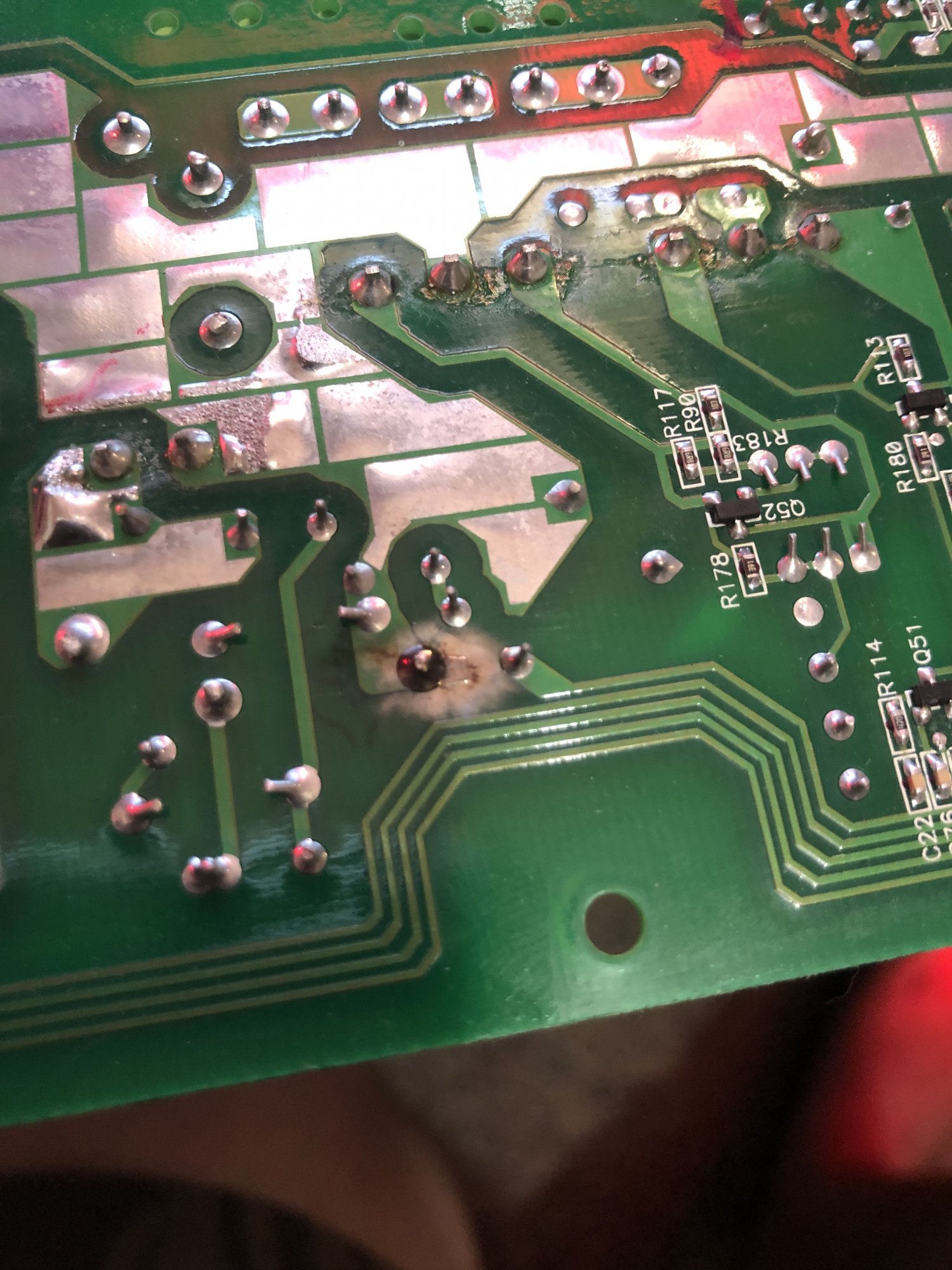

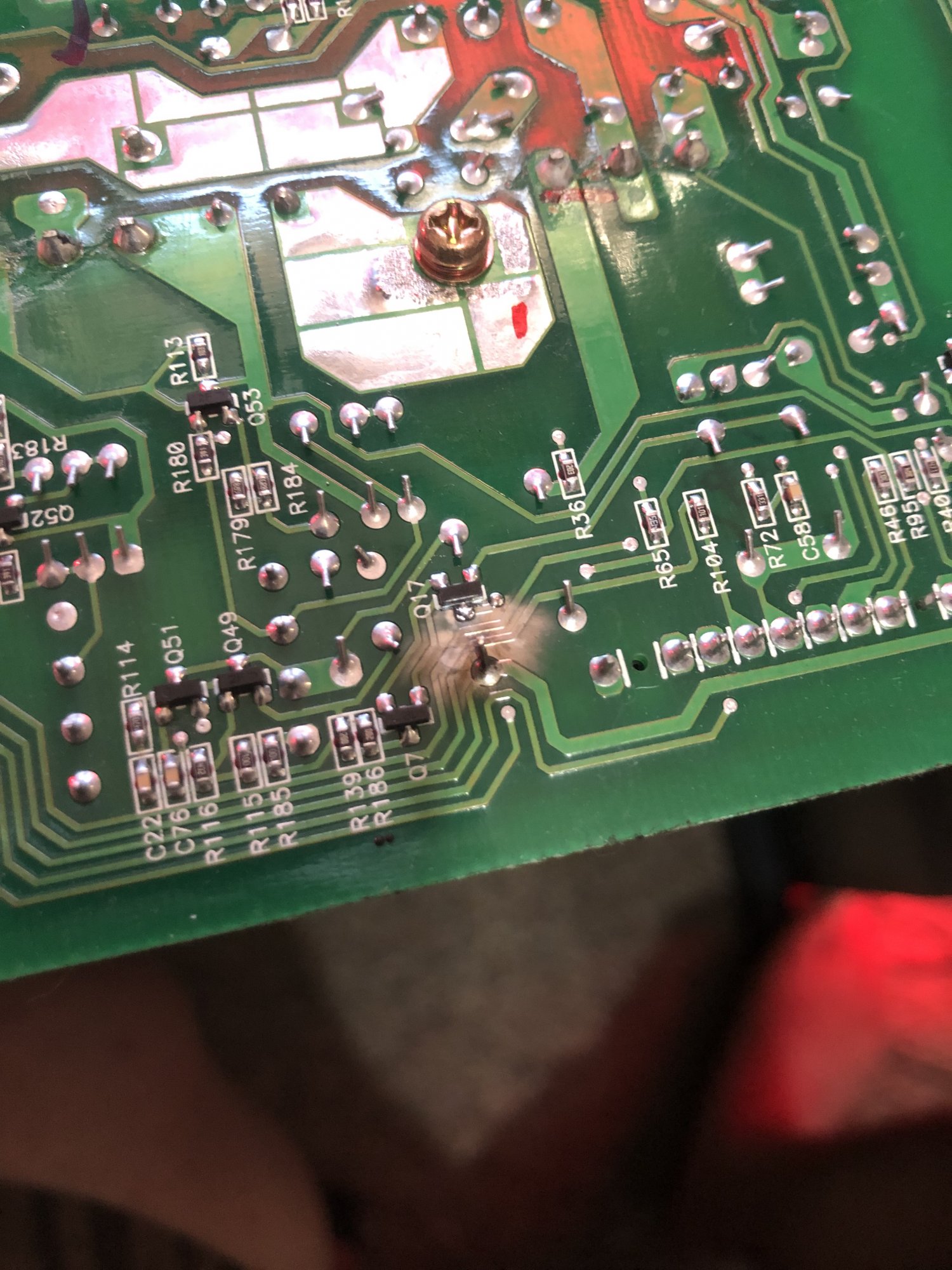

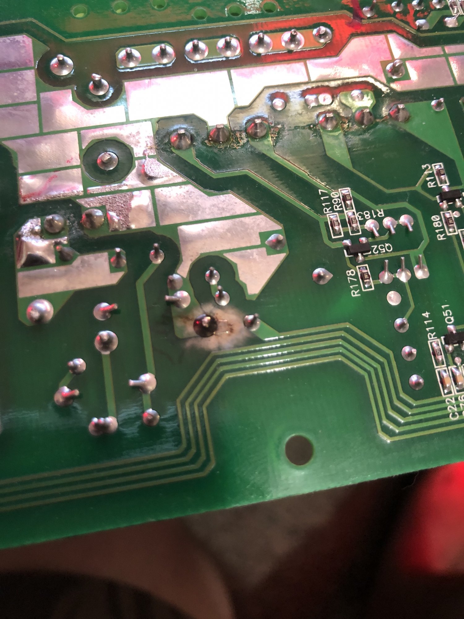

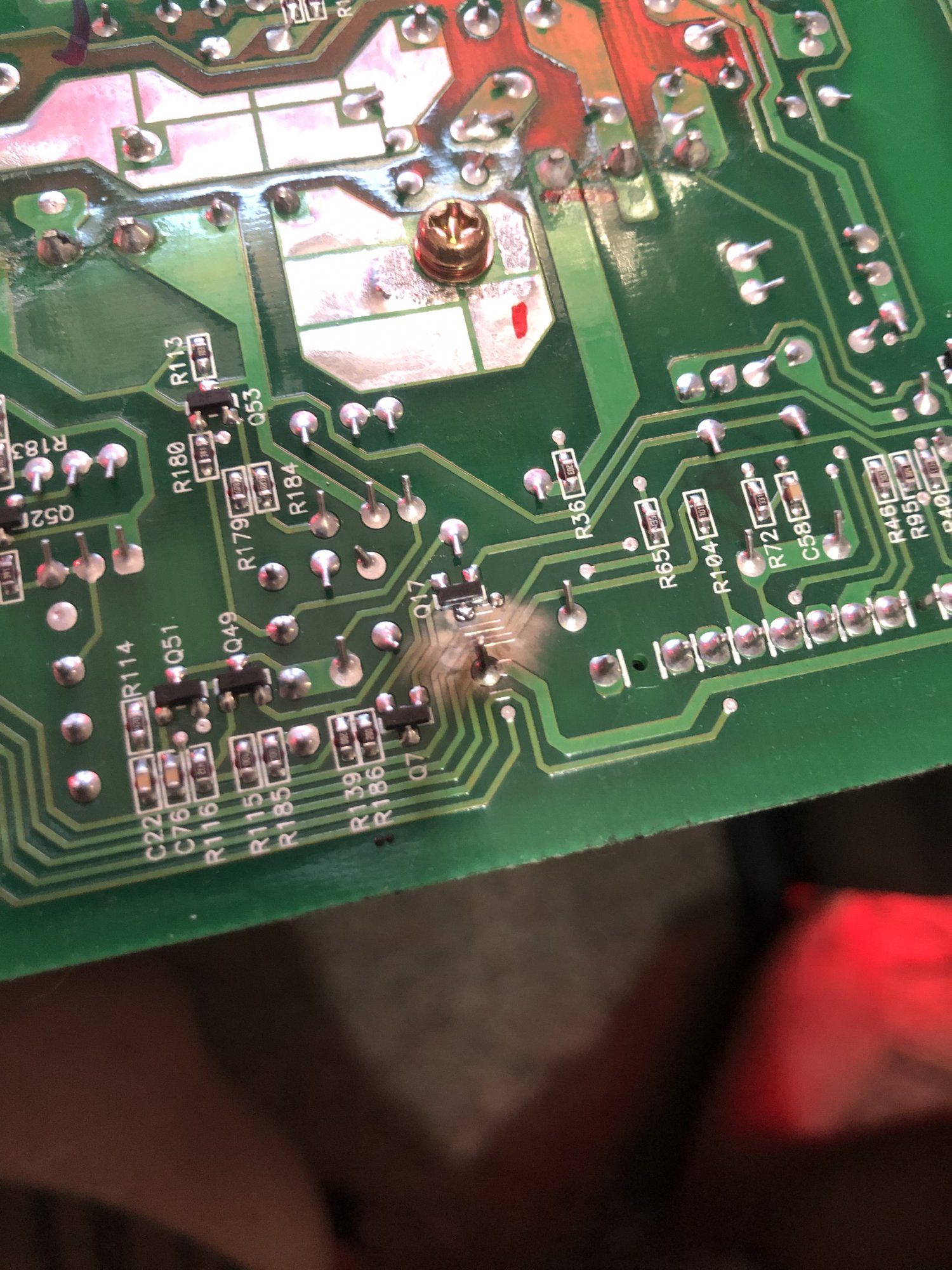

i have the exact same issue but mine clicks even when the psu is out of the machine. when i plug in the power it does it's double click thing and thats it. no startup, no fan no bong. just a dead computer.
fyi, g5 dp 2 with a 5200 nvidia
*edit*
turns out that once i took the actual board out of the psu housing, there are a couple of scorch marks along the traces. so i think this psu is actually dead.
