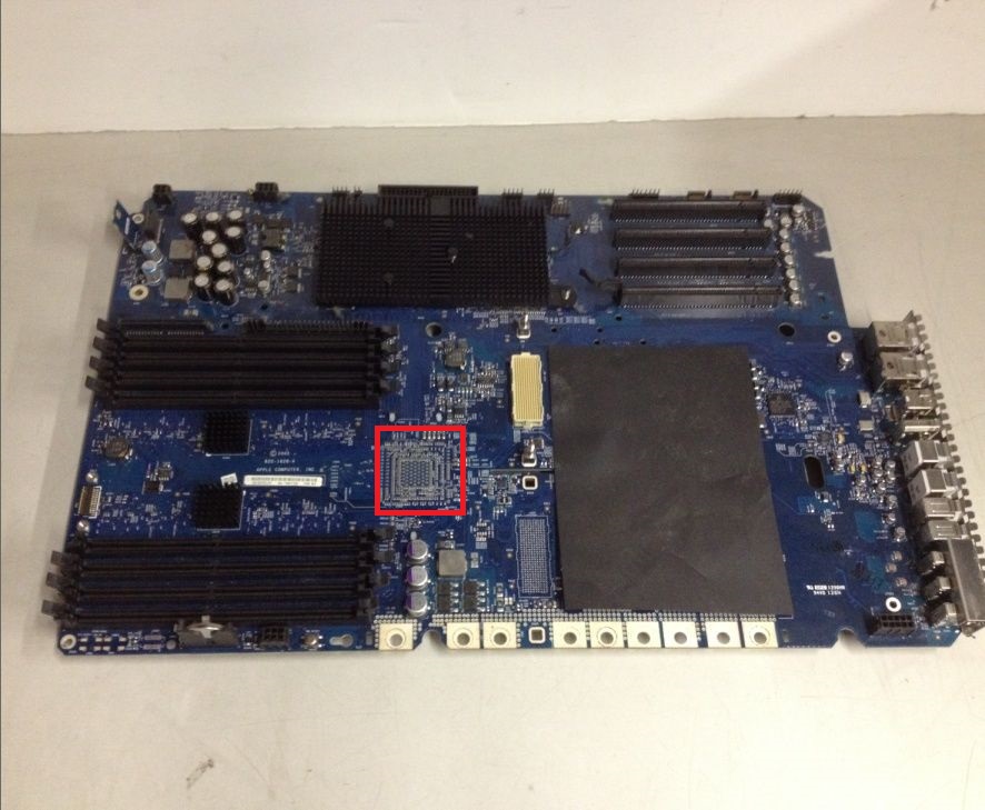

sucks cause I literally got it 2 days ago in working condition
Edit: I read it may be a problem with the logic board or the RAM. Not really sure though
Unfortunately your research is correct, it's a problem with the logic board. To confirm you can try pressing down on the board in the center of the box I've highlighted and it'll probably boot. You can replace the motherboard or attempt one of the "reflow" repairs (heating the area with a heat gun or pulling the motherboard and putting it into an oven) but those are, at best, temporary.
Before you jump to extremes
may I recommend re-seating the existing RAM or trying some other RAM before you pull out the motherboard and try and reflow the chipset?
because 3 beeps is No RAM passes POST
and yes while it is a symptom of a failing memory controller on a G5, you could also just have bad RAM
I second this G5s are also very picky about RAM.
