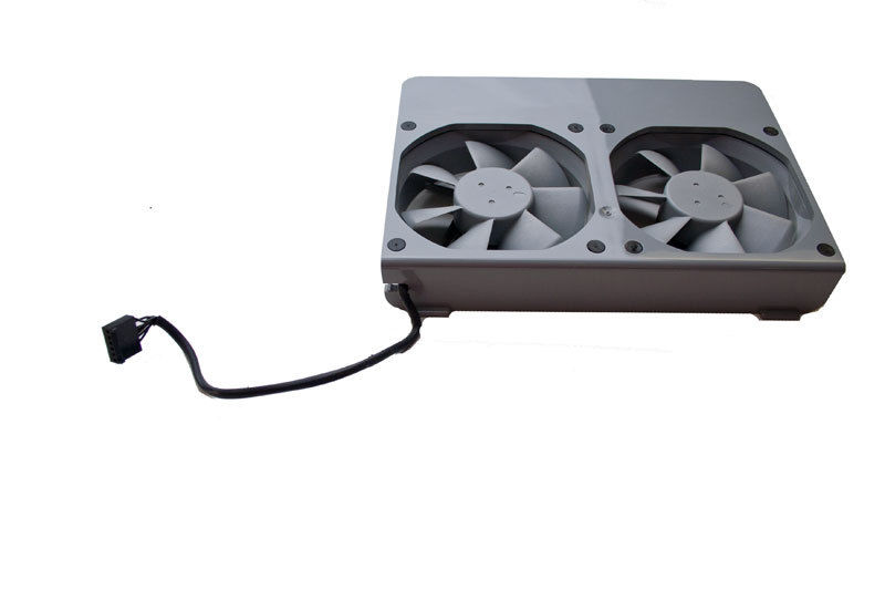

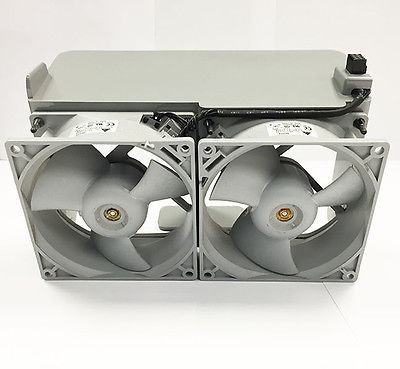

Some fans have 3 large blades, while other fans have more smaller blades which looks like a typical fan. Why is that? Is it any better? How does it compare to typical fans in noise, airflow, power consumption, efficiency, etc?

The three bladed fan is for in front of the CPU, the multi-bladed fan is for after the heatsink.
They are different because they need to move the same amount of air, but have different space allotments and they both must be as quite as possible.
I see... so is the 3 blade fan better than the typical fan or is not as good? I never saw such a design anywhere else (for that size) so it doesn't seem to be as good.

It looks like the 3 blade fans could be replaced by regular and quieter PC fans (with modification of the fans) assuming you can get a PC fan in the same size.
That would not be recommended. Those fans are specially designed for the G5. Using different fans would inhibit the cooling abilities of the system.

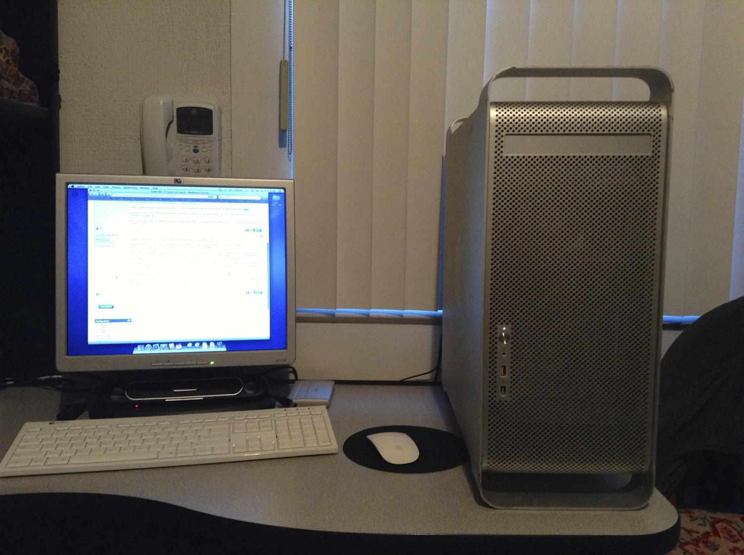

Have you ever used a G5?
I have the front of one sitting about a foot and a half from my left ear as I type this.
I have the same setup on my desk, main difference is, my "man-cave" is very quiet and still my G5 quad with its 10 fans does not make enough noise under normal use to bother me at all.

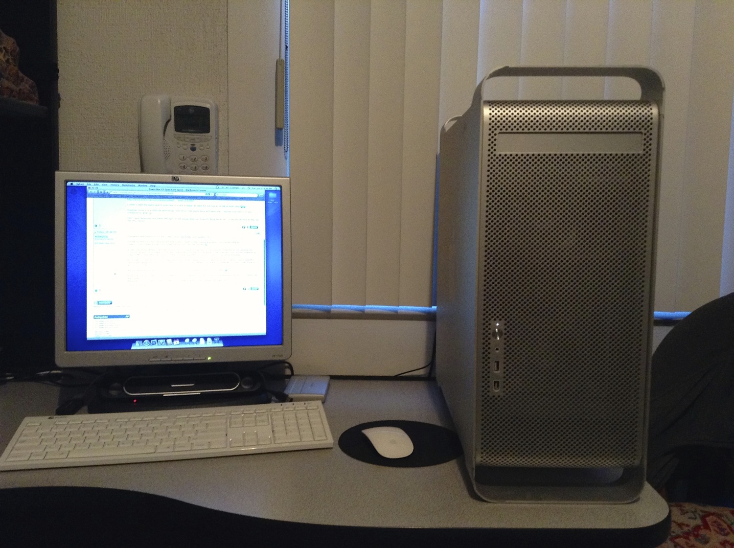

The fans just aren't that loud in normal use. Granted I'm working in a lab with a lot of background noise due to ventilation(our HVAC system does a complete air change in the room roughly every 3 minutes) but I hear them unless I'm listening for me. The only time they get loud is if you're really crunching on it hard and heating up the processors, or if you spend a lot of time in Open Firmware, Apple Hardware Test, or some mode like that where the computer doesn't control the fans and just runs them at full blast.
