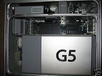

The side logo with the white border is not a sticker, is it, Orange SVTguy as in this photo? Or is it?
