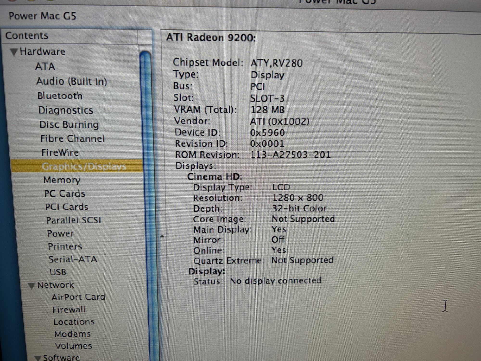

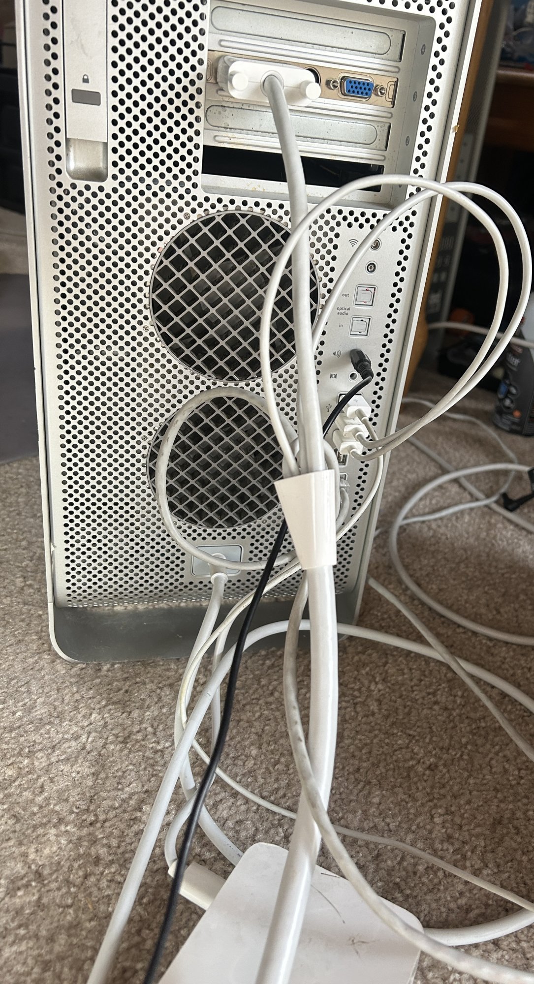

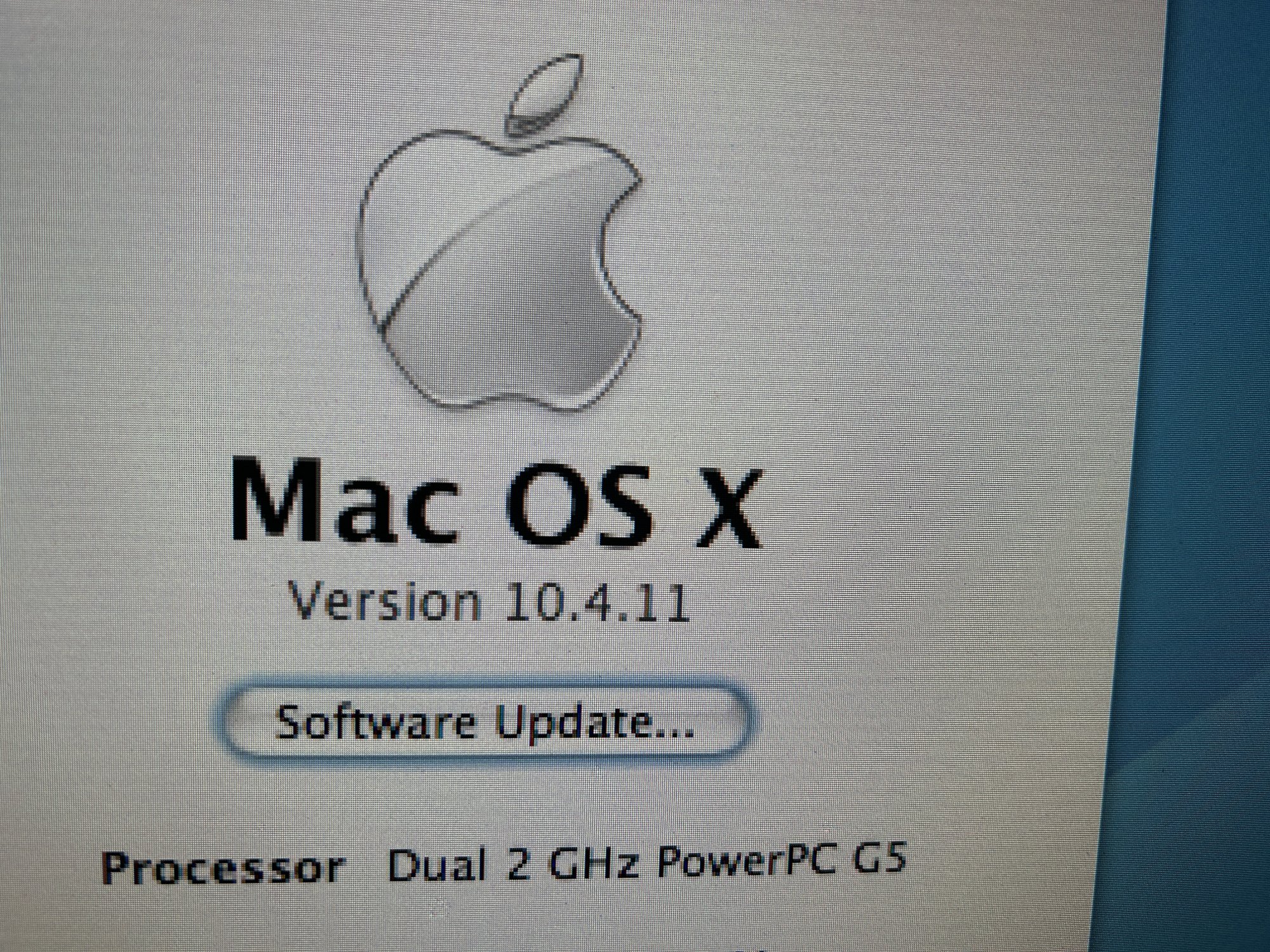

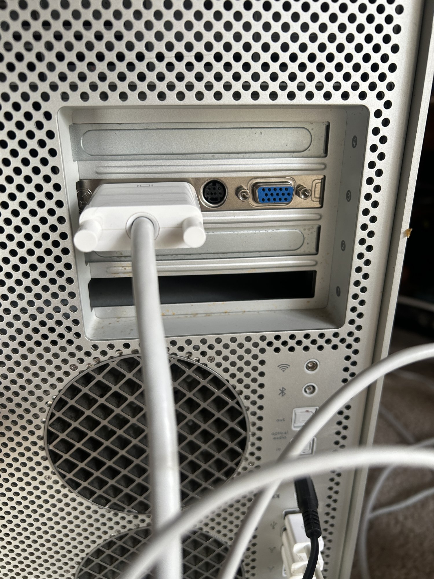

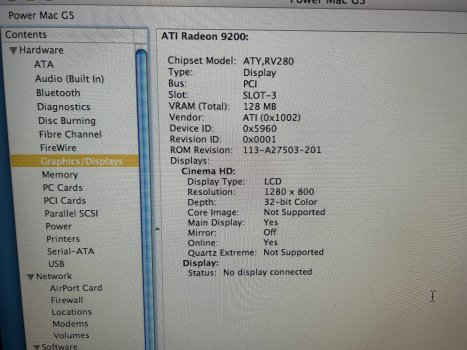

I had been running Tiger OS X 10.4.11 for a long time - very stable for my Classic OS 9 apps. About a week ago, my logic board died so I ended up buying off FB a PowerMac G5 (7,3) with 8GB RAM, Dual 2.0 GHz 970 CPUs, and an ATI Radeon 9200 128MB PCI card. I swapped my 250GB SSD drive and the new G5 booted up with no issues EXCEPT that I can only get 1200 x 800 resolution. I thought maybe it was an issue with the card itself, so I put the original NVIDIA GeForce FX 5200 64MB AGP card. With either card, I can only get 1200 x 800 resolution.
My understanding is that both of these cards support dual link DVI display.
I'm using a 30" CinemaDisplay with the original "W" cord (DVI, USB, Firewire) that came with it, so I'm not sure what's going on? Hopefully someone can help me.
TIA...JP

Neither of them do.
Thanks! I could've sworn that they did but obviously I must be wrong (dang AI ! 🙄). Which one would you recommend that doesn't break the bank? I'm mainly using it for Photoshop as I still have an original Adobe CS license!
ATI Radeon 9650 XT (one single-link, one dual-link DVI)
NVIDIA GeForce 6800 GT DDL (two dual-link DVI)
NVIDIA GeForce 6800 Ultra DDL (two dual-link DVI)
Best regards...JP

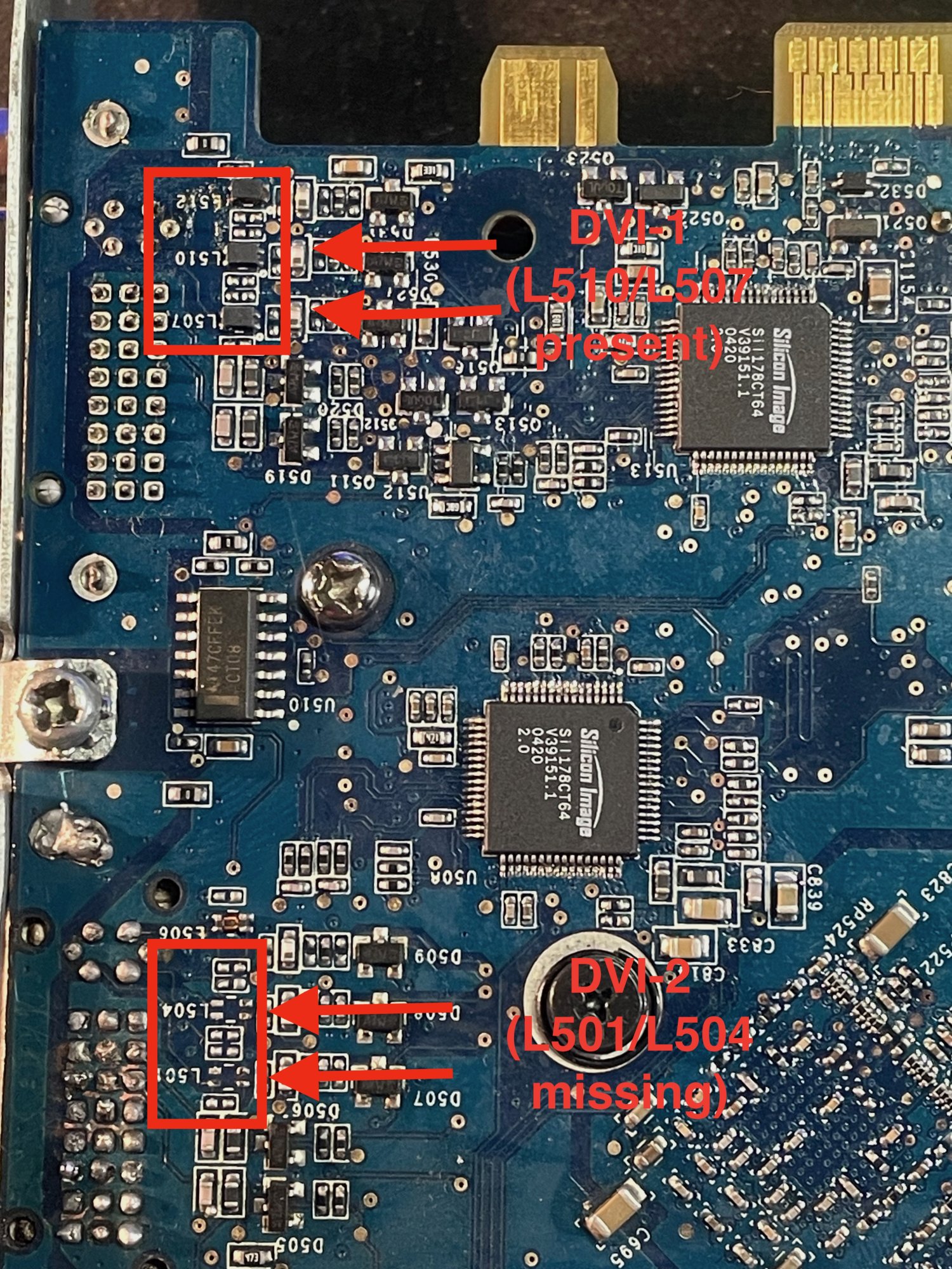

Thanks! I got lucky a couple of weeks ago while looking in FB marketplace. A seller had a damaged G5 for parts - it appears someone had dropped it, and cracked both the plastic cover and side panel. In addition, it had corrosion related to being an LCS 2.5 GHz - one of the CPUs is shot. BUT to my surprise, it came with an NVIDIA GeForce 6800 Ultra DDL GPU INCLUDED!! And best of all, he sold me the entire G5 for $25!!
That said, the GPU card had some damage - some of the caps were missing. I am not sure if it was caused by the drop or some other issue. I ordered the missing caps from DigiKey and did some soldering over this past weekend.

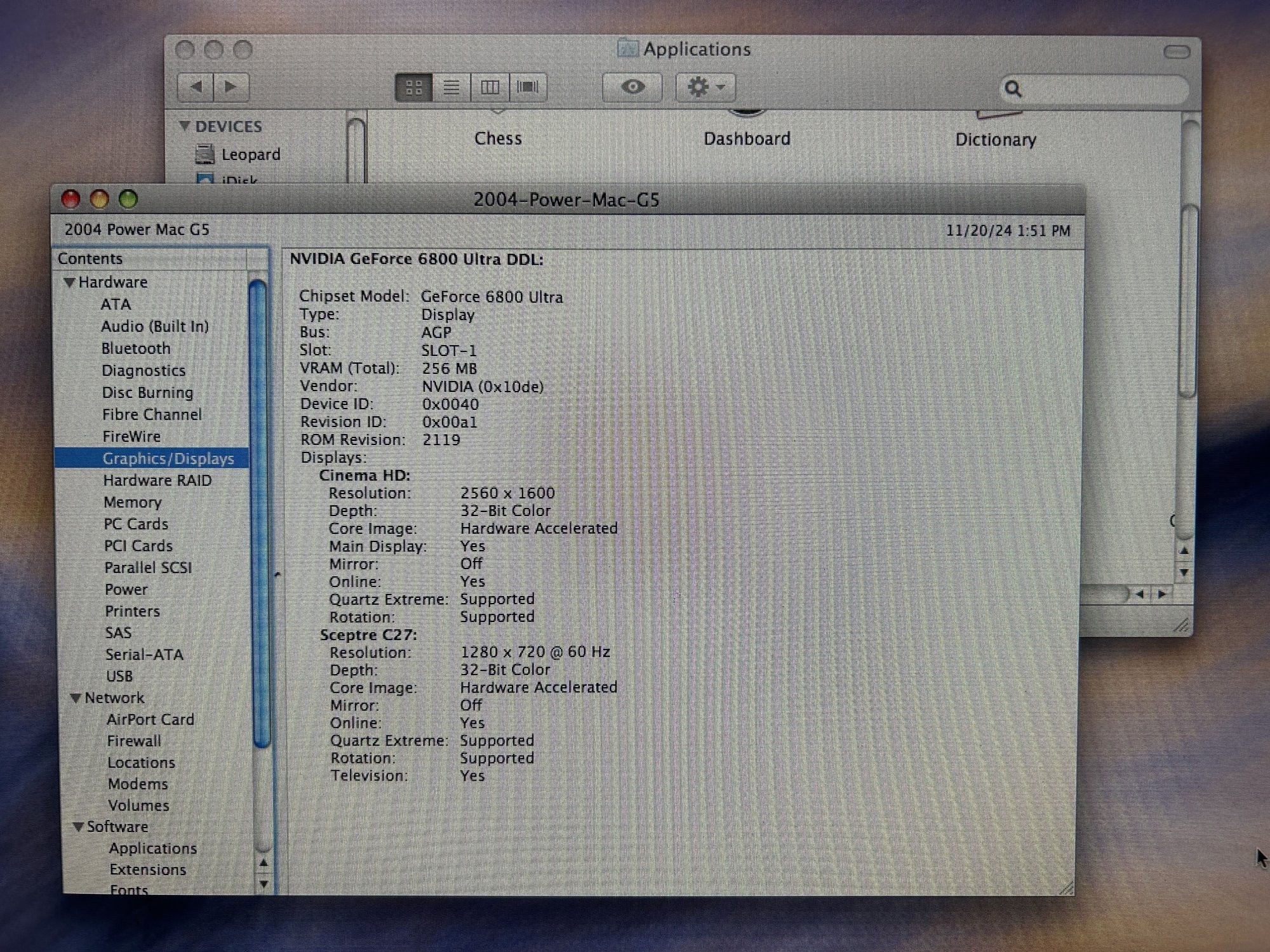

Finally, I had a chance to fire it up last night. I am able to get full 2560 x 1600 resolution!! Woohoo I'm stoked!!

Thanks! My G5 definitely runs loud with all the fans, including the one from the 6800 Ultra. Because the 6800 Ultra was damaged, I noticed that there are some issues rendering out of the DVI-2 port with certain resolutions/refresh rates. Upon closer inspection, I noticed that there are two 'L' inductors L501 and L504 missing on that port (see picture). I'm wondering what the values are because there are no markings on the corresponding inductors on DVI-1.
