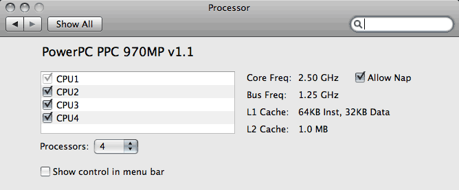

Isn't this as easy as unchecking as many cores as you want in the processors control panel, which was, as far as i remember, part of the developer/x-tools kit, included in the OS-discs? (picture attached)
And what it saves you should be easy to measure with something like that.
Just tried the simple task of unchecking two of the cores of my quad and this seems to work. I ran a quick render test with cinebench 10 and the two deactivated cores stayed cool while the other two heated up and also the resulting score was only half of what i had with all 4 cores running. So at least reducing performance seems to work. 😉
Well this is awesome and didn't realize it was that straightforward! My question to you is, how do I get tho that control panel for the CPUs because I have the developer tools installed and not seeing that at all.
Just go to spotlight and search "processor" and install the prefpane

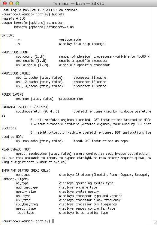

Is there a way to make this more permanent? As in, can I keep the other 2 CPUs off instead of having to turn them off each time I restart the machine?
Check out the included command line tool called "hwprefs", enter that title into a Terminal window and you'll see that you can enable-disable CPU's and a whole lot more.
Reactions: RedCroissant
Well, this is awesome! I have only 2 cores enabled and the performance is completely fine for all of my daily tasks. The machine doesn't heat up nearly as much and the performance difference between the G5 and the powerbook is pretty drastic.
