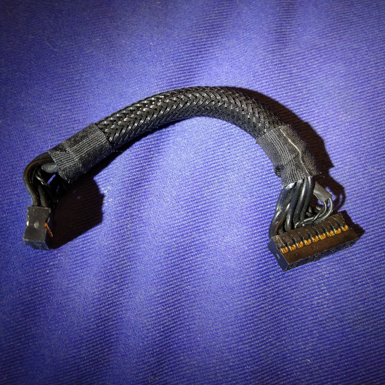

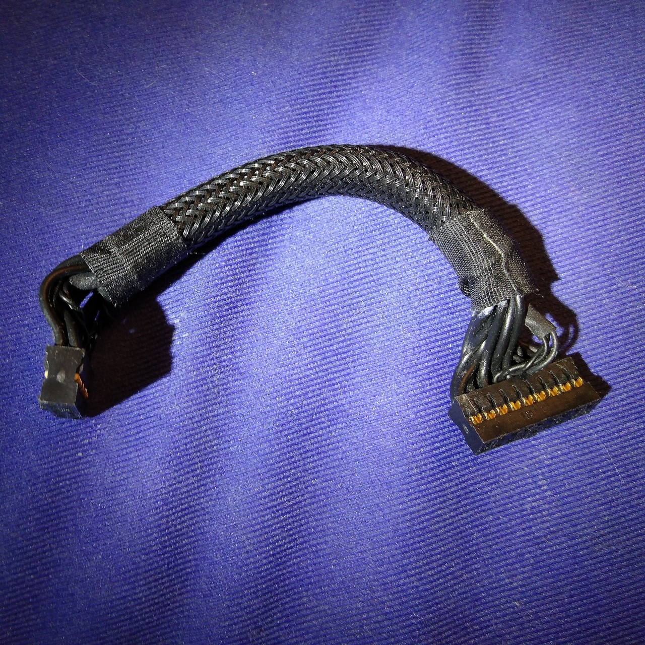

I took out and checked the front PSU/board cable (attached) with a multimeter to test for bad connections on each of the 18 pins. All appeared to be fine.
I have since put that cable back in, and the outcome is the same.
As you may have noticed when you took apart your system, there’s a black plastic cap covering the board plug on the board side, which for me was very challenging (annoying) to remove. In trying to remove it, I have the hypothesis, still untested, that I damaged the solder points where the plug receptacle meets the logic board.
Once I know what to test for with the multimeter/what to expect from each pin test, I will try to check each of those solder points (I’m not an electrical engineer, so it would be wonderful if someone who knows that stuff or has board schematics to guide them can direct us on how to set the multimeter, where to place the probes (i.e., what is proper ground), and what values one should expect with what test).
If it turns out to be damaged solder points, I may or may not take apart the system again to repair the board and fix the solder. The system is again running, but now without a working front board. So long as I can use an external source (like the ADC, or a fruit-era/Sawtooth-era Apple keyboard with the power button included) to power up and shut down the system, I will live without the front board.
tl;dr: The front board connector may have been damaged during disassembly. As you put gentle pressure on the front cable down onto the receptacle, press and re-press (not hold) the power button to trigger a power-on. If this is successful, then it’s possible the board was damaged during disassembly (cracked solder would be my hypothesis).

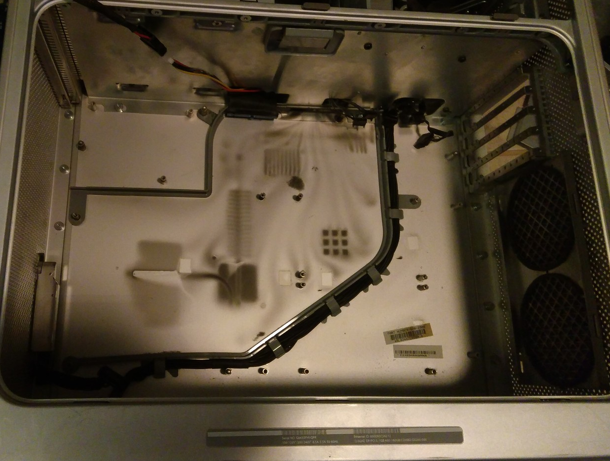

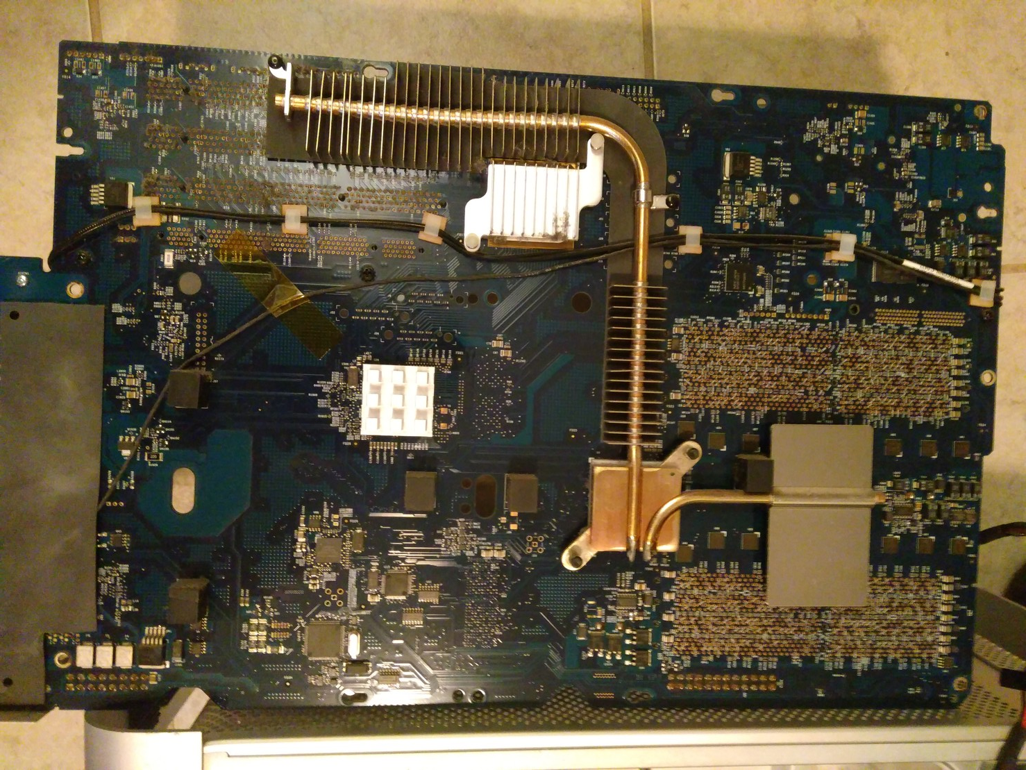

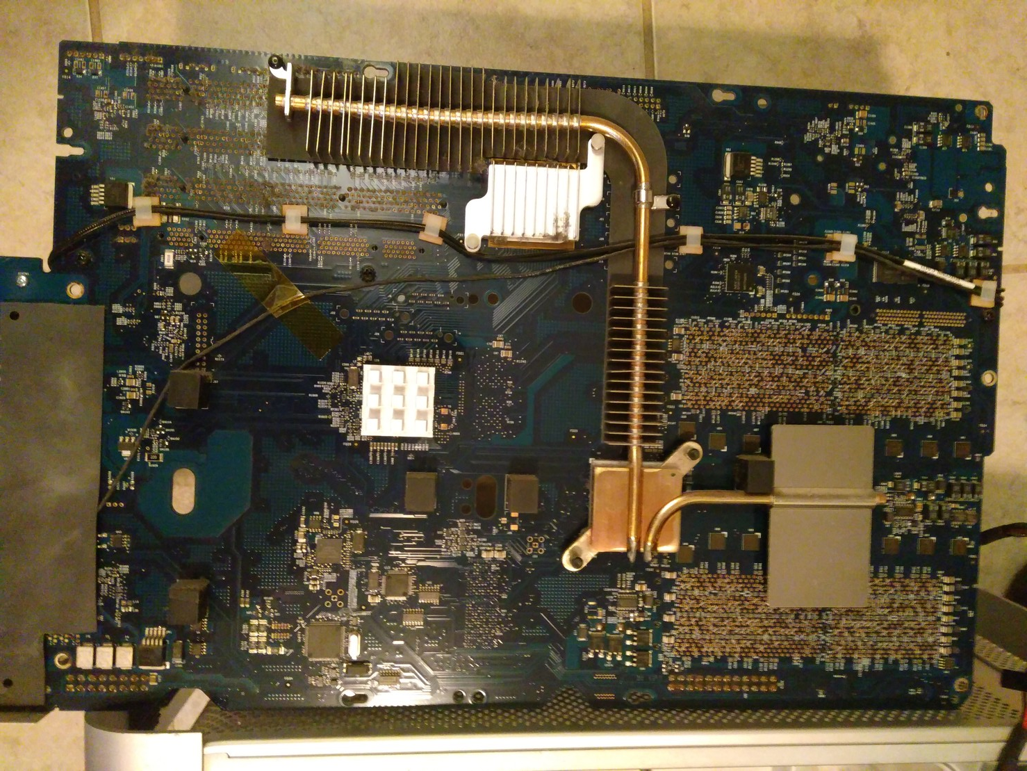

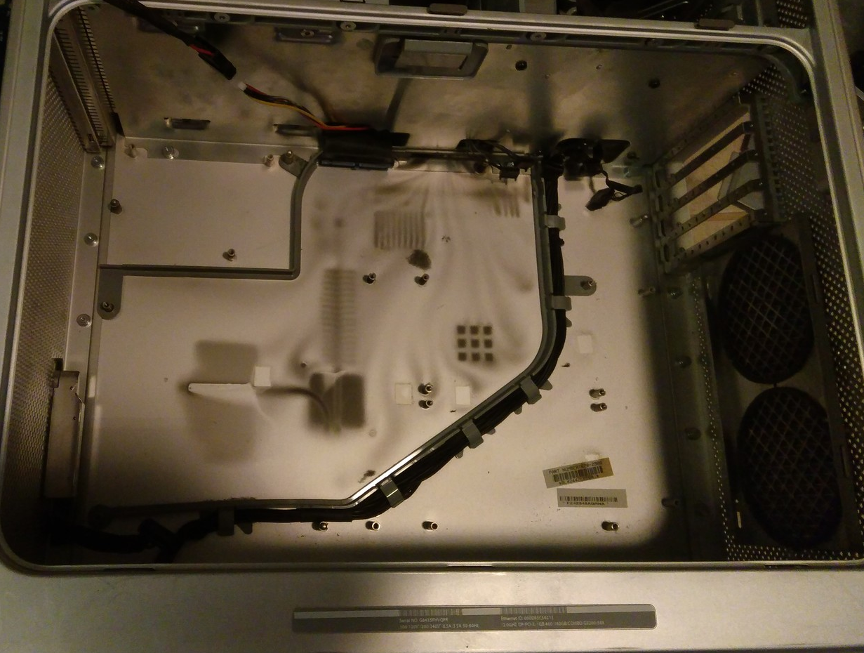

Attached is what the backside wall looked like in my G5 when I took out the logic board last month to conduct a full clean-out and new paste everywhere. I assume the first two owners kept the tower at or near the floor (which, given its weight, is a conservative assumption). In the seven years I’ve used it, I’ve kept the tower about 1.5m above the floor. As you can see, there’s a ghostly mirror image of the logic board backside where the microfine dust of over 16 years aggregated.
I dont have no prblem with the backside, because i have replaced the internals from a from a second G5 (my board was damaged for years and my case was in a much better condition.
The "new" board was in a perfect condition with nearly no dust. The rest was cleaned and controlled before build in.
