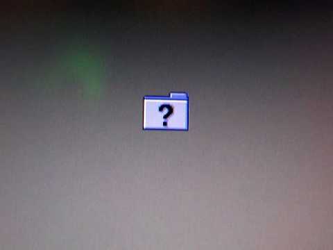

Is this what you're seeing?
If so, this means that the Mac cannot find a system folder to boot from. THAT could mean a few things.
It could mean the hard drive is bad, it could mean there is no hard drive. It could mean that there is no system installed on the hard drive, or that the system was wiped from the hard drive. It could also mean that the system was installed improperly.
Did you just get this Mac?
PS, Apple does not use 'CMOS'. The semi-equivalent would be Open Firmware, which is a really a base level OS all it's own, not CMOS or BIOS. I am going to assume you meant you reset the PRAM (Parameter RAM).
no i have the white power led blinking, the machine does not pass the post and does not chime and does not display.
the fan thermal control seem to work since as i leave it on for some time fan speed increases slightly
also it does sense if the air guide is removed so at least some part sould work
the hdd is present and should have a mac os install but im not sure.
the blinking doesnt match any blink codes for it since it doesnt stop
