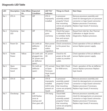

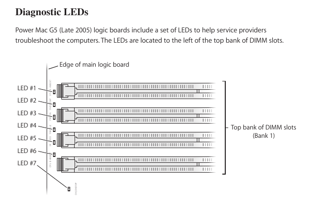

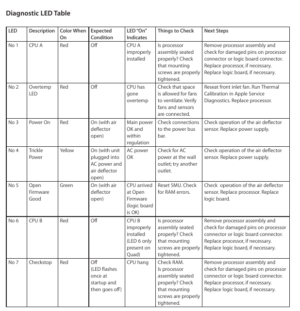

I should probably elaborate on this:
On the inside of the Late '05 G5s, including the Quad, there are a series of LEDs on the logic board on the front edge next to the upper deck of RAM.
Here's a table for what each LED indicates. If you have no lights, take off the air deflector (the big plastic piece) and take another look. If all of the LEDs match "expected condition", then at minimum your processors are alive and you can reasonably rule them out, at least for now.
