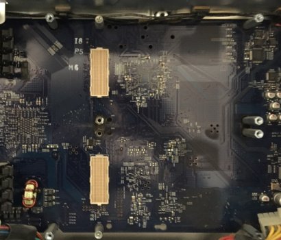

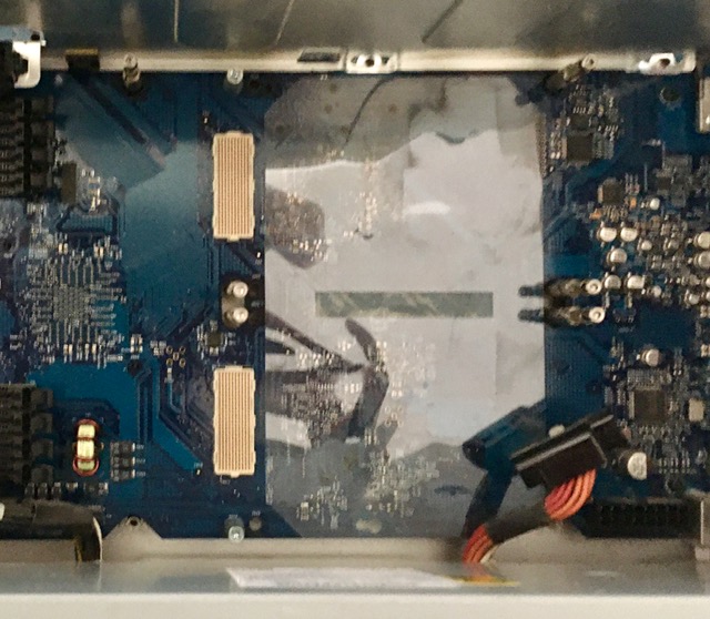

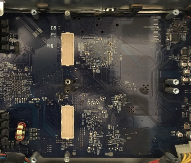

Today i only removed all components from each Powermac G5 and i observed that the old CPU from 2003 has 4 phillips screw while the 2005 G5 has 6 hex screw
I’m sorry. I wrongly assumed that both duals 1.8 (PCI and PCI-X) where of the same generation.
They are both Pci-X. The position of the mounting holes on both motherboards are the same. But the holes on the 2005 cpus are bigger, because the hex screws remain in place after the cpu is removed.
Here are 2 photos of the logic boards:
2003 and early 2005
Are the holes in the case the same size? Will you be able to install your dual 2.3 motherboard in the 1.8 case using the dual 2.3 mounting screws?
Hi, yes the holes in the case are the same size.
Today i was able to finish the job using 2.3Ghz mounting screws (need Exagonal key 2,5mm).
Then i turn on the Powermac g5 and i was happy to see that it boots perfectly.
