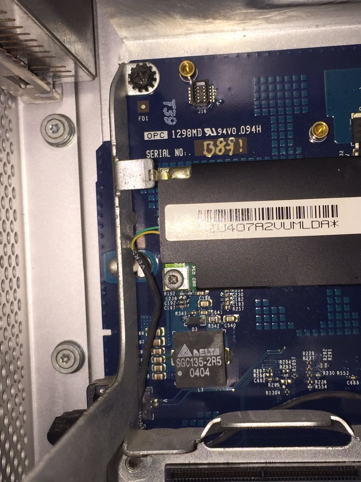

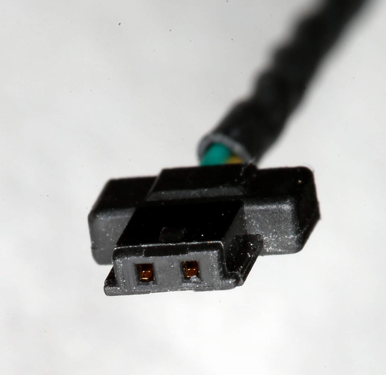

Question: There's a very small plug wire which comes off the system board and goes near the (I assume) Bluetooth board. I was unable to find any connection point so I ended up leaving it disconnected. I took photos of the system for reference but must have missed this wire. Any ideas?

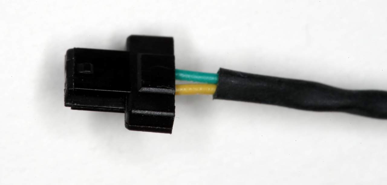

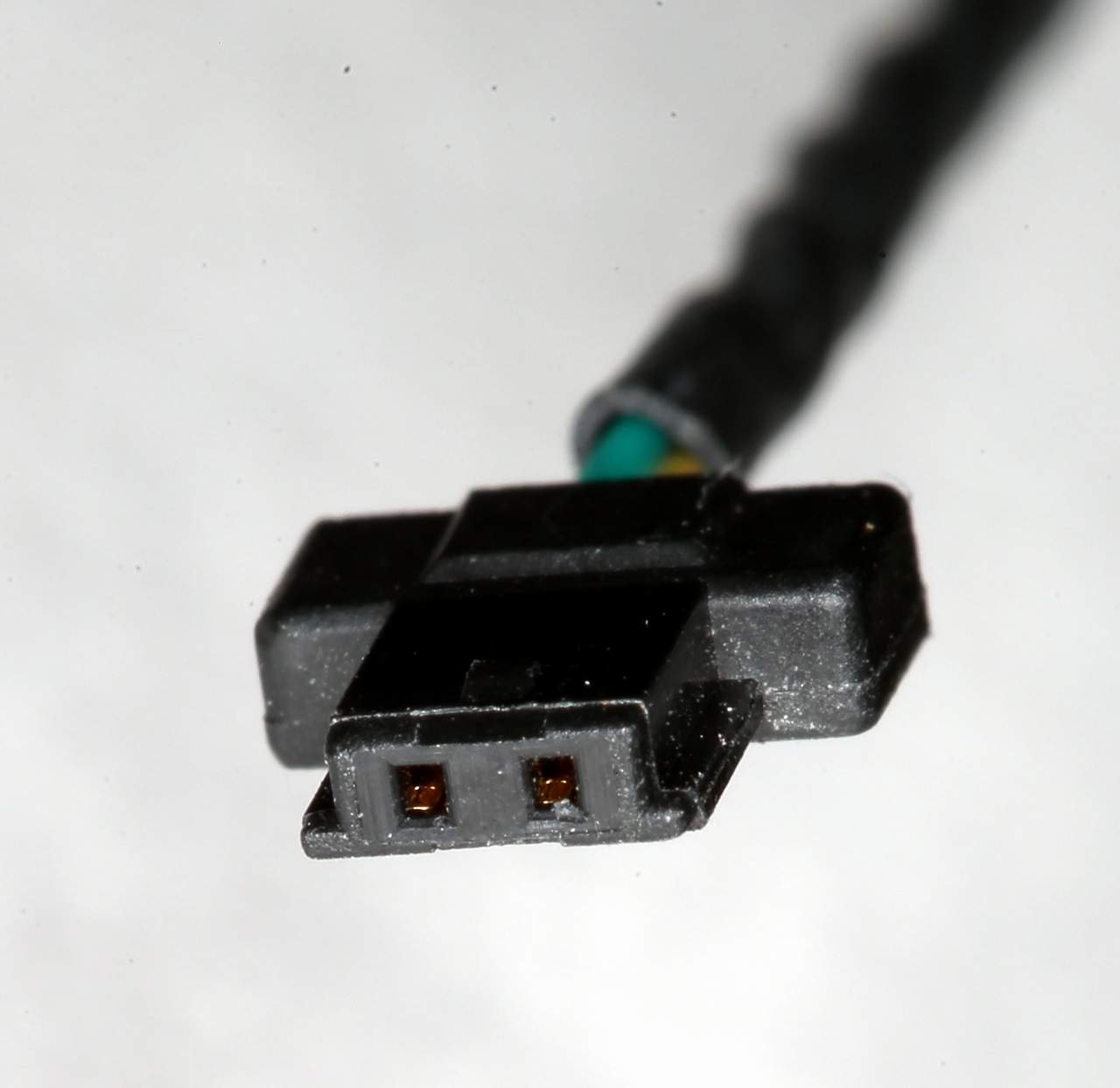

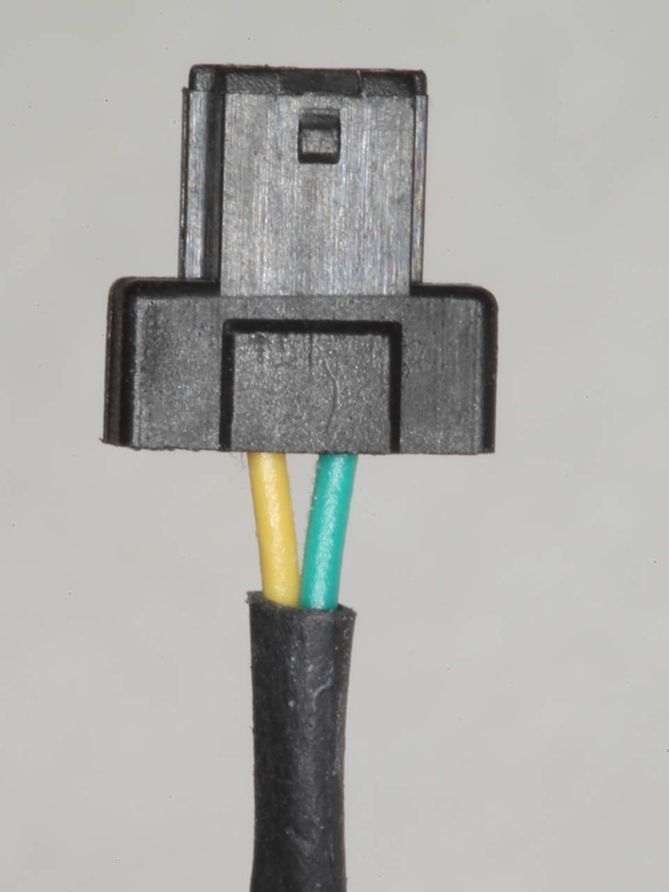

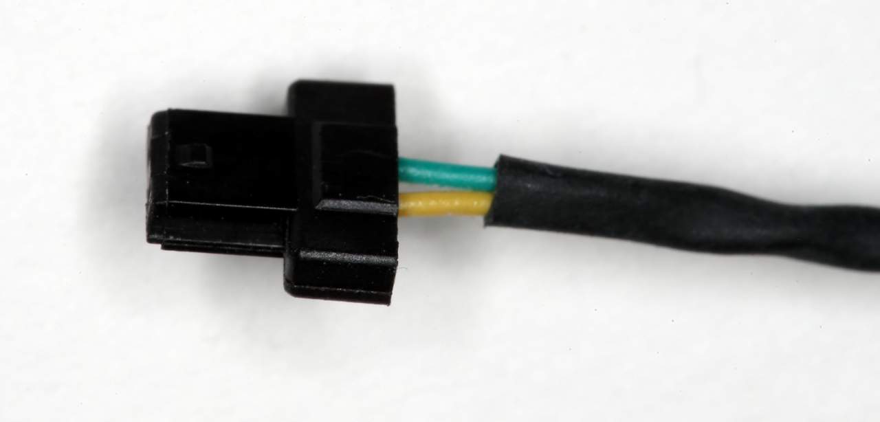

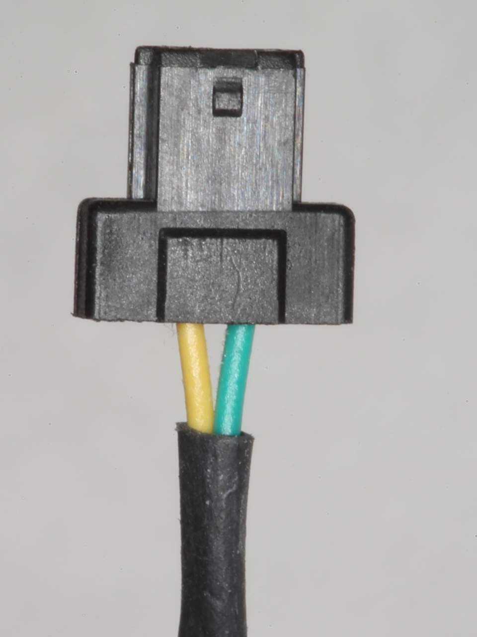

Can you post a photo of the connector and its location?
Here you go. This wire comes up on the memory slot side of the system board along with the AirPort Extreme and Bluetooth (I think the small board in the upper corner of the system board is the Bluetooth module) wires (this wire is not either one of those). It runs along the backside of the system board and terminates underneath a black paper cover near the lower portion of the I/O connectors (i.e. near the ethernet connector).
View attachment 884871View attachment 884870
Nice work. That looks to be the modem filter cable which connects into the modem board, which is the small board on standoffs behind the speaker fan assembly. The cable pushes into the side of the modem board toward the front of the case, behind the thin black plastic shielding.
Unfortunately, I don’t believe this will have any impact on the booting of the Mac.
