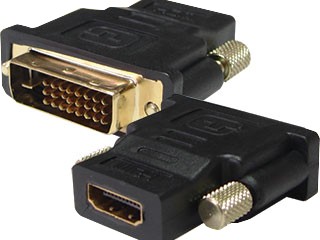

One of these?
I use one to connect my PowerBook and MBP to my TV.
DVI to HDMI.
Note that HDMI is essentially DVI with sound, which is why this works. But with the adapter you'll have to run an audio cable if you want sound from the HDMI device.

One of these?
DVI to HDMI.
I have one of those, but it only allows me to output in 1920x1080
