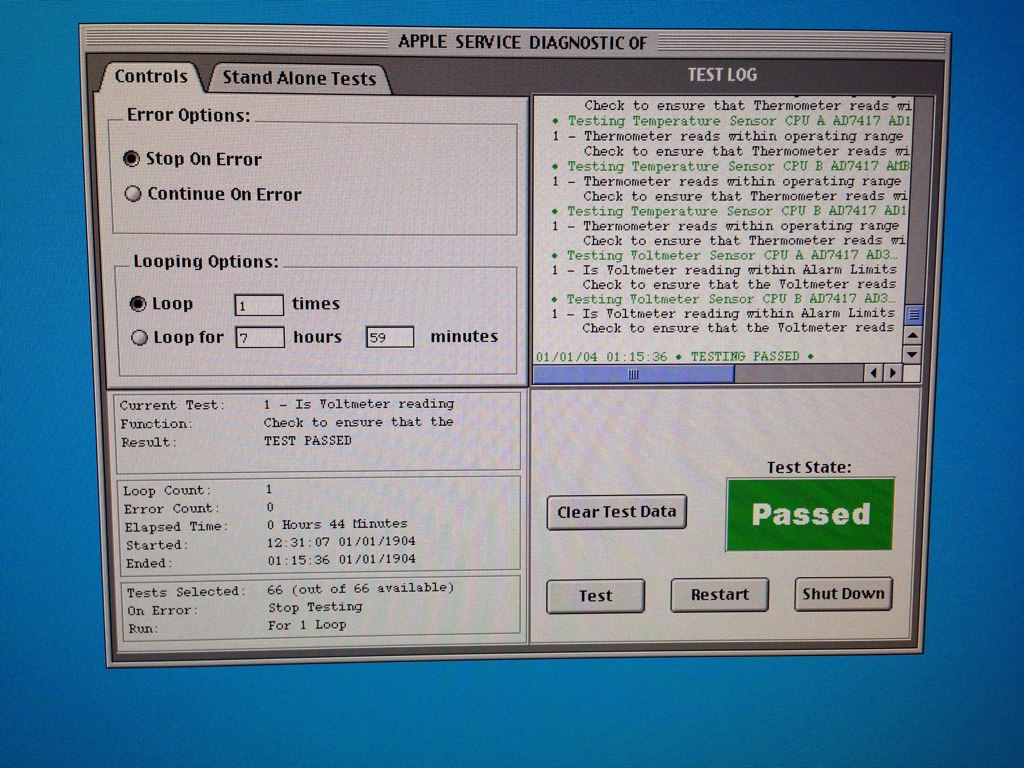

I then tried to load my ASD 2.5.7 (I think) and it was able to load it just fine (still did not hear an apple chime). I am a little weirded out that it says my thermal calibration is good even though both CPU's were removed... But right now I am running a complete system test to check everything out. If this helps I am using a 17" 2003 Apple Studio Display.
Any help would be appreciated! (BTW, I am still kind of new when it comes to working on apple machines. So I have no idea how to reset PRAM and other stuff like that)
So yeah it passed...

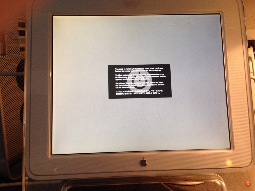

I don't think that will work. First of all, I have a 2.0, and a 1.8 lol. Wish I had a 2.5. Also, I reset the PRAM and I now get the chime when I turn it on. But it still does not want to even attempt to load leopard. When I put the good HDD in with a good clean install of leopard, it starts with the apple logo like always, then this shows up:
I also noticed that when I left it at this screen the fans kept spinning faster and faster. I know that the DVD/CD drive is good because ASD loaded just fine.

Let me explain what is going on here. When a Mac chimes it means it completed Power On Self Test (POST). That is the same thing that a PC does, and the chime is there to alert you that it passed. Back in the old days around 2001 with up to OS X 10.1, Macs used to show a Happy Mac when booting!
Since it is chiming, you know it passed a relatively crude boot up check which essentially says that the Logic Board can communicate with all parts. It may still chime with bad memory banks however, so only critical errors cause it to not chime...
Since your hardware passed, hold CMD V at boot up and let us know where it hangs when starting Leopard. A picture of the read out would do wonders in us helping you here!
The reason that the fans get louder and louder is that they are controlled by a computer which monitors the temperature. OS X has a driver (also called a kext) which allows it to control the fans. When this driver is not loaded (e.g starting up, on a non OS X operating system, in Open Firmware, etc) the Mac doesn't know how hot it is and begins to ramp up the fans to cool it. If you ever pull the clear acrylic air deflector out when it is running, the fans will max out.
