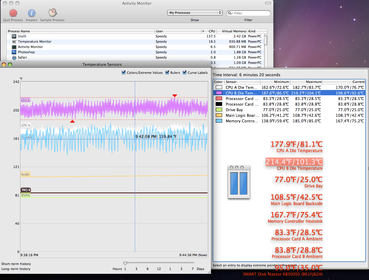

Here are some screen shots of my recently repaired Dual 2.5.
One shot is when the machine is under load (Photo with no text added) and when the machine is at idle.
I have a full thread on my LCS Repair, which talks some about CPU temps, but is mostly about the repair its self. You might find it useful.

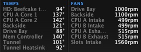

Mine stays around 128 fahrenheit.
I thought that was high, but it seems several others on here have temperatures even higher than mine.
